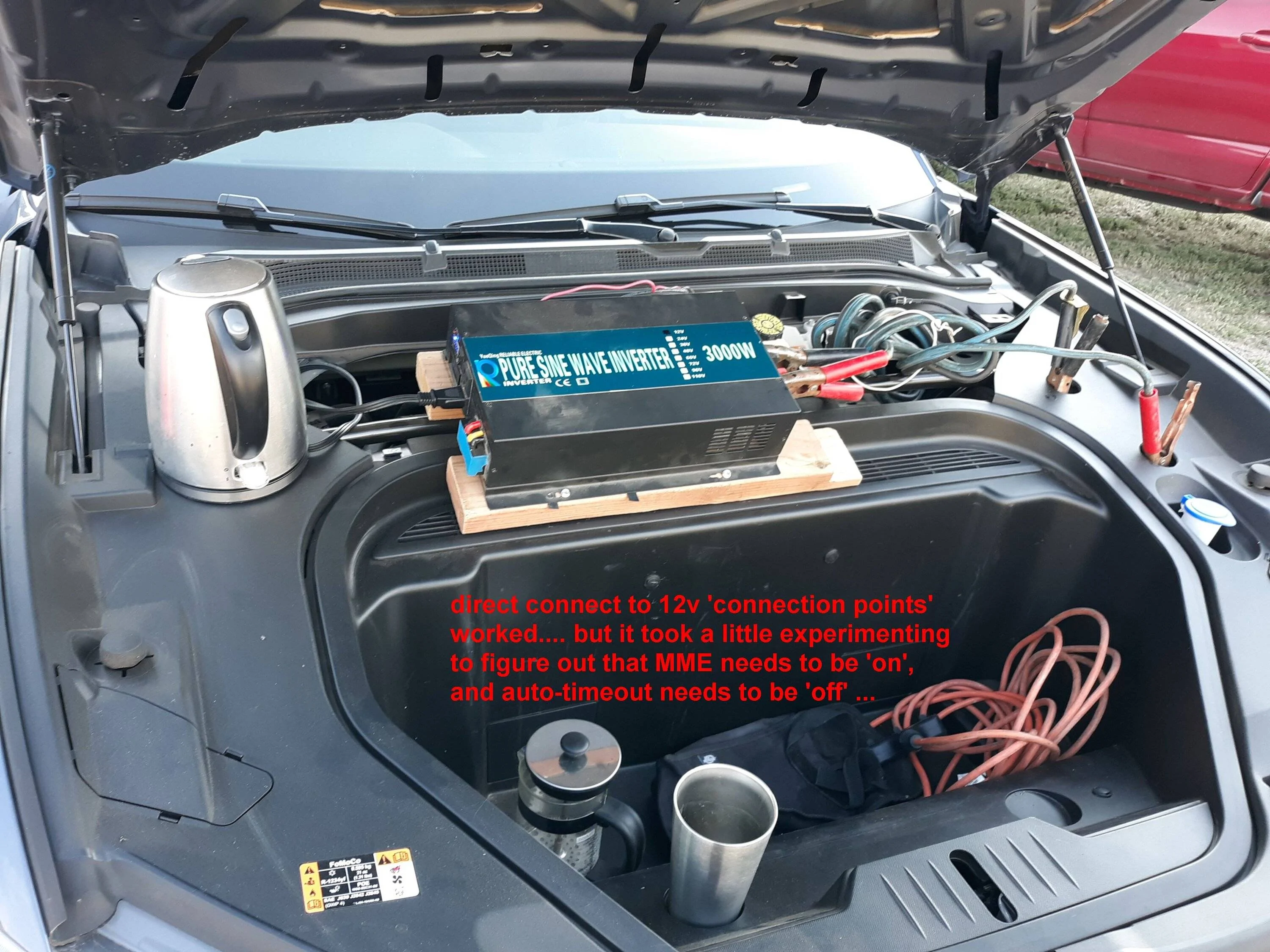

Anyone power a toaster through their MME? If so, how did you do it

You'll have to get a 12 volt inverter with enough wattage to power a toaster. You'll pop the panel off that covers the battery. Use jumper cables to connect the battery to the inverter. Plug your toaster into the inverter.
Your car must be on. A toaster would wreck that battery fast without the car charging it at the same time.
You can't use a 12v socket to power the inverter. A toaster would blow the fuse.
