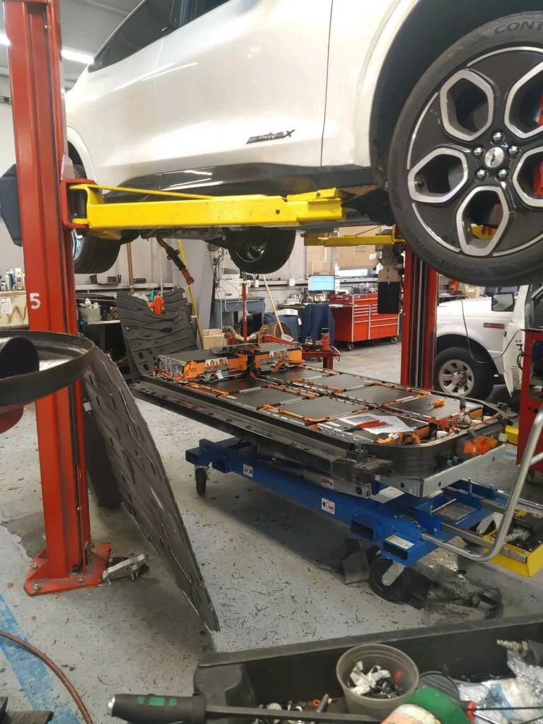

I had same warning pop up April 5th, 2023, for my MME GT (non-performance) with a 5/2/22 build date. It only had 3200 miles on the odometer. I took it to my dealer at AutoNation Ford Margate, Fl, and they knew right away that my high voltage battery junction box needed to be replaced. I think it's a known issue for certain build dates. This is a big-time job. They had to remove the battery by lowering it on a platform while they replaced the HVBJB. The service rep even sent me pics of the MME as it was serviced so I could monitor the progress. The part took three days to arrive at the dealership, but they did provide a rental car for the week it took to get the MME back. I am very pleased with this dealership. No problems since. Perhaps you should take it to another dealer for a second opinion if this happens again.
Ford Mustang Mach-E Powertrain Malfunction Mach E battery repair pic 1 April 7 2023
Ford Mustang Mach-E Powertrain Malfunction Mach E battery repair pic 2 April 7 2023
