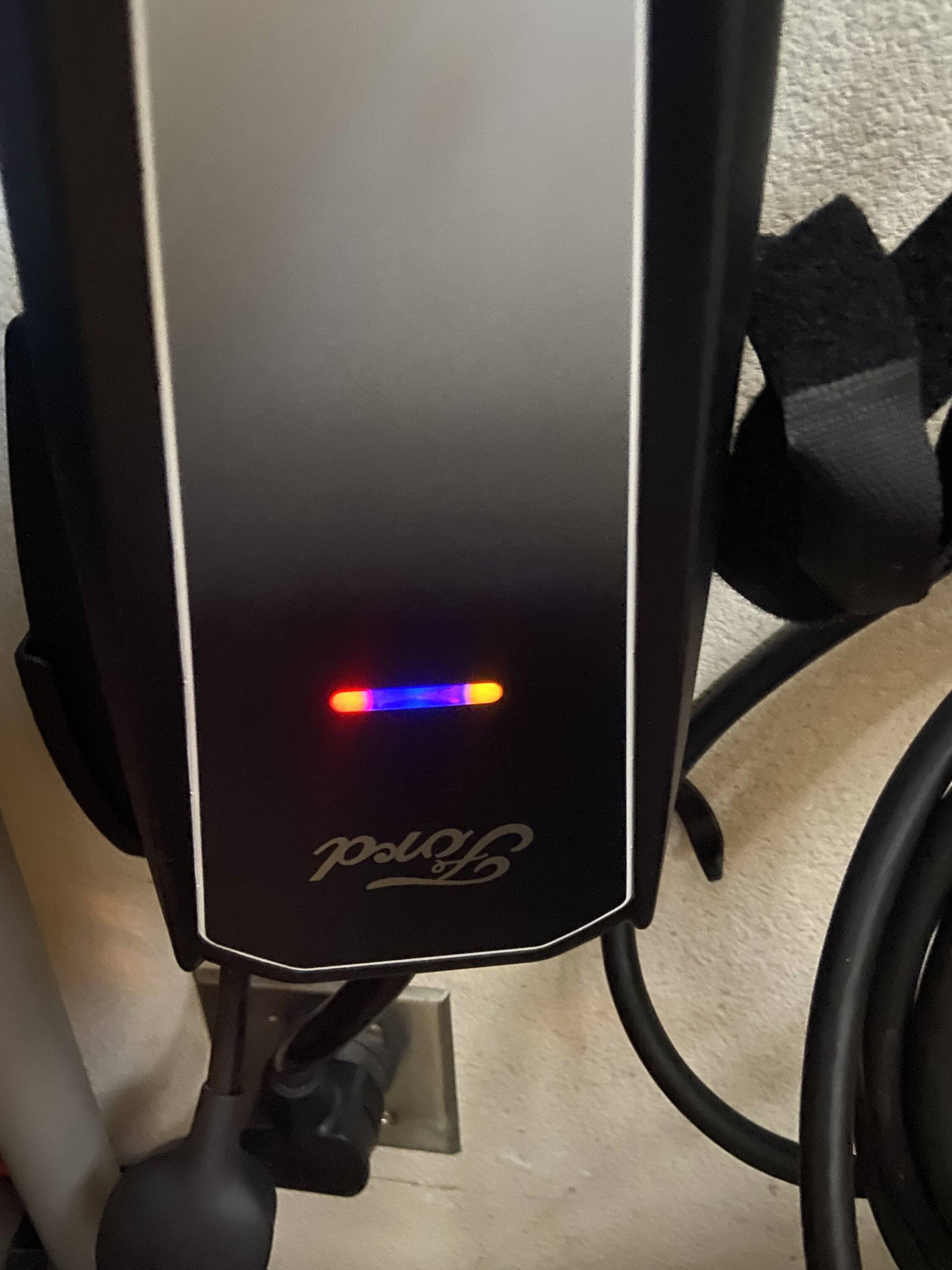

Has anyone’s charger done this??
Stephine
STEPHINE
Oct 20, 2023
2021 Mach E Premium
Executive
I’ve checked all connections, plugged and unplugged several times. Starts off with the blue line then goes multi colored, lasts about a minute, goes back to blue then multicolored again.

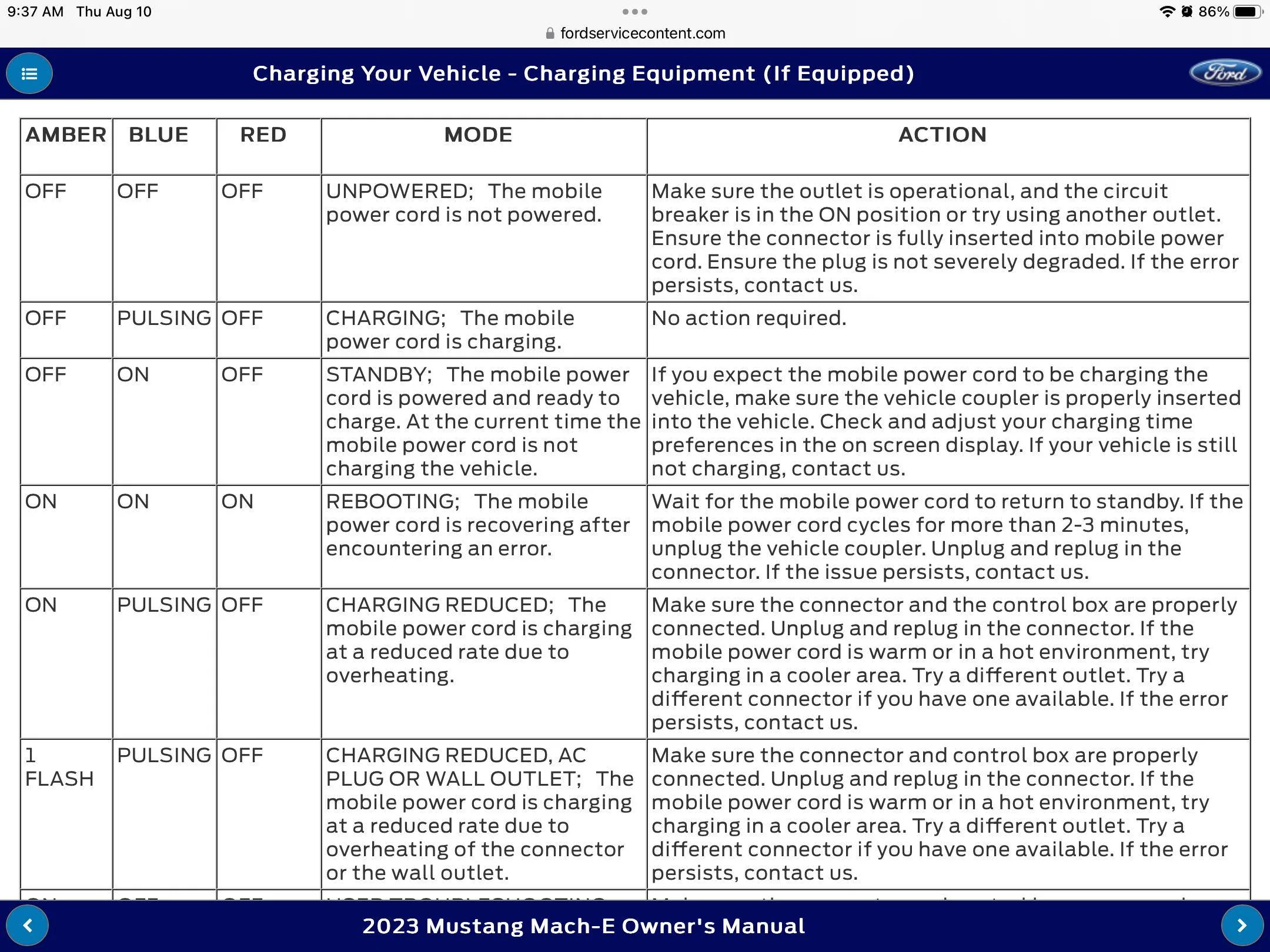

Check the owners manual for what the light colors mean. Likely you are overheating the charger. Not your fault, lots of people reported the same issue.

We have a Tesla that uses the same plug to charge and it doesn’t affect the Tesla charger at all. I’ve never seen the charger light up like this, and I can’t find anything on it other than when it’s not plugged in properly and you get the red line.
Maquis
5,687
8,068
All 3 lights on means it’s rebooting. It sounds like it’s stuck in some kind of reboot loop. If completely unplugging everything doesn’t solve it, the charger is toast.

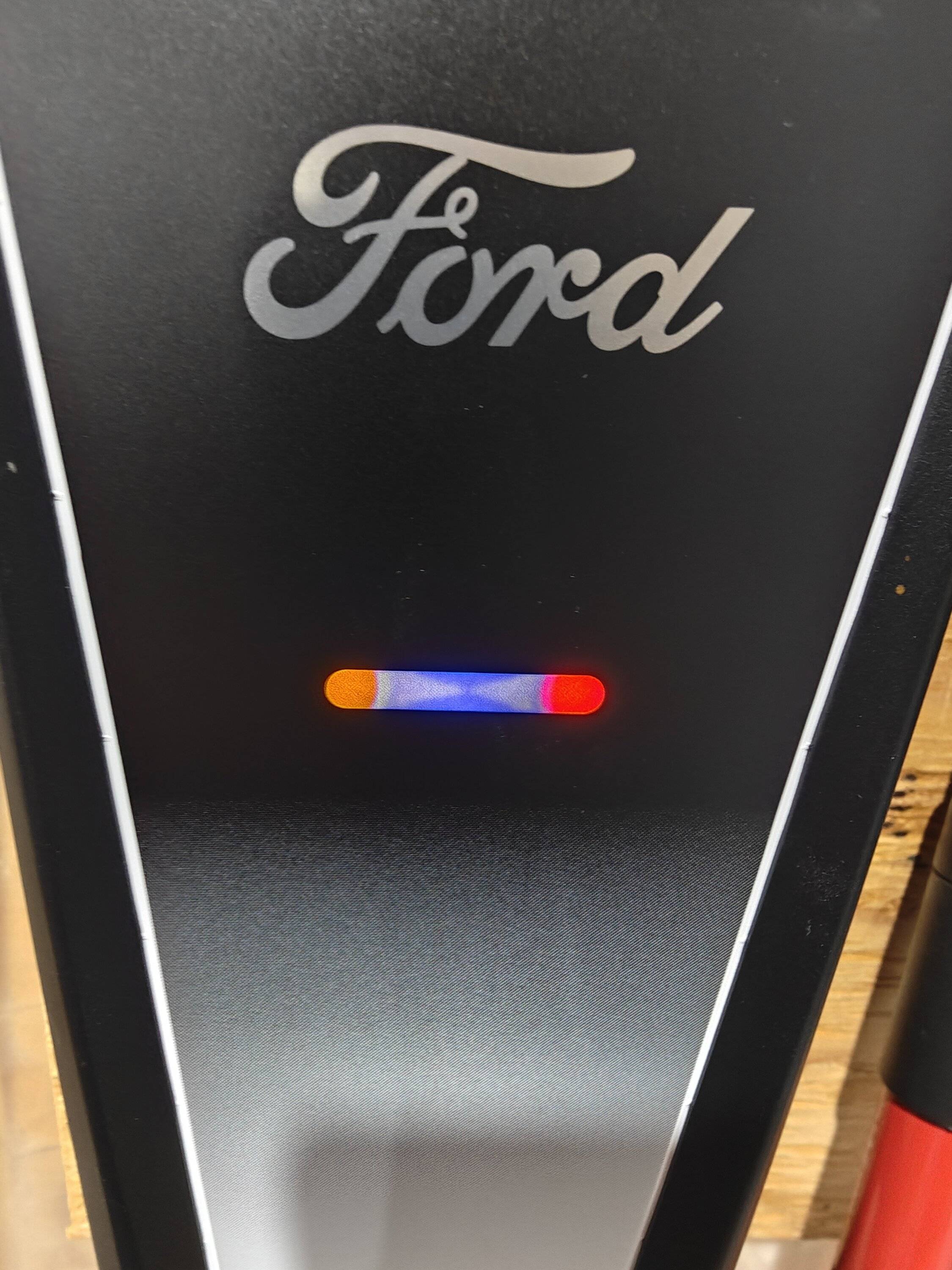

Yes. Last summer. Took it to mean a high heat alert. Went away on its own with no lingering problems

Yeah mine recently did the same thing. I've only had my Mach-e since beginning of September. The very first mobile charger was DOA and just had a steady red light. Replaced by dealership and the second one lasted a month and a half. Dealership also replaced the second one. That was with charging the Mach-e once a week. I don't think these mobile chargers were designed for regular charging. I just ordered a Lectron L2 V-Box
