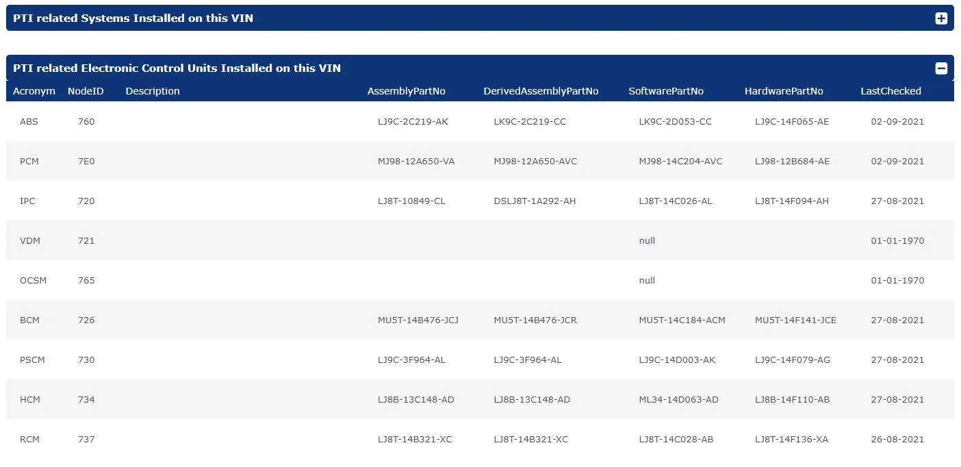

As I do not have a working communication with the dealer, is there any possibility to see if the IPMA module has been updated online, i.e. is there anyone on this forum that has access to a service where they can see if an update has been done, provided they have my VIN?
You used to be able to use a service called Ford ETIS, which would show you available software levels, but that does not work with the Mach-E. It DOES however show you the PTI information relating to your vehicle. As far as I can see though, IPMA is not listed. You can see an example of mine here.
