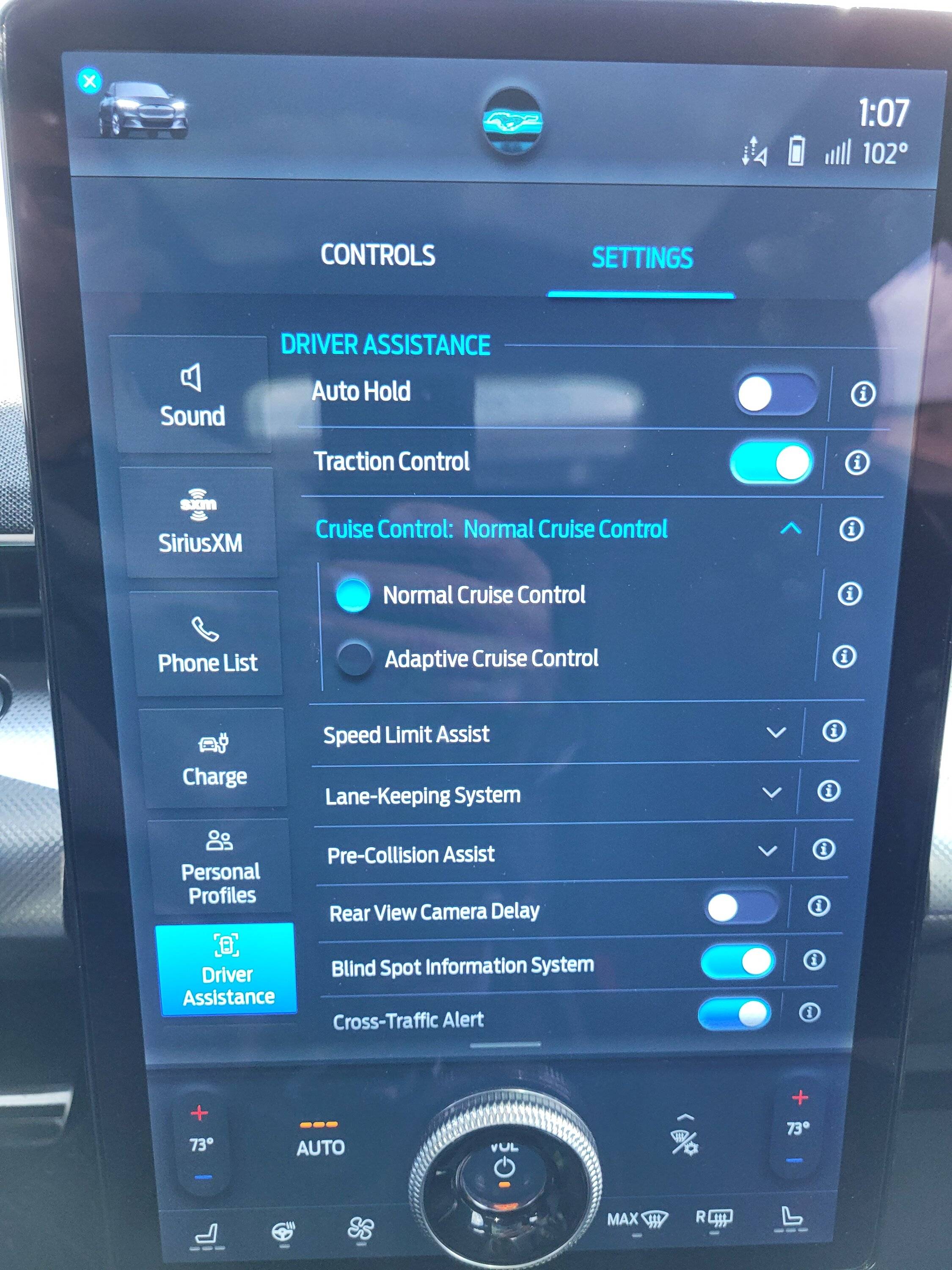

Here is the setting. Normal Cruise doesn't need the camera.
Yep. That’s set. The previous firmware would give a sound indicating it wont activate when I would attempt to set it but now I get no response. Just.…nothing. Why would this be inactive??
Not sure.
I tried it today and the Normal setting worked just like a basic cruise control. Not sure why it isn't working on your car. Weird. ?
