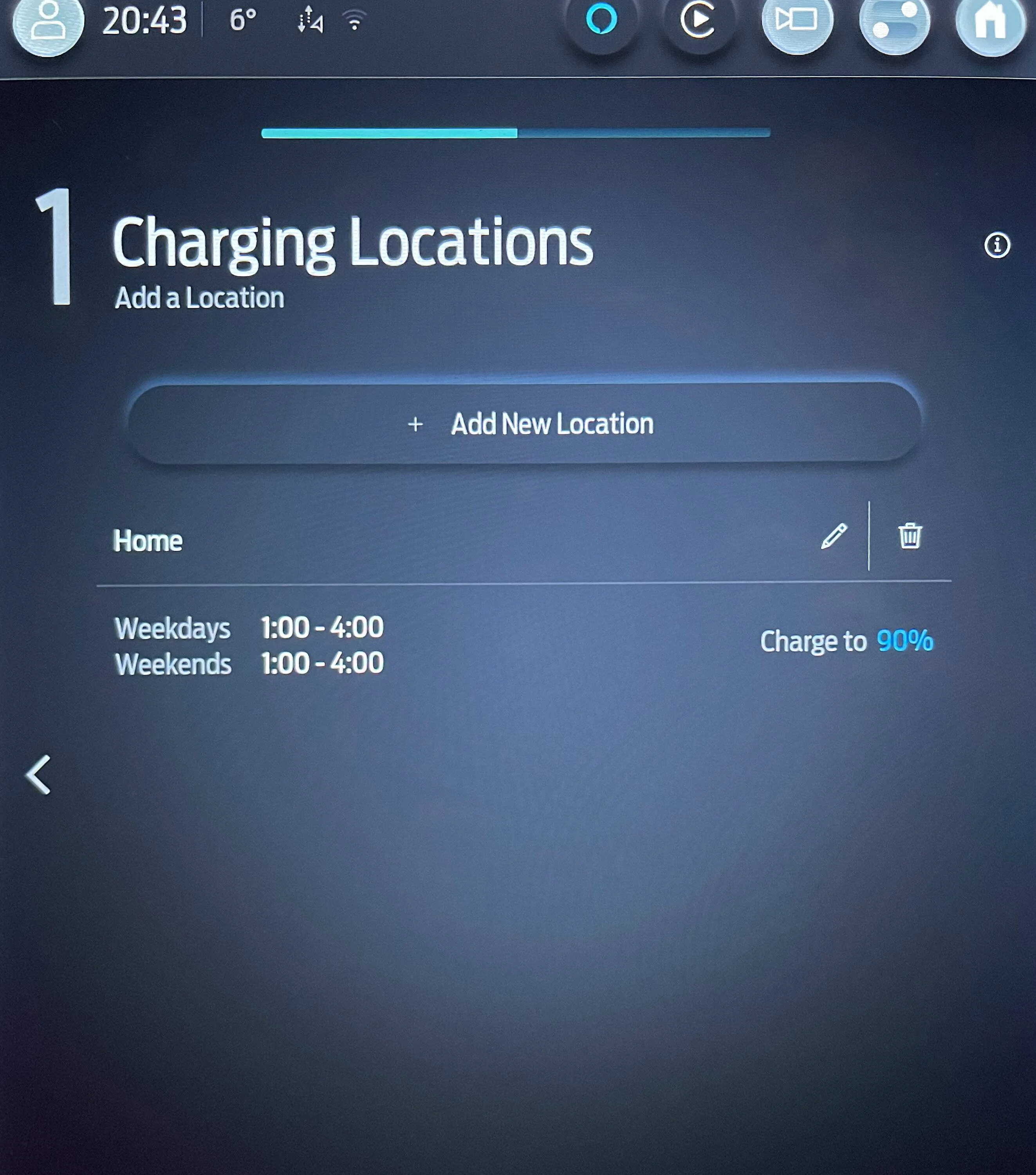

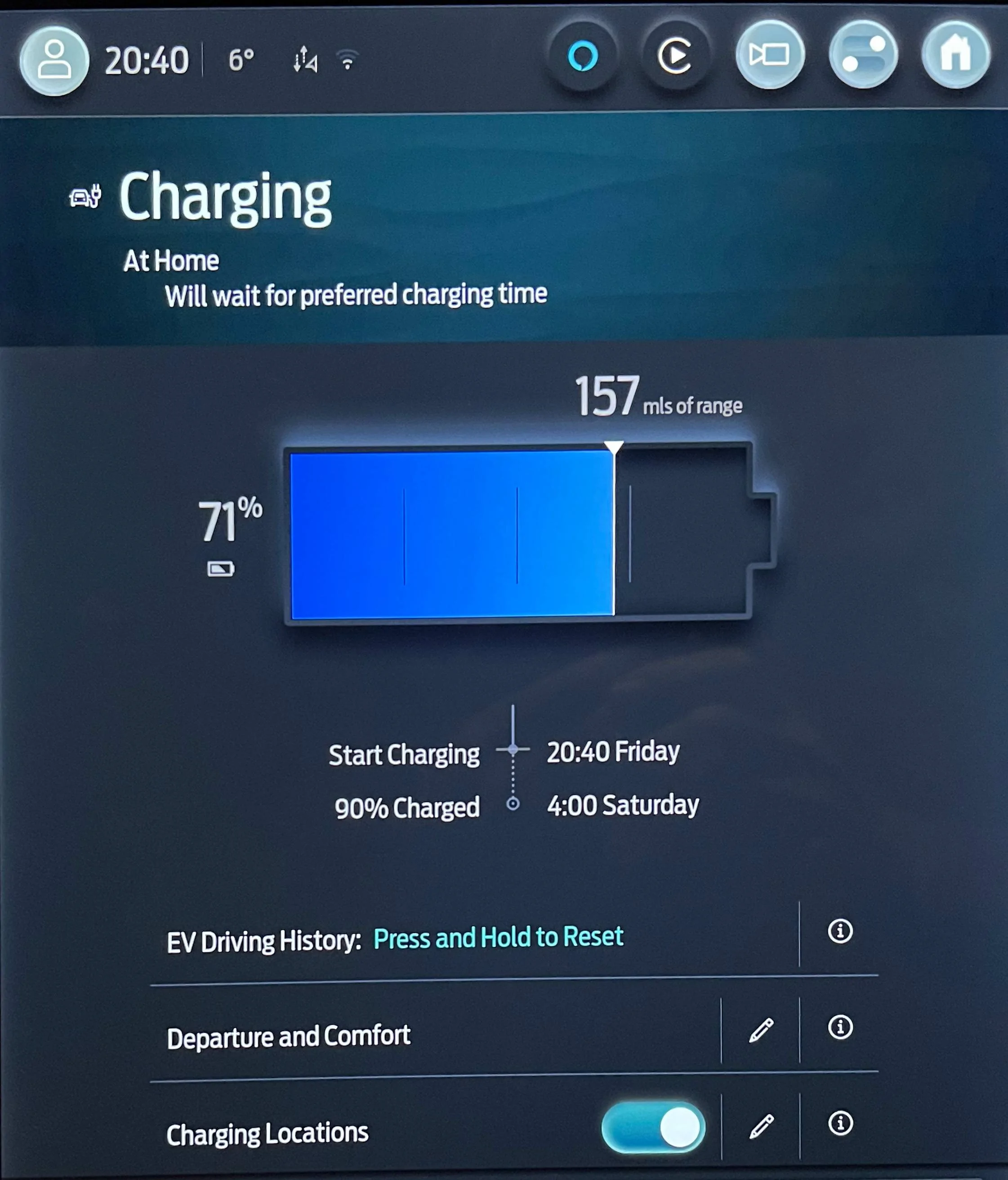

I have a problem with preferred charge times in Fordpass and the car, they do not work.
The car nearly always starts to charge as soon as I plug into the Ford wallbox. If I stop the charge with Fordpass and leave the car plugged in it may start charging at a random time.
This means I cannot reliably use my low cost EV rate electricity via my 7.4kW Ford wall box.

The images show that the car thinks it will charge at the preferred times and start straight away! Which is what it does. The other shows the preferred times set

Umm. The car and Fordpass agree as to what the preferred charge times should be. However on arriving home and plugging in it immediately starts to charge, almost every time.
I thought it might not know I was Home so I tried leaving it then checking the screen in the car to see it knew I was home. It did and that made no difference. I reprogrammed home, that didn't fix the problem.

Your charging window is too short, which is causing it to charge outside of charging hours. Suggest an 8 hour window, or use a more powerful 10 kW charger.
I cannot lengthen it and still use cheap electricity, which is another complaint I've made to Ford. I will ask if this would make a difference.
In the UK the max single phase charger is 7.4 kW. A three phase 11 kW charger is available but I would have to pay to have the pavement and my drive to be dug up to have that installed, even if they would do it.

Your car is unable to completely charge to target in only 3 hours. Which is why it’s having to start early. How do you propose this is handled instead?
I would get a different rate plan if you only have a 3 hour charging window. That’s too short and really dumb. Should be 6 hours minimum.
In the UK the supplier, Octopus, I have chosen provides the cheapest electricity for four hours every night. It is rated as one of the best by EV users. In the cheap period it is 29% of the day rate. I think we pay a lot more for electricity than you do in the US.
That is adequate for 99% of my charging requirements.
Due to the inadequacies of the Mach E and Ford Pass software I can only use three hours.
The Mach E can be set, according to the GUI for as little as 1 hour charging.
Nothing I have read says that the target value must be reached within the charge time set and none of the Ford support people have mentioned that as a problem. Being retired I just plan ahead if going on a long trip. If the worst came to the worst I'd just charge up the last bit on expensive electricity.
When I get to talk to an expert I'll ask if that could be the cause. If it is it is pretty dumb.

In your case I would set it to 1-7 AM so it’s long enough to satisfy the charging algorithm. You might go over a little bit, but it should mostly use the cheap electricity then.
You can also get a smart EVSE/Charge Point and set the schedule on that.
I’ve never seen an EV rate plan with less than a 6 hour charging window. Usually there’s not much difference in the cost of electricity over the nighttime hours here.

4 hrs of charge time should get you about 80- 85 miles of charge.
Is this enough for your daily use?
If so, use your preferred time, as set in Fordpass, for best rate, and plug in every day…… Would this work for you?!
I live in Pennsylvania, USA. It’s winter here, car is plugged in when not being driven. My preferred time is midnight to 6 am. Bill P
I can only get 3 hours because the Mach-E only works to exact hours whereas my supplier works to the half hour. However 3 hours covers a very large amount of my requirements.
If I'm going a way I prepare by charging on the days before.
However Preferred Times are so unreliable at the moment I don't use the Ford wall box at all. I do it all on the "Granny" charger and can adhere to the 00:30 to 04:30 requirement exactly and reliably using a wifi socket I purchased for about £8. I deplete my PV battery just before the low rate period starts and that then powers the granny charger and the recharge of the PV battery. I effectively get 14-16% charge into the Mach-E at the cheap rate.
