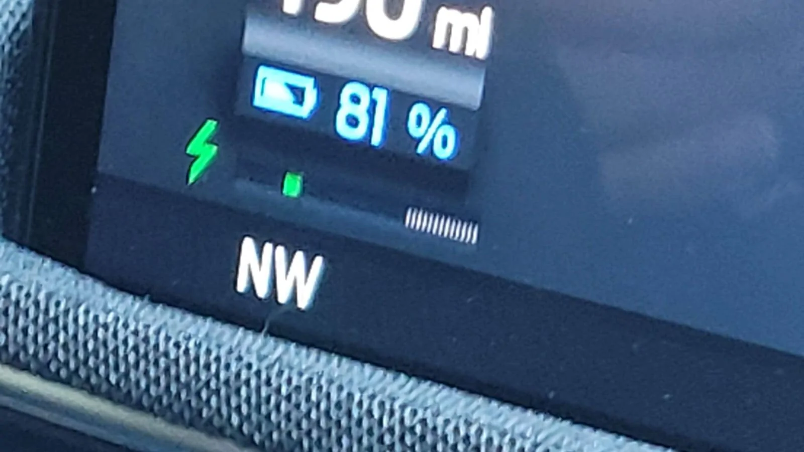

I got this at 60F on Skyline Drive. June 2022 build, no codes thrown. After a bit of troubleshooting (aka turning it off and back on again and letting it sit for awhile) to no effect, my kid finally noticed the map.
Turns out this is what happens when your GPS glitches to Syria.
