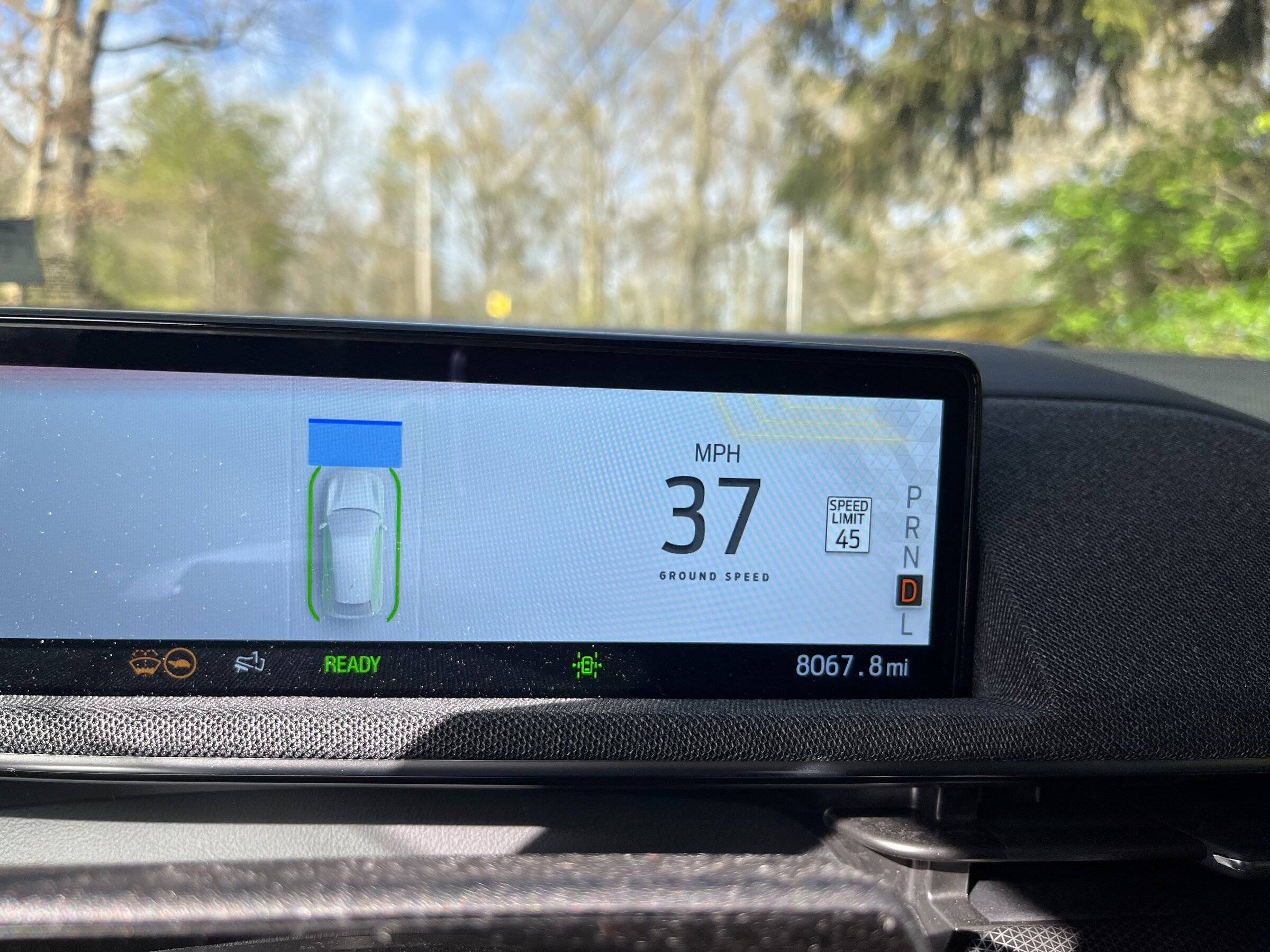

Took a short trip Monday. 80degF outside. High SoC. 40-45 mph roads. Going up 15% grade got the bars (which happen every single trip I take for a variable period of time). This time the car was literally decelerating while I was flooring it. This is so frustrating. I'm not ever going max power. I don't hammer corners. I was simply trying to go up a hill in a high performance car. Took to dealer on Thursday. They said there was an update I needed (why can't that be OTA???) It didn't fix the problem. On the way to work the past three nights.... bars. Significant bars and significant power limitation. The technician at the dealer does not seem to have a clue. Ford is unresponsive. Looking for help!!
Your car has engaged turtle mode and power is significantly restricted in this mode. It's the equivalent to a check engine light. My car went into turtle mode during my stop safely now issues. Definitely take it back to the dealership ASAP. This could be the beginning of something more serious.
