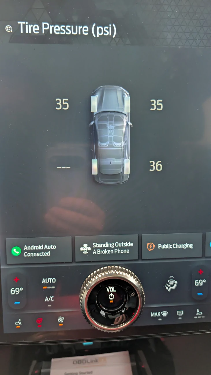

I need to preface by mentioning that about a month ago I started getting random faults from the TPMS sensor on the driver's rear tire. It would fault about once or twice a day then go back to normal. I wasn't too concerned because I was about to switch out rims, tires and TPMS sensors anyways.
Last week I got around to installing my four new wheels, tires, and the fresh set of Ford TPMS sensors that came with my Rally wheel kit.
The included Ford TPMS sensors came with a training device. Since these sensors didn't automatically connect like my last new set did, I put the car into training mode and attempted to assign the new sensors using the supplied tool.
I've attempted the training 5 times and every time the first three sensors connect flawlessly, but the last, the driver's rear tire, refuses to connect. Being that it's a different sensor, I'm thinking that there's another issue. My first thought is that there's something interfering with the signal from that sensor location, but there's nothing new in my MME that I can think would do that.
Does anyone have any troubleshooting ideas? Could this be an issue with a module or does it sound more like a bad sensor? It would be quite the coincidence if it were another bad sensor in the same corner.

Here’s where things currently stand with my TPMS issue:
Attempts to manually sync the sensors using Ford’s sync tool consistently fail because the driver’s rear sensor won’t sync. Even when the other three sensors sync successfully, the system won’t save any of them if one fails. I’ve also tried swapping tire positions, but the same corner still won’t sync.
Today, while driving, I noticed that all sensors except the driver’s rear had automatically synced at some point.
I could take it to the dealer, but my preferred one is an hour away, and arranging service is inconvenient. Plus, I prefer to work on my vehicles myself whenever possible.
From what I understand (based on replies to this post), there are four receiver units—one at each corner—that pick up signals from their corresponding tire pressure sensors. It seems likely that the receiver at the driver’s rear has failed. Does that sound accurate?
