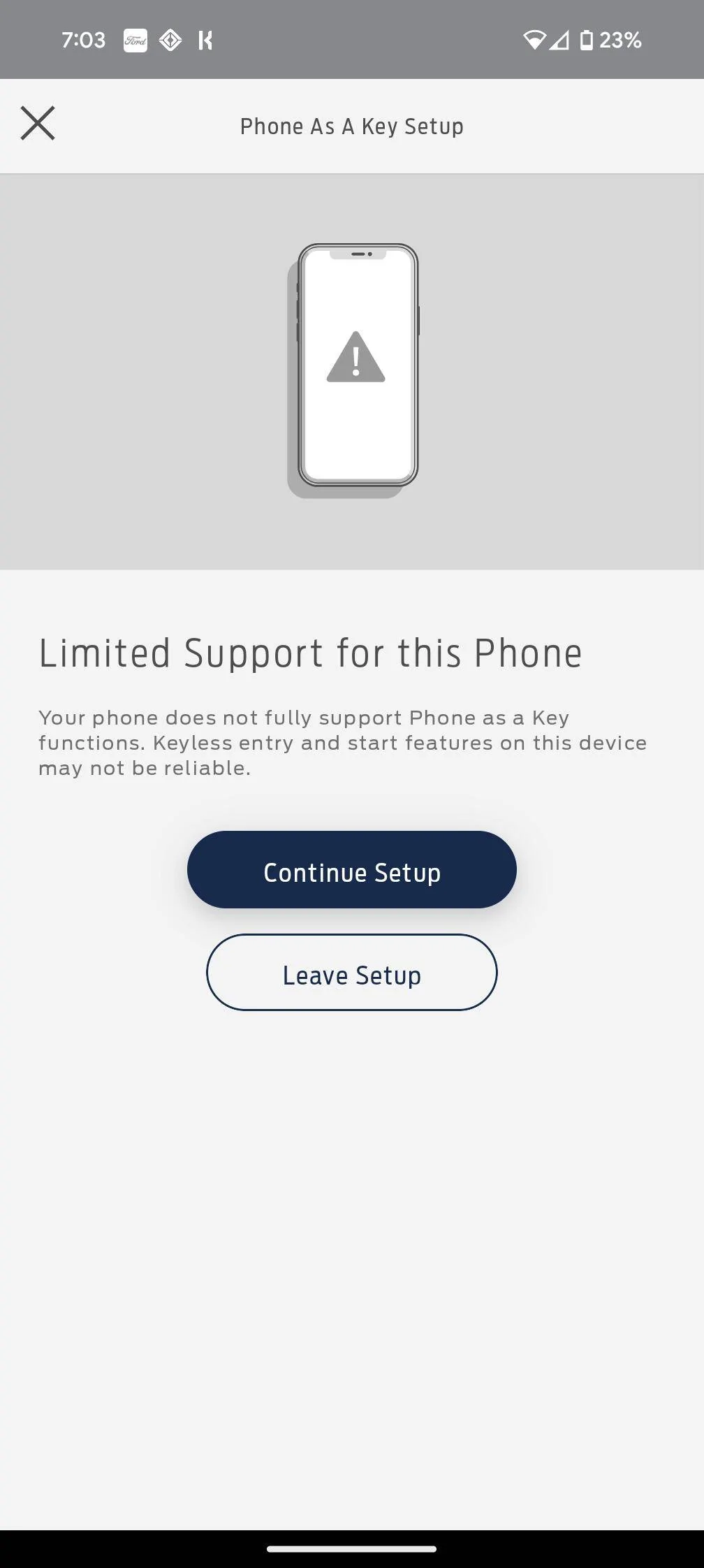

Just wanted to get a thread started on the P8 and P8P so we can keep issues and findings in one place.
Setup of PaaK with the P8P resulted in the usual "Limited support for this phone" warning message which has appeared every year at the release of the new Pixel. PaaK did however setup just fine. I would recommend that you do a PaaK reset in the car before connecting a new device. This will remove any stale/old devices, and your backup passcode. You'll re-create a new passcode when setting up the P8/P8P.
My testing of PaaK with the MME today (not my daily driver) proved that it is fully functional.
