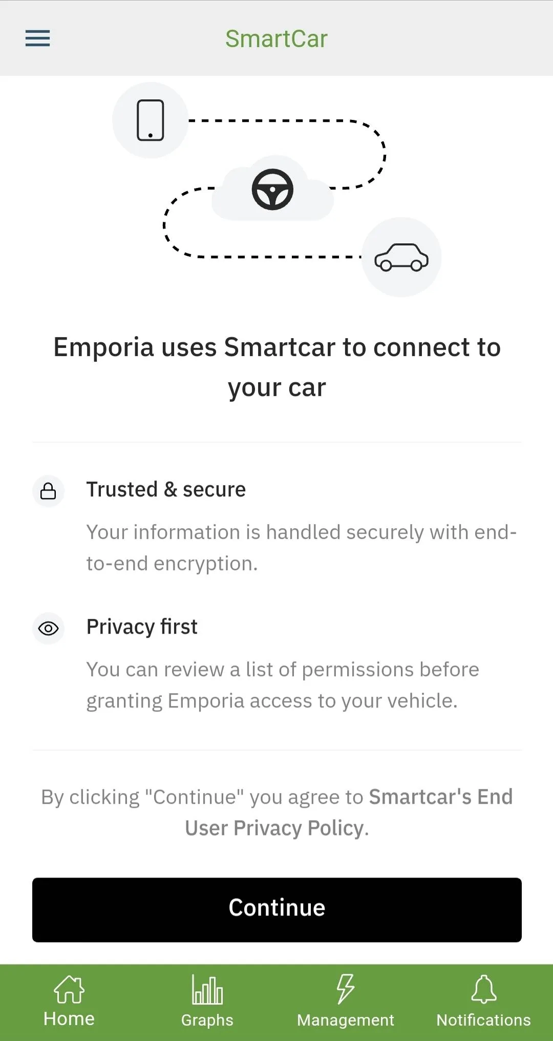

I'm going to add the Emporia Energy app to the bad list. There is an optional step during EVSE setup to add your car (used to view % SoC in the app), and this uses Smarcar integration (again spoofing as FordPass) unfortunately. Reading this topic it should be clear that Smartcar is a known offender that gets your account locked. If you are using the Emporia app, make sure you skip setting up the vehicle integration to avoid that risk.
That must be new. I just checked mine and there it is:
Ford Mustang Mach-E PSA: Unauthorized API use can disable your FordPass account Screenshot_20230119-063727_Emporia Energy

@EmporiaEnergy - can you remove the MME from your list of SmartCar enabled integrations?

SmartCar is aware of this issue that stems from Ford's transition to a new API. SmartCar is in contact with Ford and working on a solution that we hope will come soon, but unfortunately, we have no way to exclude the MME from the supported cars in the Emporia app. We will post updates when we have more information from SmartCar and Ford.
Do not believe what Smartcar tells you, they lie to many developers about being an authorized user of Ford’s API. They are not authorized by Ford whatsoever to be doing what they’re doing. They are spoofing Ford’s website to illegally collect user credentials in violation of Ford’s terms of service. They should never be asking for the user’s FordPass password. I suggest you completely sever ties with them like other developers have done until an authorized API method is available from Ford.
Again, no 3rd party API use is currently authorized by Ford. If you were told Ford allows access, that is not true. Be skeptical of what they are feeding you. It is not ethical to continue to allow your users’ Ford account credentials to be stolen by Smartcar through your app with the current implementation.
