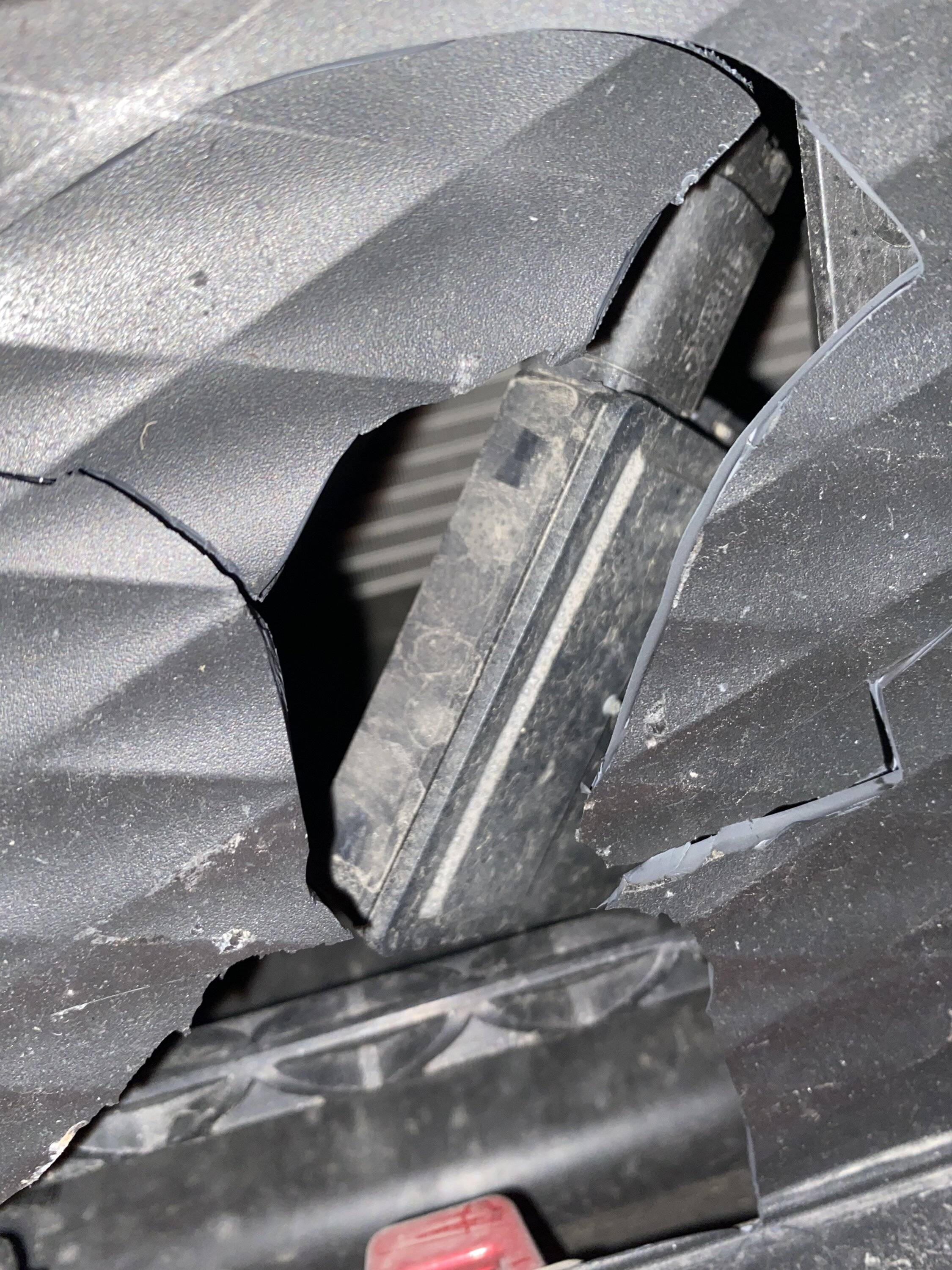

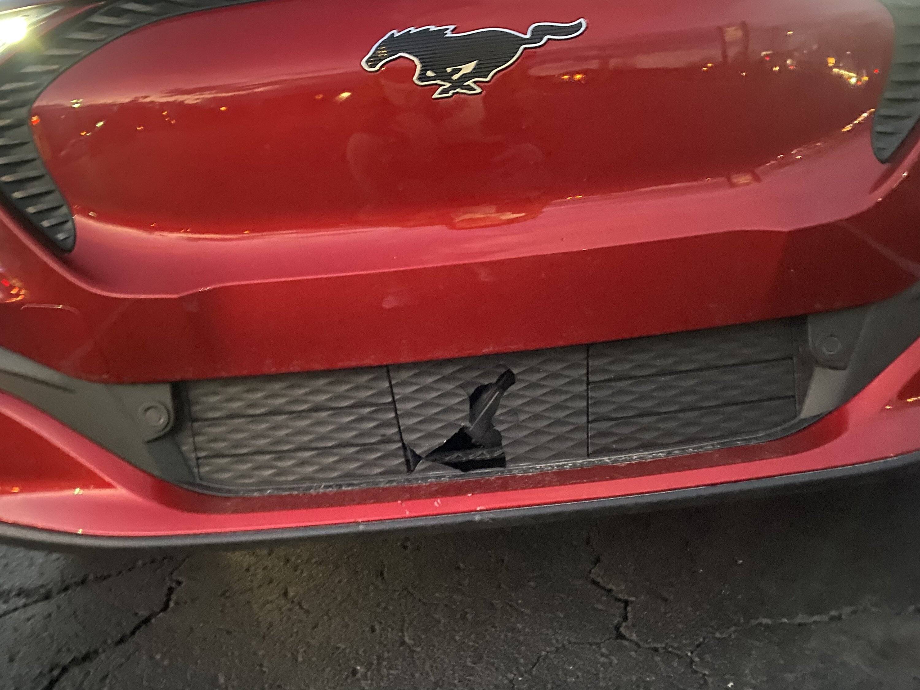

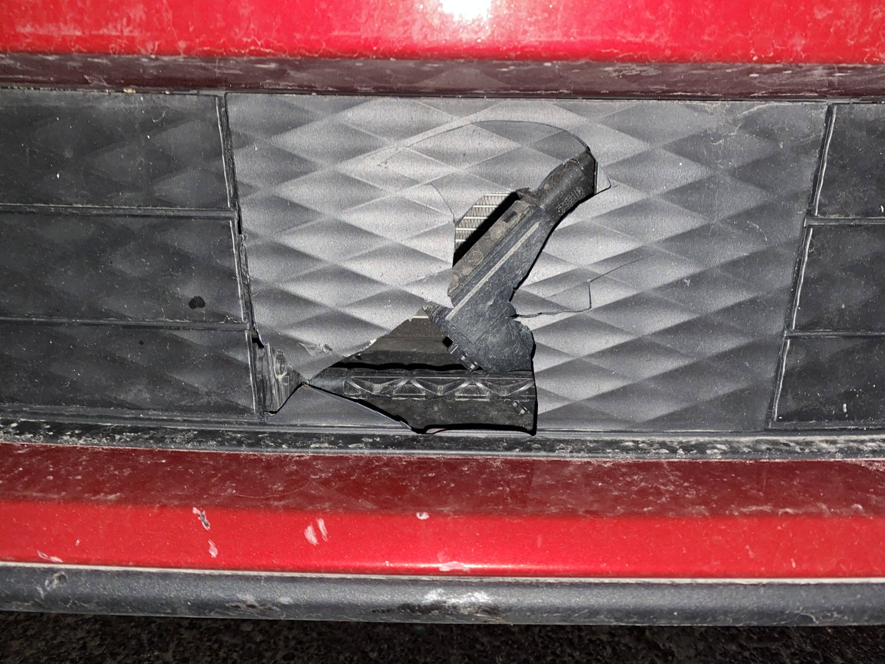

Hello All,
Posting today to get some info and/or advise.
I was driving down the interstate today on an 8-10 lane highway. I’m in the far left lane. To the left is the median and to the right I a row of moving cars. All of a sudden I see what looks like a bunch of small black trash bags flying everywhere. A few of whatever they were ended up directly in my driving path, and it was either run them over or swerve into the median/moving vehicles.
I run over the objects and they were solid, definitely not a bag or anything alike. A loud bang, crash, and grinding sound. To me, it sounded like a sharp thud and grind as the objects passed under my car.
After saying a few choice words, I realize my Mach E is not slowing down as it approach other cars (was in hands free driving mode). Turn cruise on/off and mess with the setting and nothing fixed it. When I get off the highway and am close to home, I stop to see if there was any damage.
What I see is a gaping, round hole in the middle of the vent on the front bumper. I couldn’t see the damage underneath the car, but could see electronic/car parts hanging in/out of the hole.
I call the insurance and they file the claim and tell me someone will contact within 48 hours for next steps.
Had anyone else had something similar happen to them? Where they hit something and it damages the front vent and front sensor (no smart driving)? If so, how long did it take to get repaired? Did you have to take your Mach E to multiple locations? Did the Ford dealership do anything on the technology repairs? My previous experience with my local Ford dealer sucked. They were supposedly an EV Ford dealer but broke my car before.
Any help and advice would be much, much appreciated. I am super stressed and irritated about this! I have bad luck. Before I got the Mach E, my previous car got busted on the same road from something flying out of the back of a pickup in front of me…2 times in less than 15 months! Ahhhhhhh!
(See attached pics)

Hello All,
(See attached pics)

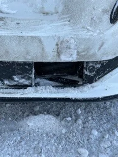

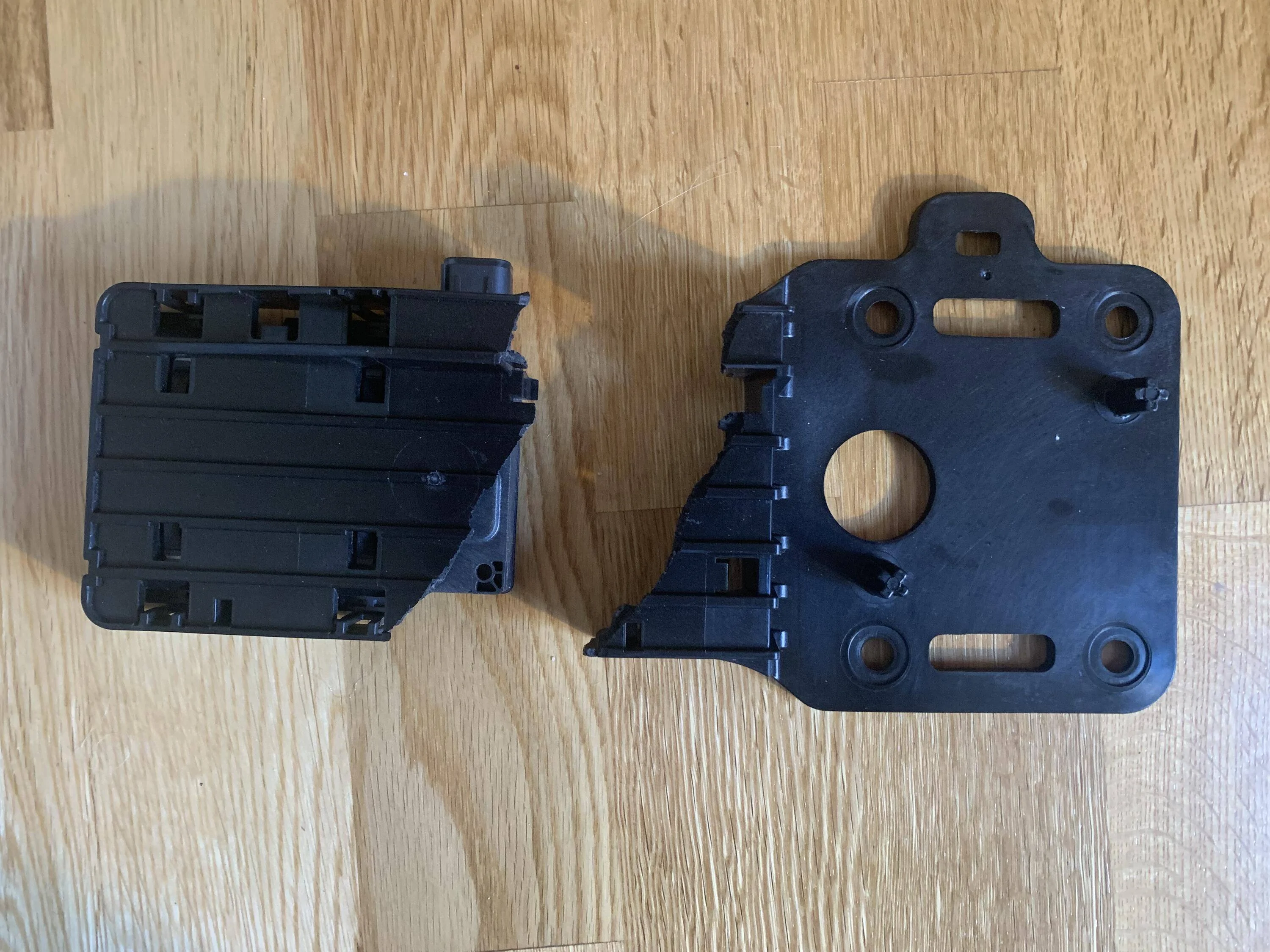

Here's my tale of whoa. I was on a ski vacation in Northcentral Washington (Methow Valley). Middle of a cold snap, huge amounts of snow (well, not like the San Bernadino's, for sure.) Some nights at 0° F, days <10. During this time I received OTA 4.1.2. Then I noticed that Precollision Prevention as well as Blue Cruise were nonfunctional or flashing on the screen at startup. I blamed it on the update. Weeks later I called Ford Central and walked it through. Making no progress with this and that, I suggested that maybe the radar was broken because both work out of radar. Ford set up a case # and referred me to the dealer.
No dents, no scratches on the front. Plastic license cover was also unscathed and unmarked. Dealer took it apart and found that the bracket was broken. So, it must have been an accident, my fault, no warranty coverage. And, while you got it apart, he said, I recommend to replace the bracket AND THE RADAR. Yup: $1280. (I never thought of reporting to insurance.)
I didn't have any accident. Remember, no scratch on the exterior. Then I recalled a very slow (1 mph at most) touch of a hard snow bank while parking.
Ford Mustang Mach-E Ran Over Crap Now It’s Busted tempImagequUbZV
Broken bracket at 1 mph? Brittle plastic at 0° F? Ford has a defect here. So, my handle on this Forum is "Ford Family". I was born in Dearborn. Father worked in Detroit auto industry all his career, twenty last years at Ford. My sister received a full ride to University on a Ford Scholarship. In 1960 I had my congenital heart valve defect repaired with 50 units of blood donated by ...Ford colleagues. I thought I'd help the company and make a suggestion. I called and reported to Ford Central with a suggestion to change the radar bracket with a metal design. What a concept! Oh, and perhaps for that you might cover my charges under warranty? I haven't heard anything from Ford Central and I ain't holding my breath.

I don't think they can make the bracket out of metal because the reflections would affect the radar signal. However I do agree there is evidence mounting of a design defect with the radar bracket, I've seen them broken numerous times now with little to no external damage. The way it's mounted the radar sensor can "flop" back and forth like a ruler plucked over a countertop edge since it hangs down from the bumper. Seems like eventually the material fatigues and cracks when going over a bump. I think it should be redesigned with additional strengthening.
I also think Ford should cover this under warranty since there is no evidence of a collision. See if you can contact your case manager and dispute their conclusions.
If the sensor itself is undamaged, they should just be able to replace the bracket, which would be much cheaper.
