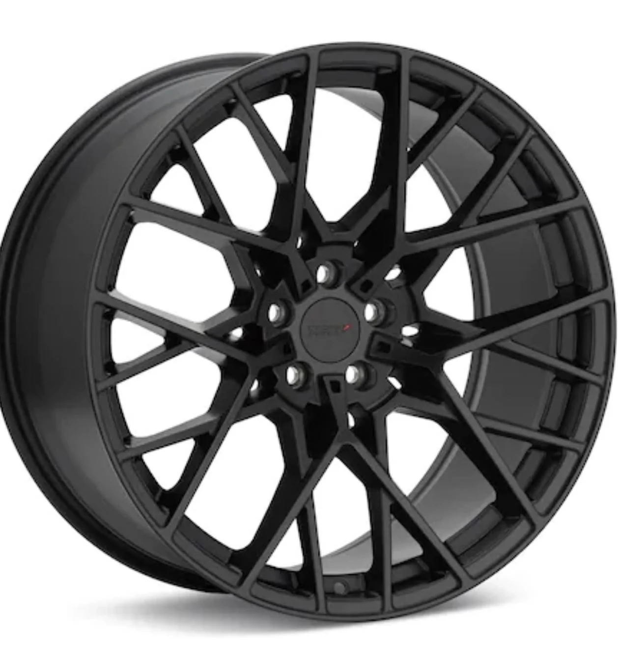

@markboris I’m looking at the tsw Sebring wheels and they offer a 20x8.5 +40mm offset which other members run without issue .
I want to go wider in the rear. Will a 20x10 +40 fit ?
Hi Randy,
20x10 will fit in the rear no problem but I normally run an offset of +47 with that size wheel. That gives me a flush fitment of the tire sidewall to the wheel lip moulding. +40 they will poke out a bit like 1/4". You can lessen that a bit by not going with a really wide tire. 275/40/20 would be the narrowest you should run with that wheel. I suspect you will run 245/45/20 tires up front on the 20x8.5 wheels. Both of those sizes are the same diameter so you will be ok there. Hope I answered you question and let me know if you have any others.

Hi Randy,
20x10 will fit in the rear no problem but I normally run an offset of +47 with that size wheel. That gives me a flush fitment of the tire sidewall to the wheel lip moulding. +40 they will poke out a bit like 1/4". You can mitigate that a bit but not going with a really wide tire. 275/40/20 would be the narrowest you should run with that wheel. I suspect you will run 245/45/20 tires up front on the 20x8.5 wheels. Both of those sizes are the same diameter so you will be ok there. Hope I answered you question and let me know if you have any others.
Mark thank you first of all.
The whole point of a wider wheel in the rear of the car was for a “staggered” look. Having the wire stick out beyond the fender flare to me looks tacky. I guess that’s why no one went with the 20x10 tsw sebring in the rear.
Now I have to make a hard decision if I want to go with the 20x8.5 all the way around or try to find a wheel that comes in an offset around 45 - 47mm.
Is there some sort of calculator that has a mach-e in their database for figuring out max width of rear wheel I can run ? I’ve been googling and the problem is the mache isn’t in their databases ?
