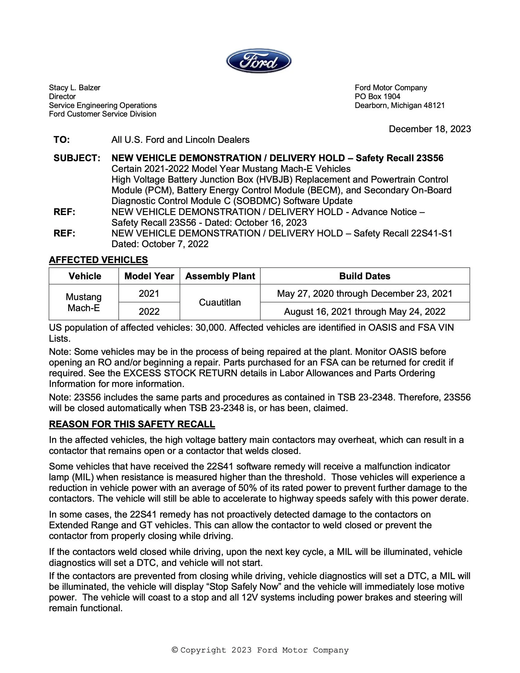

I didn't know that. Are the 23's using the same part that 21's and 22's were built with, or are they using some intermediate revision?
(I guess it's also possible that different 23's are using different parts depending on their build date.)
The 21s and the first half of 22's were built with parts A and C. Starting the 2nd half of 22, they switched to the B and D boxes and continued using those for 23s. That is why the recall is only for 22's made before a certain date.
The original revised HVBJB for the GT and 4X, B and D boxes respectively, have never been able to hold up. It’s ridiculous that owners have to just sit around waiting for their cars to die and strand them.
Do 2023.5 get the latest version of the boxes?
I don't think any 23s got the new ones, just the B and D parts. I also don't think we've had confirmation the 24s got the new ones, but I think thats likely a safe bet?

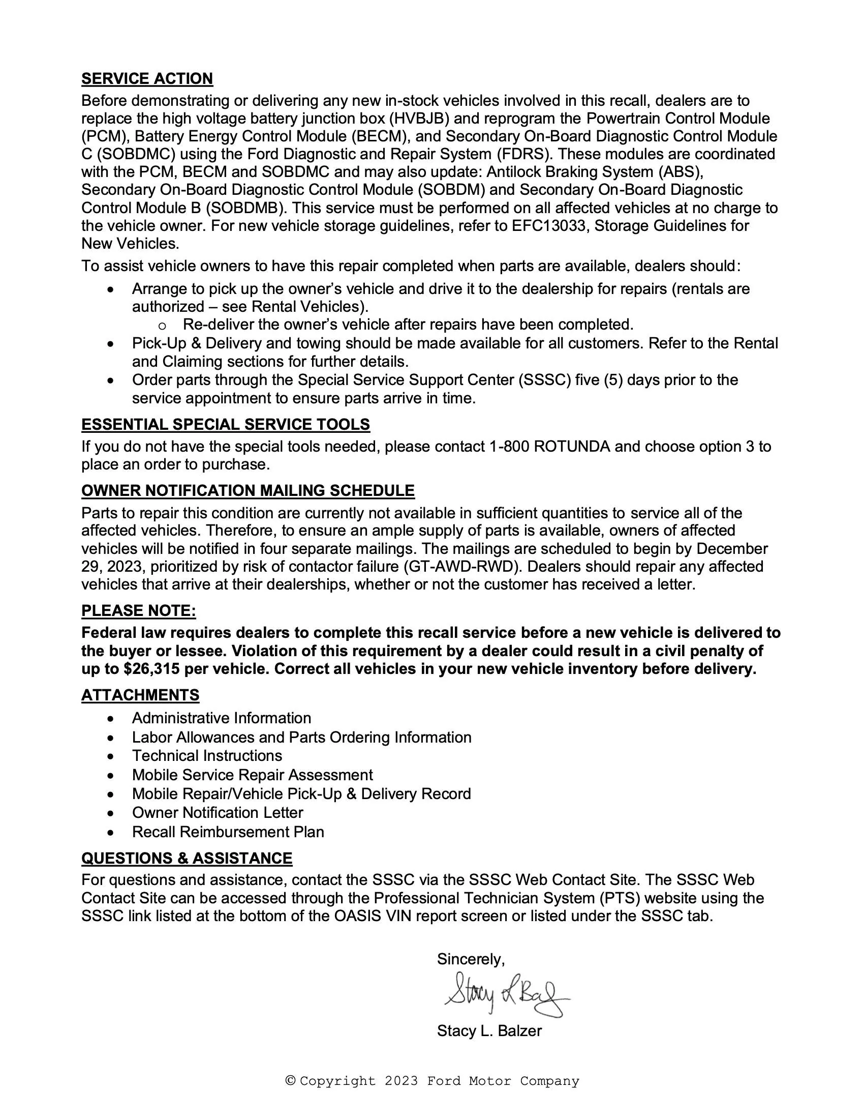

I surprised that there's no way to see the exact part numbers used in a specific car given the VIN number.
PARTS REQUIREMENTS / ORDERING INFORMATION
Special Program Part Ordering:
To place an order for the HVBJB and required hardware, submit a VIN-specific Part Order contact via
the SSSC Web Contact Site five (5) days prior to the service appointment to ensure parts arrive in
time. Due to limited part availability a signed sales agreement for unsold vehicles and open repair
order for sold vehicles will be required.
Part Number Description Order
Quantity
Claim
Quantity
LK9Z-10C666-C HVBJB – GT vehicles only
1 1
NK4Z-10C666-E HVBJB – All Wheel Drive vehicles only
NK4Z-10C666-F HVBJB – Rear Wheel Drive vehicles only
W717859-S439 Battery mounting bracket bolts (2 req/pkg of 4) 1 2
W720404-S450 BECM mounting bracket bolts (4 req/pkg of 4) 1 4
Dealers will be notified via a DOES II communication if circumstances warrant a change in part supply
strategy and when open ordering resumes.
Order the parts below through normal order processing channels:
Quantity
Claim
Quantity
VC-13-G Concentrated coolant/anti-freeze up to 1 gallon
