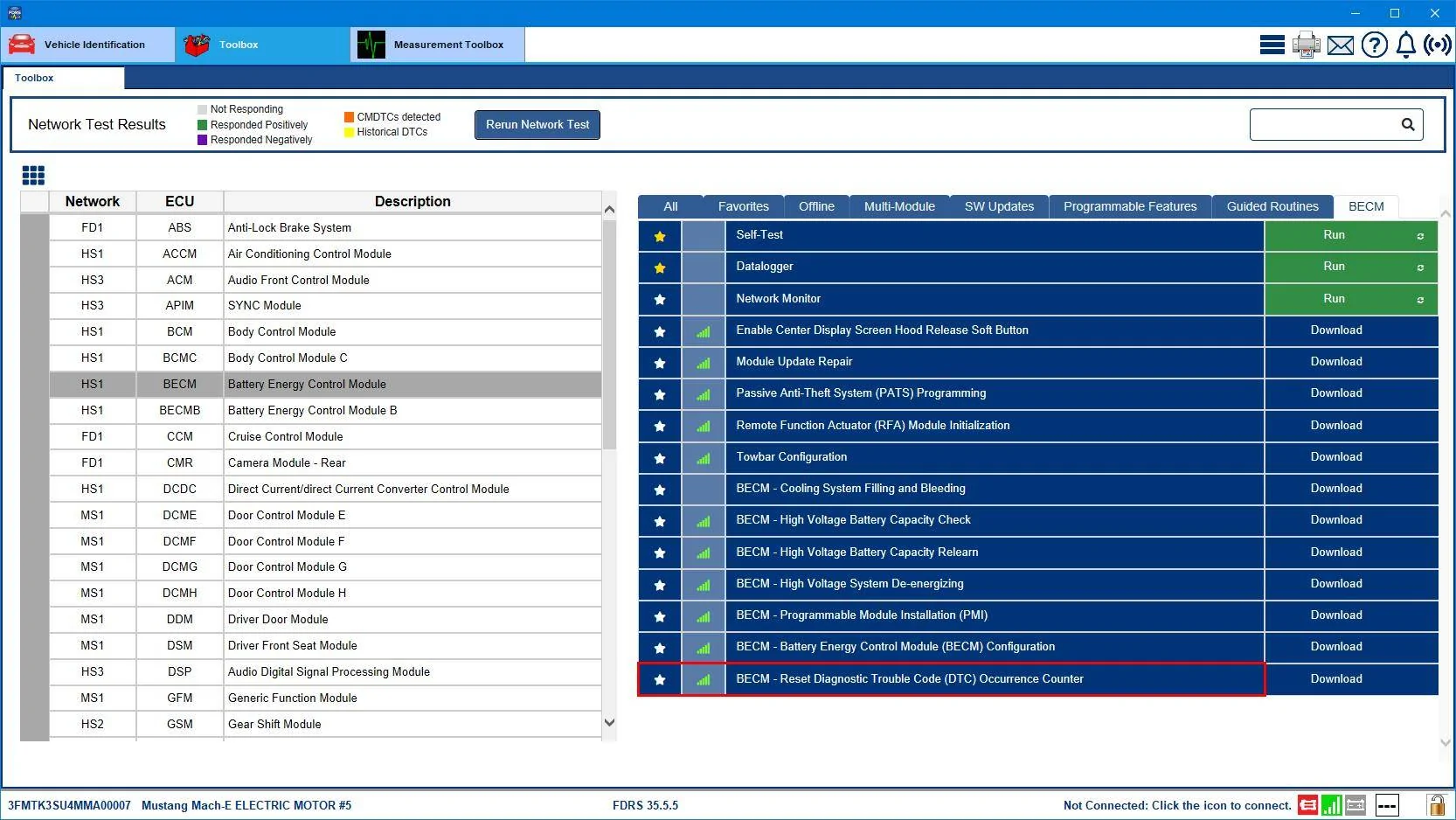

SSM 51705 2021-2023 Mustang Mach-E, 2022-2023 E-Transit - Illuminated Powertrain Malfunction (Wrench) Indicator With Various DTCs Stored In The BECM
Some 2021-2023 Mustang Mach-E and 2022-2023 E-Transit vehicles may exhibit an illuminated powertrain malfunction (wrench) indicator with diagnostic trouble codes (DTC) P0ADA, P0ADE, P0AA1, and/or P0AA4 stored in the battery energy control module (BECM) after high voltage battery junction box (HVBJB) replacement. Vehicle may also exhibit reduced powertrain performance and/or a Stop Safely Now message displayed in the instrument panel cluster (IPC) and/or High-Voltage Battery Warning message in the FordPass application. This may be due to the BECM software. To correct the condition, download and run the BECM - Reset Diagnostic Trouble Code (DTC) Occurrence Counter application in Ford Diagnosis and Repair System (FDRS). If the concern persists, refer to Workshop Manual (WSM), Section 414-03A for normal diagnostics.
----End SSM----
Not sure how I feel about this, running the application likely changes the configuration in the BECM to reduce or disable sensitivity to excessive contactor voltage drop that triggers SVS. A small subset of owners have experienced multiple HVBJB replacements after getting the new part. It's unknown to us whether these subsequent powertrain malfunctions of the new part were false alarms or indicative of actual repeat failure.
I don't like that the SSM omits mention of the HVBJB replacement date, if it was replaced before around late July 2022 it is still the old part that is prone to failure and definitely needs to get replaced the next time SVS pops up.

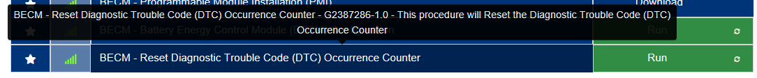

And then there are people like me who got the SSN and SVS and FP warnings while sitting in the driveway doing door module updates with FDRS and have never had the HVJB replaced. This has happened more than once (along with the number of times those pesky door modules have been updated). No idea what the correlation is there.
Mike G
Mar 27, 2022
6,449
5,289
N. AL, USA
BTW here's the tool in FDRS:
