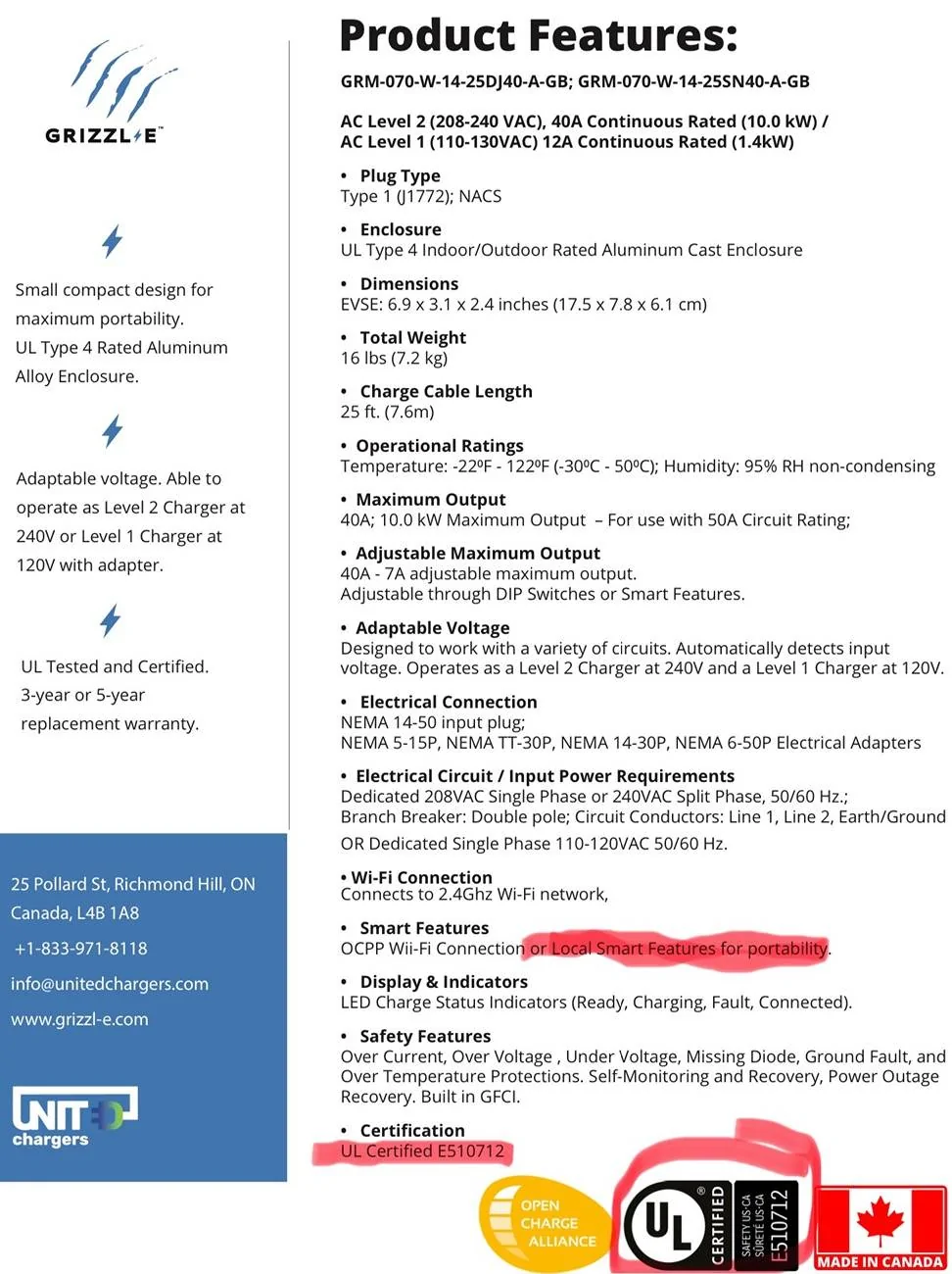

i have been interested in their mobile version for a long time.
this statement below does give me some pause. Anyone have more information on why this is not a concern?
  • The original Grizzl-E mini was not safety certified. After years of saying it was about to be certified, the manufacturer finally obtained a UL listing for the current version. But it has features that are prohibited in a portable unit -- it is apparently certified only as a fastened/fixed-in-place unit, a categorization UL allowed them to put it in by including a wall-mount bracket in the kit. It is sold as being portable, perhaps in violation of the UL listing, but our criterion for the list above is that it be listed as a portable unit. It comes with a set of lots of different adapters. The downside is that to properly configure it for a different plug, you need to remove screws to remove the cover and set dip switches--an operation that is supposed to be limited to qualified persons doing an installation, not a consumer plugging in a portable charger. If you consider yourself qualified, or if you need it for just one plug type and setting, you might consider it.
The three things that crossed that muni grizzl-e off my list.
1 to change amperage you need to hook up to WIFI
2 it only operates at 220/240v no 110v backup
3 didn't know this until today but not UL Licensed

Got it, thanks for the correction. I bought a J+ boost off eBay that was right for me.
https://www.ebay.com/itm/1354922532...4xAMilCSL6&var=&widget_ver=artemis&media=COPY
Still not being UL and needing to hook up the app to change amps is enough to be a deal breaker for me.

You don't say what your receptacle is. If it is a 14-50, then the Grizzl-E has a nice unit with a thick cable. I bought it on Amazon and it sells for less than $400.
I use with my MME and it gives me over 35 miles added per hour.
The same cable from Ford gave ne 20 niles added per hour.
