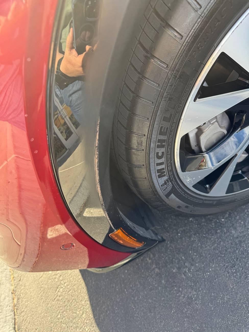

Suggestions on how to repair at reasonable cost?
Ford Mustang Mach-E Repair wheel well trim? IMG_4528

Low cost, minimal skill…
Gloss Black paint pen on the bare spots and polishing compound to enhance the dull area.

Any recommended sources of gloss black paint pens and a polishing compound?

There are lots of brands.
You could try to find a true touchup paint from the dealer or through someone like Dr Colorchip.
Most autoparts stores have touchup paint as well like Rustoleum or Dupli-Color.

hard to tell from the photo, but I would try polishing it out

Just in case. A new one is
< $150
https://www.superfordparts.com/oem-parts/ford-wheel-opening-molding-lj8z16039aa
Or < $350 at ford.
https://www.superfordparts.com/oem-parts/ford-molding-lj8z16039cb
Depending on which one is the correct color. Maybe use your vin.
Be aware the $150 is primed not painted and is for the select.
The other for ~$350 is the correct off the shelf, only for a Premium. They paint over the pillar black (whatever damn color that actually is that doesn't have a paint code) for GT's
Polishing I use https://www.amazon.com/dp/B07HFF4XJ2 It breaks down fast so it' doesn't cut well, but it's really hard to over cut with this.
I tried with the dealer for about 30 minutes hunting for the paint code for this. There isn't one that he could find.
