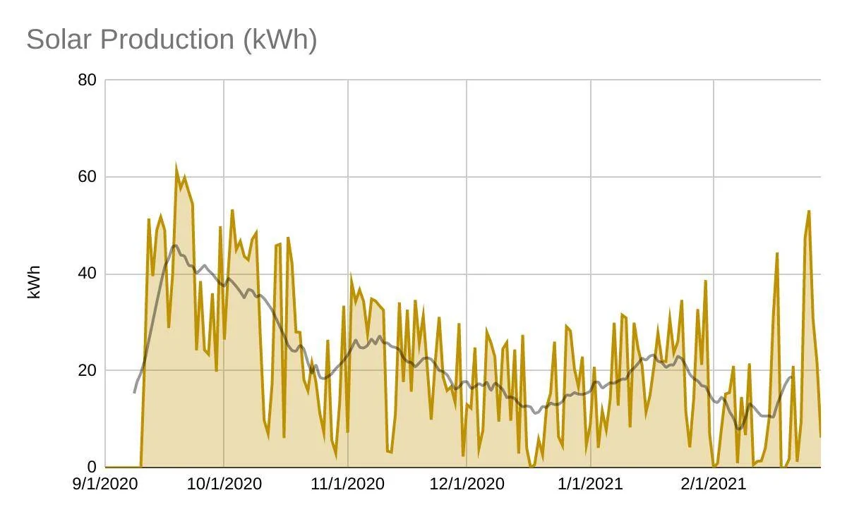

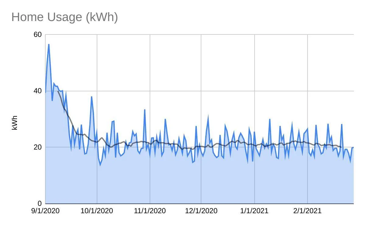

I ended up using Tesla personally. After that derecho that moved through our area last summer that knocked out our neighborhood in some places for a week I started looking at getting a whole home generator. To get an appropriately sized one that ran on propane was between $5-10k. Then I read an article that Tesla had recently dropped their prices and guaranteed to match any competitor.
What I really liked about their approach was that it was totally transparent. I put in my address and existing yearly average electric bill and they made a suggested size. You can tweak the solar and battery backup sizing and see the pricing change on exactly what you're going to pay. I ended up going with a 12.24 kW system and 2 Powerwalls (27 kWh backup). That was estimated to meet about 120% of our annual usage.
The process was pretty simple all-in-all. I signed up in June with the $100 deposit. They sent a panel layout on my roof about a week later including the intended inverter and panels. They took care of all the permitting with the township and utility company which took about 3 months from deposit to install.
When I got the system design, I realized that the gateway they use has three internal double pole breaker spots which would have been totally filled up between my inverter and two Powerwalls. I knew that they were going to install this in my garage and that I was going to get an MME and that wouldn't leave me with any spares. I called the install team and asked for them to install a sub-panel in my garage instead of using the gateway's slots and couched it as "in case I want to add more Powerwalls in the future". They said no problem and changed my design and didn't add anything to the install cost to add more hardware and labor. They even set up the gateway slots as non-backed up spots with a 100 A breaker, also at no additional charge.
On install day, they showed up with 7 trucks/cars worth of people and had it all in place in one day by about 3 pm. It was super efficient. One team working on the inverters and ancillary electrical work and one team working on the panels.
I certainly would recommend them based on my experience for the communication, 100% remote design, ease of not needing to worry about anything, and 100% price transparency.
Some things to be aware of regardless of whichever solar company you use. Without a backup (like the Powerwalls) you will not have power in the event of a utility outage. The solar inverters sync with a grid source. When the power goes out, the Powerwalls automatically make a "micro-grid" for the inverters to follow.
Also, as mentioned before, go for the micro-inverters so that if there is an issue with any of your panels, it doesn't affect the rest of the string.
Lastly, check with your utility about their net metering and time of use policies. PECO had full net metering, so if I produce more than I use, I bank the kWh and can use it for future months (like in the winter) where I use more than I generate and I only pay (or get paid for) the annual difference. Although if you net generating more than you used in a year, they only pay you the generation rate which is less than the actual purchase rate. I also picked the batteries to allow for "time-shifting" of the power if PECO started charging time of use in the future (they don't now). That way I could use the battery power when the power is most expensive (and Tesla allows you to set all that scheduling up).
I personally also love the app and data that it tracks and offers. I certainly look at it every day, but that's just me. I'm sure most people would be fine with "set and forget".
I've only had the system running since September, but haven't had any issues and have been carefully tracking my usage to see what the pay-off period is. I'd be happy to answer any questions (or offer you my referral link to save $100 if you message me, but I don't want it to sound like I'm only recommending them for that).
For reference, here's my solar production and home usage graphs with a running average.
