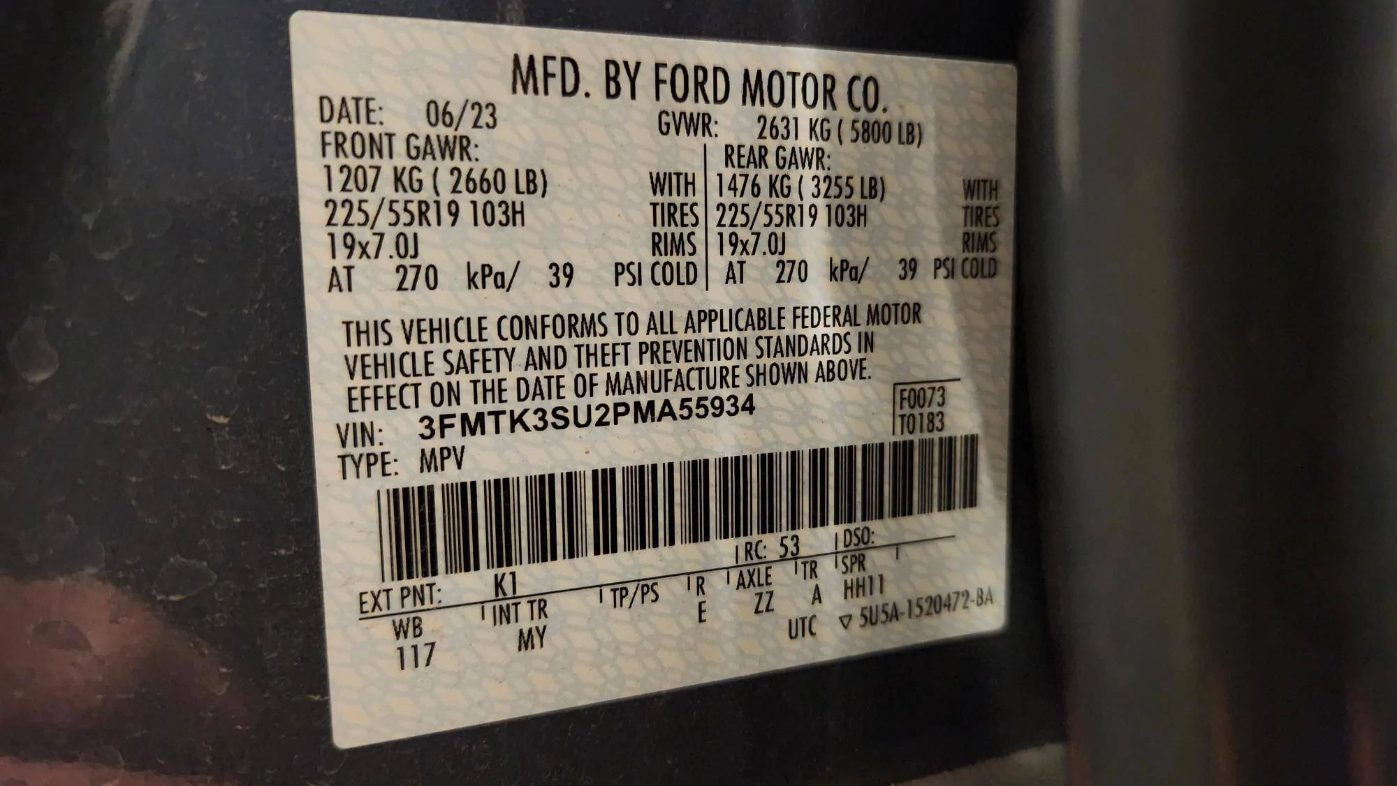

I have disconnected and reconnected the plug right under the second-row passenger side seat. I left it disconnected for 45 seconds. The harness runs out the back of the seat area and up into the seat back. The condition still remains unchanged. The light comes on with all the rest of the initial warning lamps as the vehicle powers up, then goes out for about 15-20 seconds, then comes back on. VIN attached.
