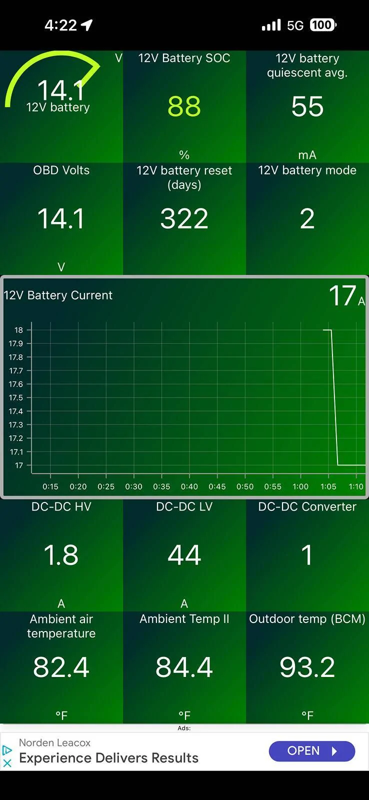

It really is not very useful to see the soc% for the 12v because "normal" use swings between 50%-80% dialy and it would just worry people.
what would be USEFUL is to see an indicator, or counter, showing when the 12v drops below 12.1 or 12.0..... this would give some indication that capacity has dropped to the point where the HV dc-dc had to come on to charge it.
