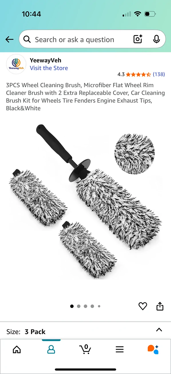

Thought I would share: these brushes on Amazon work fantastic for cleaning the inside barrels of our wheels. Especially with the small clearance around the brakes. Plus the heads are removable and can be washed with the rest of my towels. Less than $17 for the handle and 3 heads.
https://a.co/d/4tm8bDn
