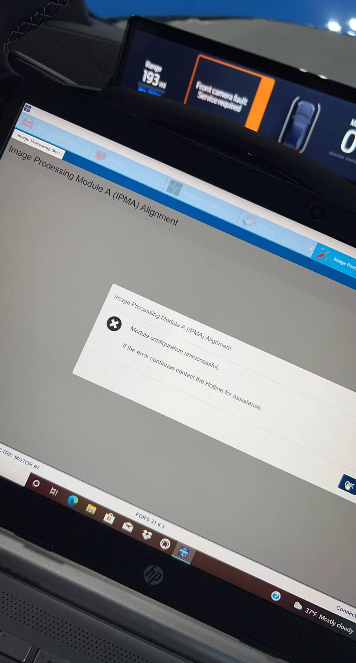

Can anyone help my to the next step? I’m getting so frustrated.
Ford Mustang Mach-E SERVICE FRONT CAMERA 038C2A6B-9A06-422C-A127-0434AF9F12ED
264
11,489
25,428
From TSB 22-2109:
1. Is only DTC U3000:49 present in the IPMA and does the vehicle also exhibit indications of a low battery voltage condition such as DTC U3003 present in other modules or an engine no crank/no start concern?
(1). Yes - this article does not apply. To clear the DTC, download and run the Reset the Image Processing Module A (IPMA) Learned Values application in Ford Diagnosis and Repair System (FDRS). Then run the Image Processing Module A (IPMA) Alignment application immediately after. The IPMA should not be replaced for this condition. Check for OASIS messages for low battery voltage and continue with diagnostics for low battery voltage.
(2). No - proceed to Step 2.
2. Are DTCs U2107:68 and/or U3000:89 present, and only after performing an IPMA self-test?
(1). Yes - this article does not apply. Clear the DTC and only perform diagnostics for U2107:68 and/or U3000:89 if these DTCs set outside of an IPMA self-test.
(2). No - proceed to Step 3.
NOTE: When performing the IPMA software update additional modules will receive software updates. Depending on vehicle features, the coordinated software update includes the IPMA, power steering control module (PSCM), cruise control module (CCM) and/or camera module - rear (CMR).
3. Reprogram the IPMA using the latest FDRS software level. Follow all on-screen instructions carefully to complete all coordinated module software updates.
4. Perform the FDRS Image Processing Module A (IPMA) Alignment procedure.
5. Perform the appropriate FDRS camera alignment procedure.
(1). For vehicles equipped with 360 degree cameras, perform the IPMA - 360 Degree View Camera Alignment procedure.
(2). For all other vehicles, perform the IPMA - Pro Trailer Backup Assist Camera Alignment procedure. This procedure should be performed on all vehicles without 360 degree cameras, even if the vehicle is not equipped with Pro Trailer Backing Assist™ (PTBA).
