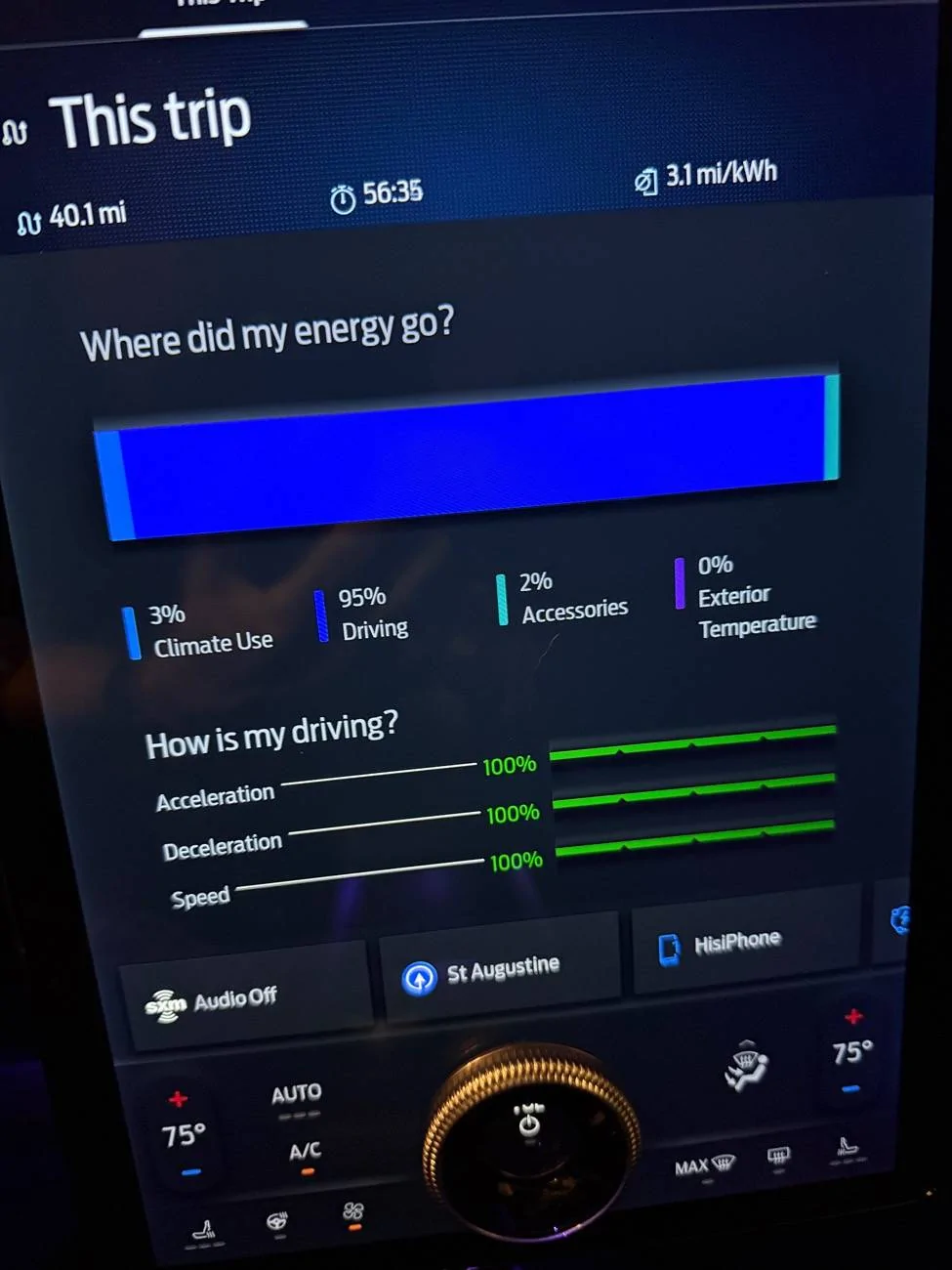

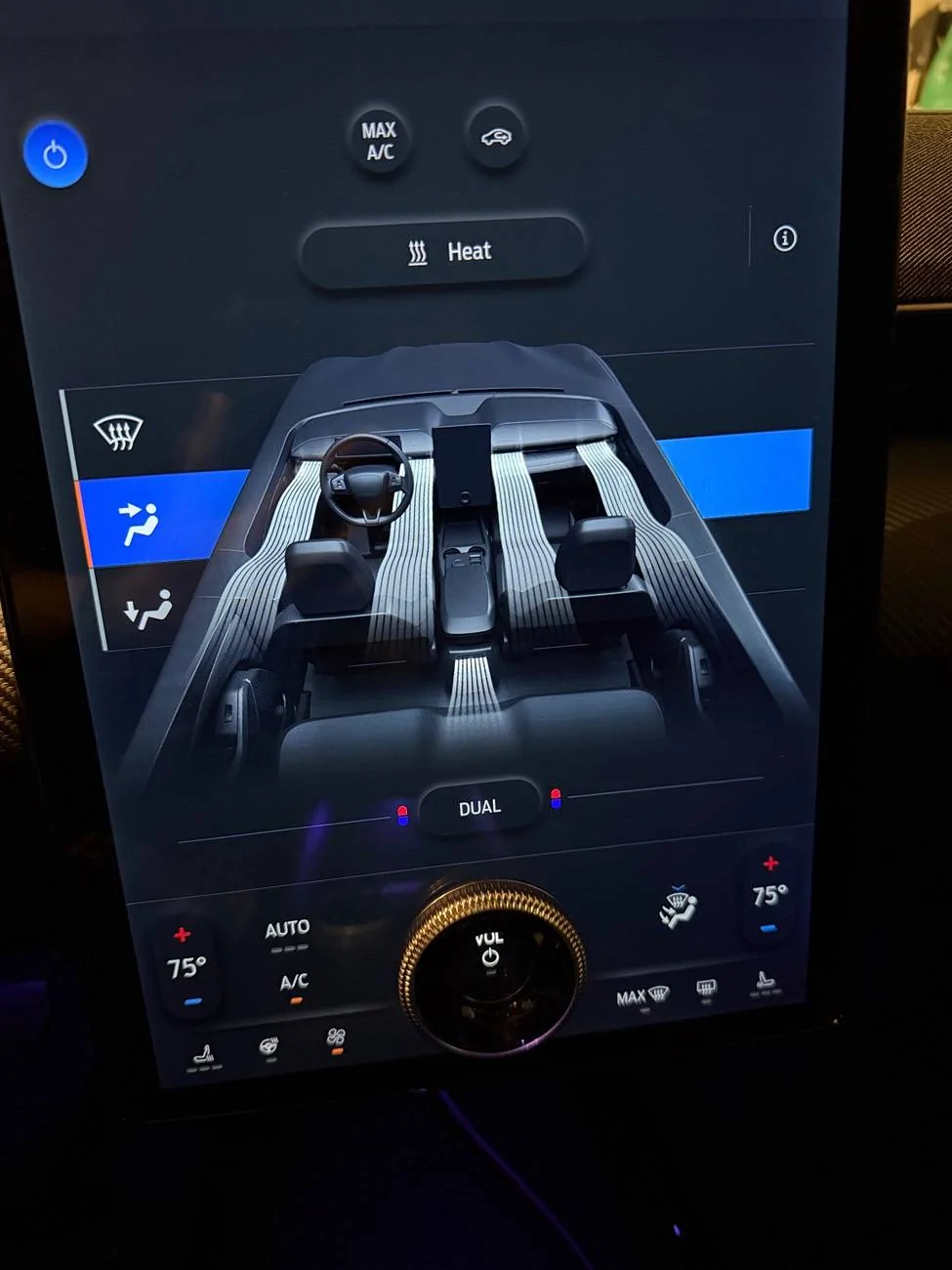

My logic was (in winter/spring) to use outside air, no heat settings. No forced settings or as few as the vehicle allows, IOW. My vehicle has options for auto control that vary by the temp settings with the above.
In the display it'll show green for AC cooling, red for heat as conditions change. The fan speed can be set to auto or varied "on the fly" by its soft-key. However, it's not easy to see what's going on and difficult to change. It's three button presses on AC and a button with adjustment for fan. CUMBERSOME.
Understand that this is different from older models. Not sure, but on hot days, the AC does come on and quickly cool the interior down in this above mode when I start from a hot interior, esp. with a window cracked open.
My default temp setting @75°. My energy (in Trip) yesterday shows 3% climate, 2% accessories. Will compare to recirculate settings first. Yesterday, during this trip, the outside temp was in the high 70's.

I would prefer full manual settings instead of this, semi-automatic type AND MUCH CLEARER indication of what's actually going on with AC/Heat/Fan.

What has been your energy use for the last some thousand miles?
And you had that number of percent, with HEAT and AC disabled? I wonder where the power went!
I like keeping the heater enabled if the outside temp is below about 55F. Call me a thin skinned californian.
Sally's Own
Henry
Apr 3, 2025
Saint Augustine, FL
Mach-e 2024
Hey B,
Based on trips my results run average about 3.3mi/kWh over 3400 mi and 3mo time, since breaking in. Typical long trips are 50-60m, short vary from 10-25m.
