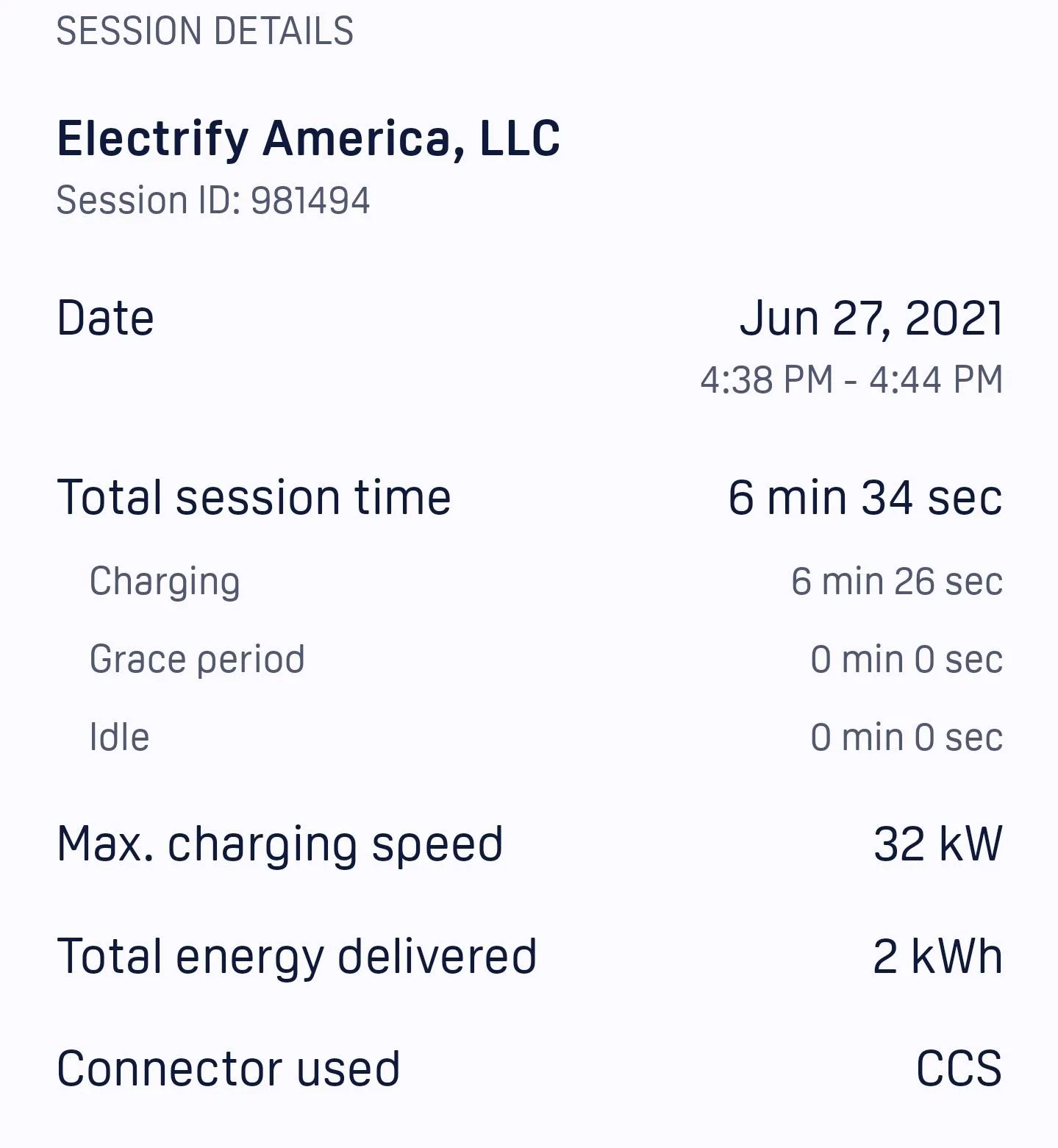

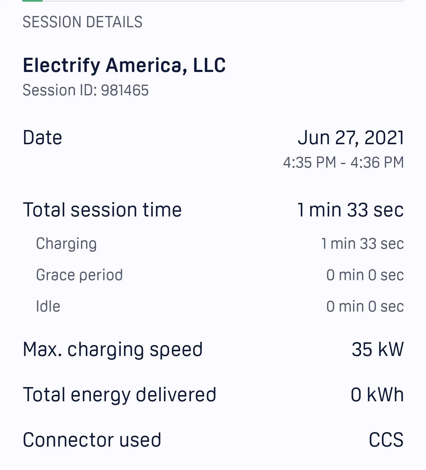

My next stop was at an EA station. This site had 4 terminals, and tried 3 of the 4. All 3 wouldn't go over 40kwh. The 3rd I finally tried to use Plug & Charge and got the same result. With plug and charge it actually started at 20kwh, then hit 108kwh, then dropped back to 32kwh. And then Ford charged me $0.04 for using my free kwh.

I haven't seen charging speed issues like this since the day I took delivery of my car. That day the temps outside were basically zero outside. Sunday I believe the temp was in the mid 80's so not super hot out. The first charge stop was before getting on the highway so nothing should have been heated up from driving. I used OBD to check temps and the car was reporting the coolant temps were like 58 degrees. It really appeared that the car was telling the stations it was only capable of like 40kwh. EA only charged me at $0.16/min because the car reported such a low speed.
