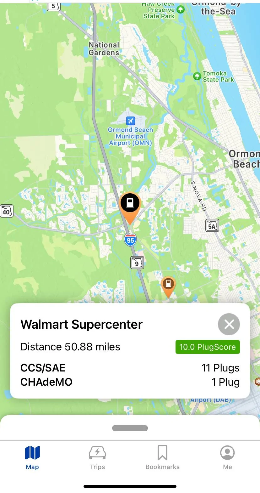

It looks like this station cluster has a high PlugShare score, so I am prepared to accept that this is some kind of FordPass issue. But that still doesn’t really excuse EA overcharging by a huge amount, or the EA app also apparently bombing out early while the car was still charging.
Go by the reviews not just the score, but like @voxel said this station can be flaky. I've had some EA credits leftover and I haven't bothered going up this way just cause it's an older station, and have ended up just charging at one of the two DCFC near the Speedway.
This ^^
I ignore the score. I read the current reviews.

The scores are worthless. You need to read the check-ins to get the real scoop. The scoring options for the users are, basically, “I charged“ or ”I didn’t charge,” or pass/fail. From there they assign a number score from 1 to 10. A lot of shaky stations have high 9’s or 10’s because of the dearth of scoring options.
Also some reason people rate that they charged but then rant about how the station didn’t work lol, gotta do the stupidity factor
