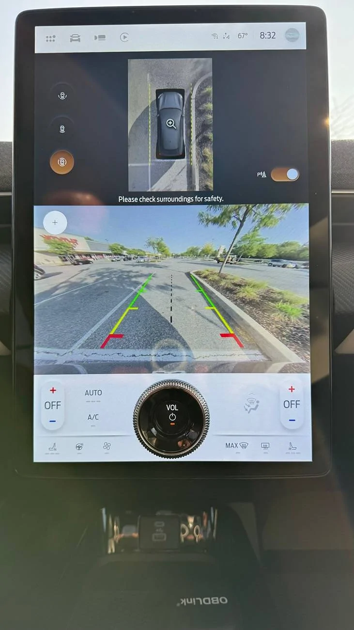

SOLVED What is this symbol on rearview camera?

The red circle was added by me to highlight what I was talking about. I will have to drown my no warranty, totaled Mach E sorrows with some two buck chuck, or ogling the yummy mummies at TJs.
Too much of either of those options could be problematic. ?. It will be interesting to learn which feature enable caused the hand. I’m sure you’ll get it sorted out.

Did you try tapping on it?
Tapping, poking, vaguely threatening language, threats to ground it. Nothing worked. I'm sure I just flicked on something in Forscan that did it, I will let everyone know what it was. I find it kind of funny.

From the Lightning forum ....
Ford Mustang Mach-E SOLVED What is this symbol on rearview camera? {filename}
Thanks, that explains which Forscan feature I ticked on. I dont think I will be coupling with any trailers in my MME!

Ok, the P Hand went away when I disabled "Park Hold / Hitch Improvement Feature" in the APIM. Thanks all for an entertaining thread!
So am I reading correctly, on mache s this function is NOT enabled unless you turn it on? As I've never seen on the two maches I've owned
That's right. I guess the hand is a sign to stop tinkering.
