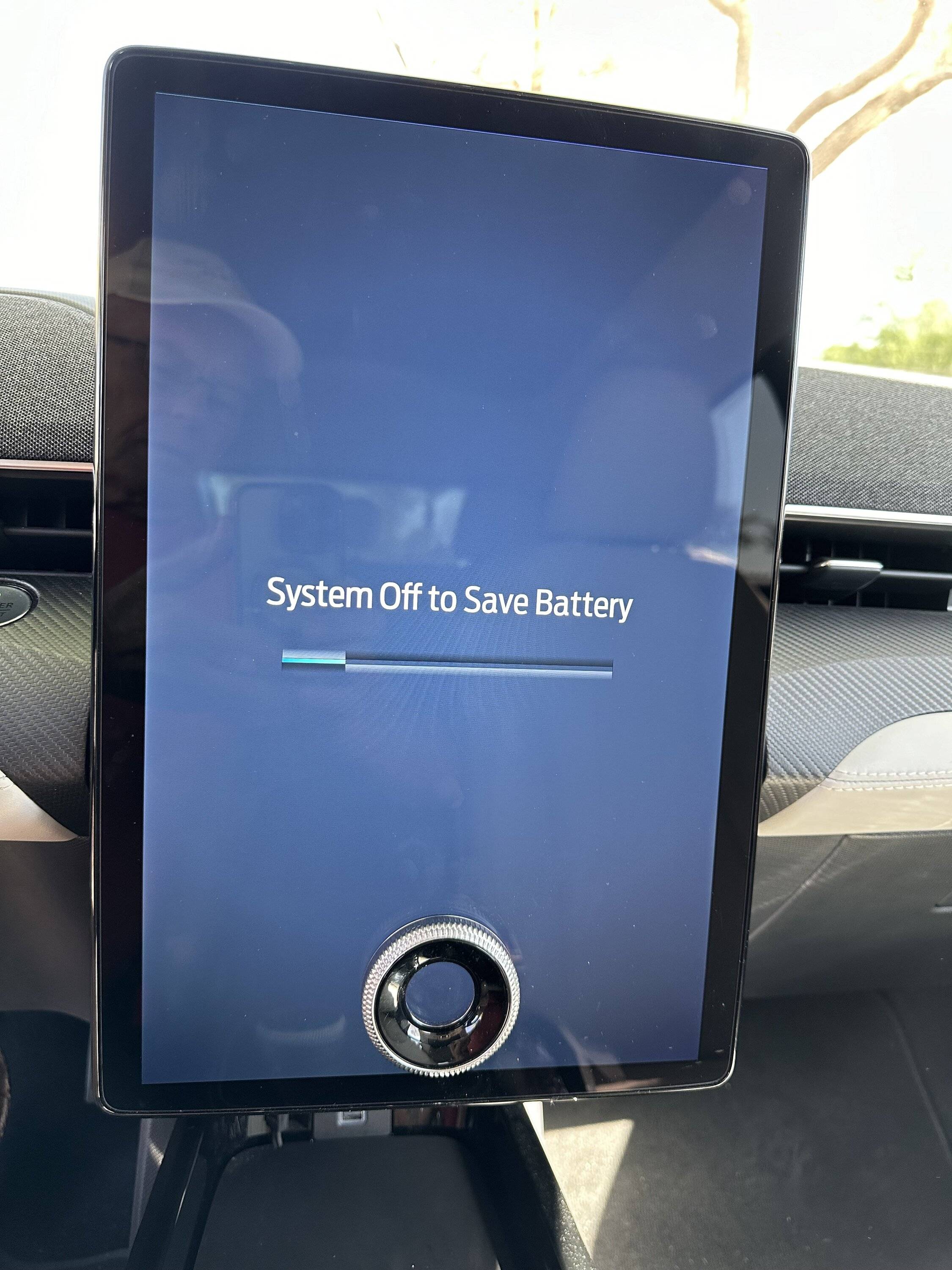

Have been greeted with this notification twice in the last couple of days. Shows up when I try to start the car. Car starts fine and the screen opens after progress bar finishes. Anyone know what it means?
I've exited the vehicle without shutting it off before and come back to this message.
Don't use accessory mode (power light flashing) because it can drain the battery and cause that message, just like on an ICE vehicle. 12V is not being charged in accessory mode.
