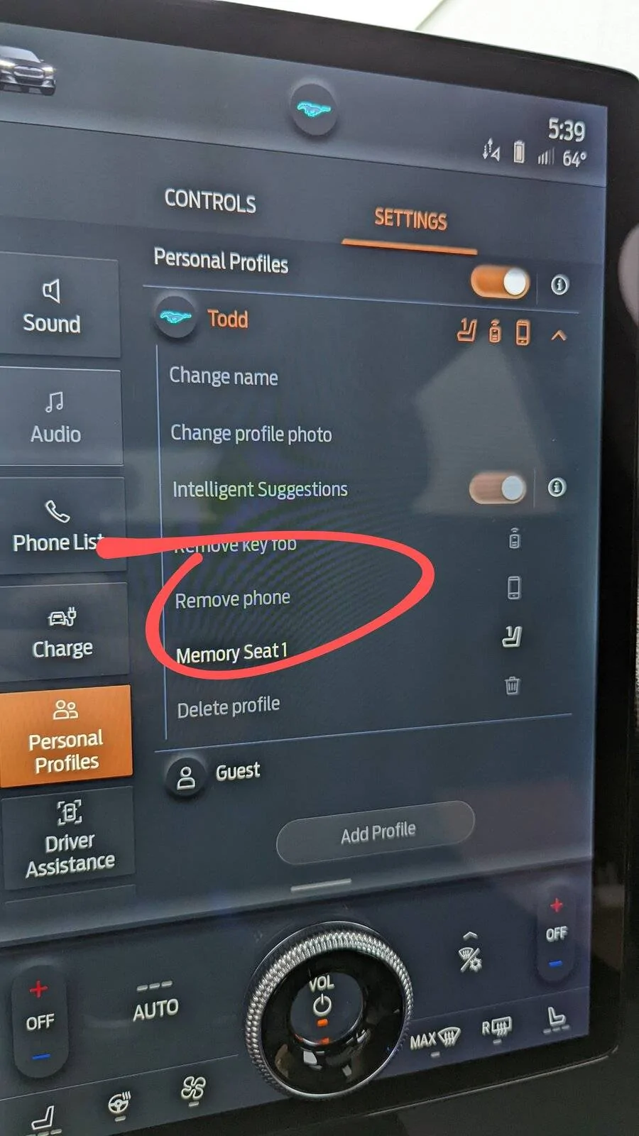

Whenever I go to start my MME from my phone it will automatically set it to "Guest" profile and not my own personalized one. Each time I get into the car I have to manually select my profile. How can I get it to go directly to my profile setting when starting from my phone?
Just to make sure... Have you added your phone to your profile?
