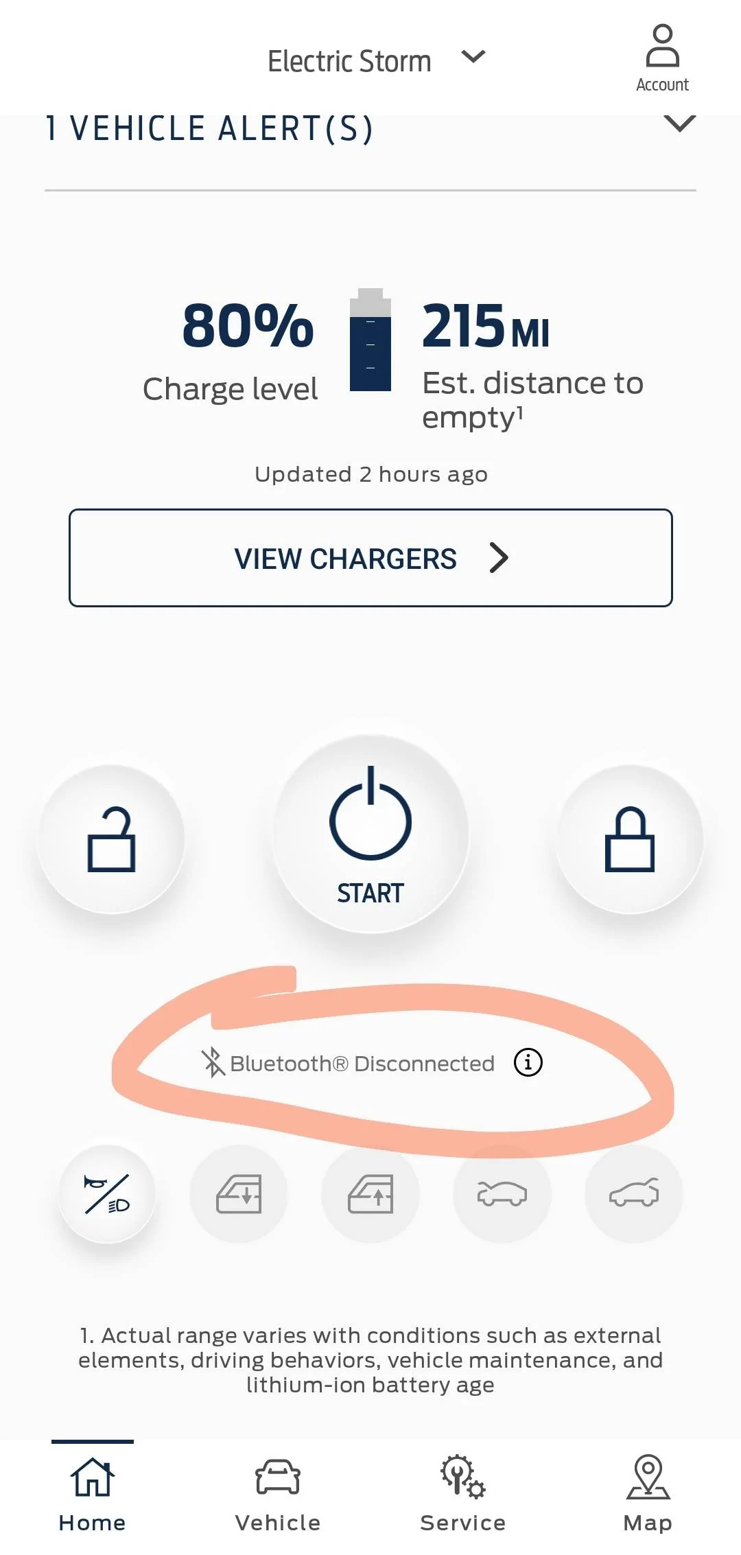

So the trick is there are 2 bluetooth connections. One is for sync, one is for the key. The one in your screenshot is for sync. The one for the key isn 't visible in the BT menu on Samsung phones.
The only way to tell it's connected is in the FordPass app. The text under the lock/unlock/start buttons that will say "Bluetooth Connected"
Mine says disconnected currently as I'm not by my vehicle

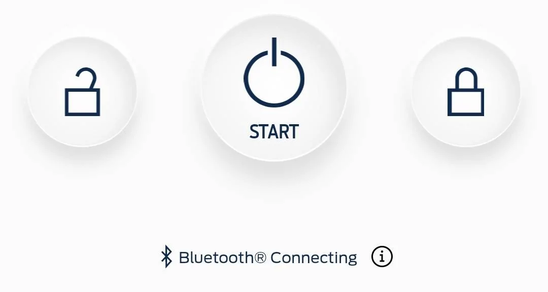

Stuck at connecting

So I drove home with the fob. Fordpass still showing bluetooth connecting....
