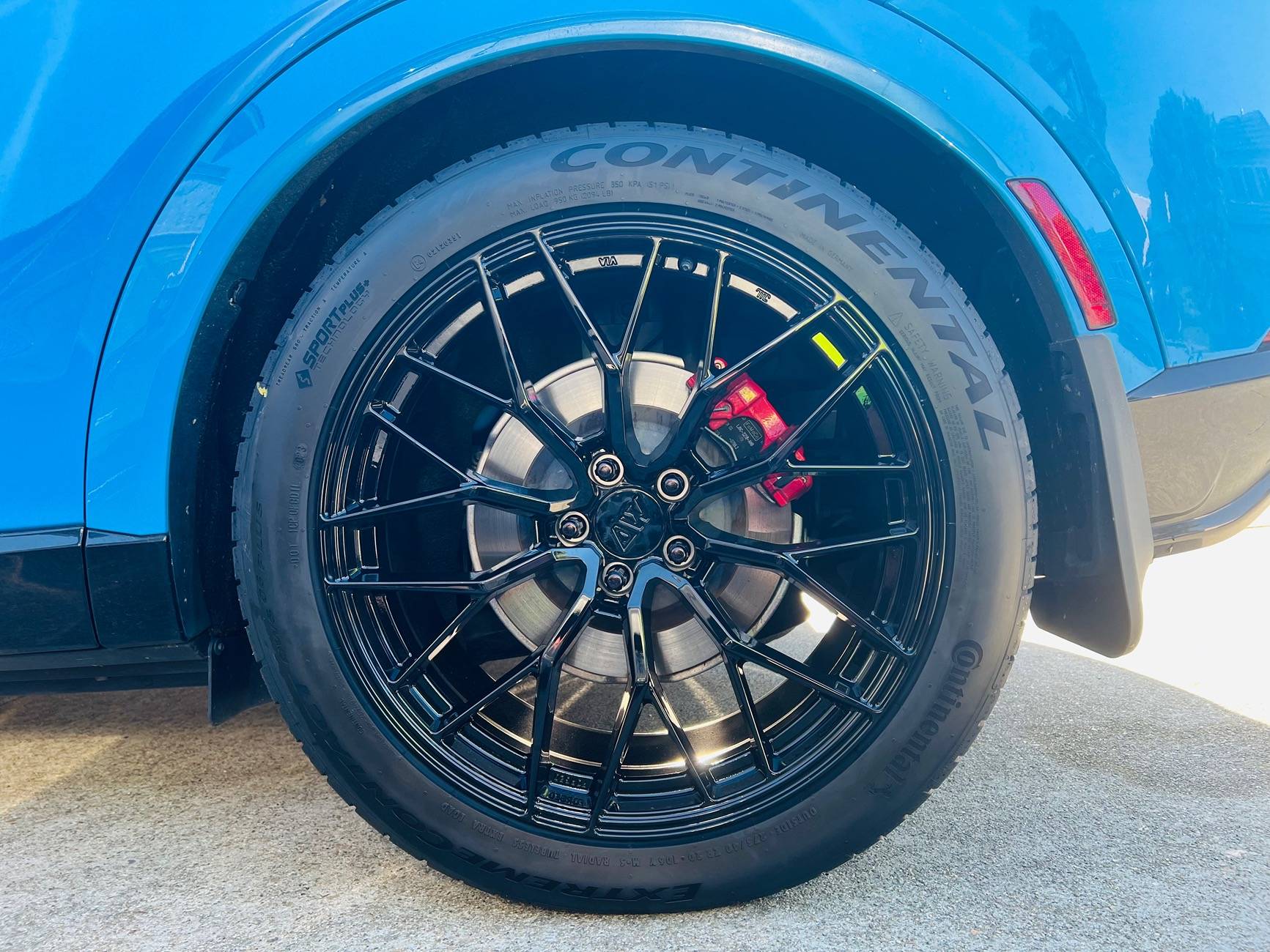

At +35, my tire will going to be poking out from the fender lip molding? If yes then I would be more concerned with the outer sidewall contacting the fender lip molding when going over a dip or large bump in the road.
13,018
17,559
Here is the spec on my custom wheels: ??
Ford Mustang Mach-E Stuffing 275's into a GTPE (square setup) IMG_4170

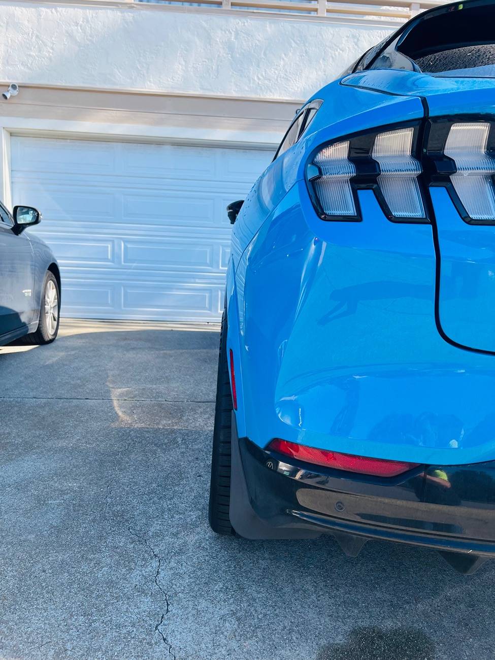

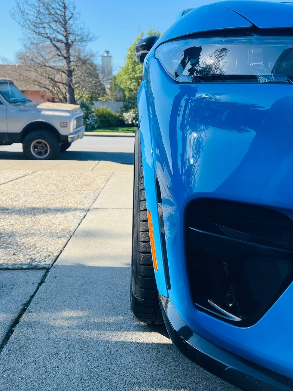

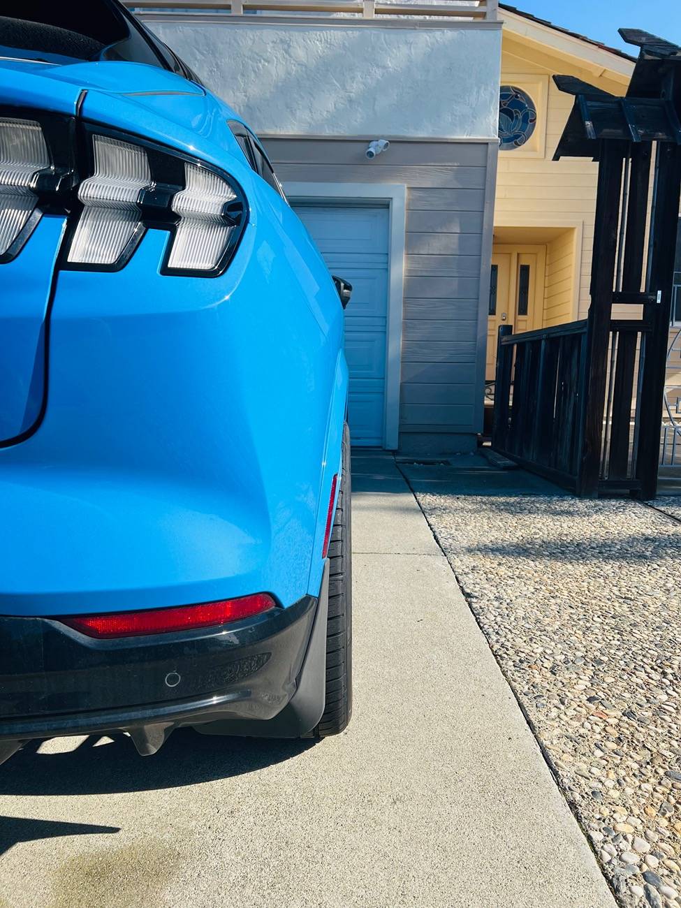

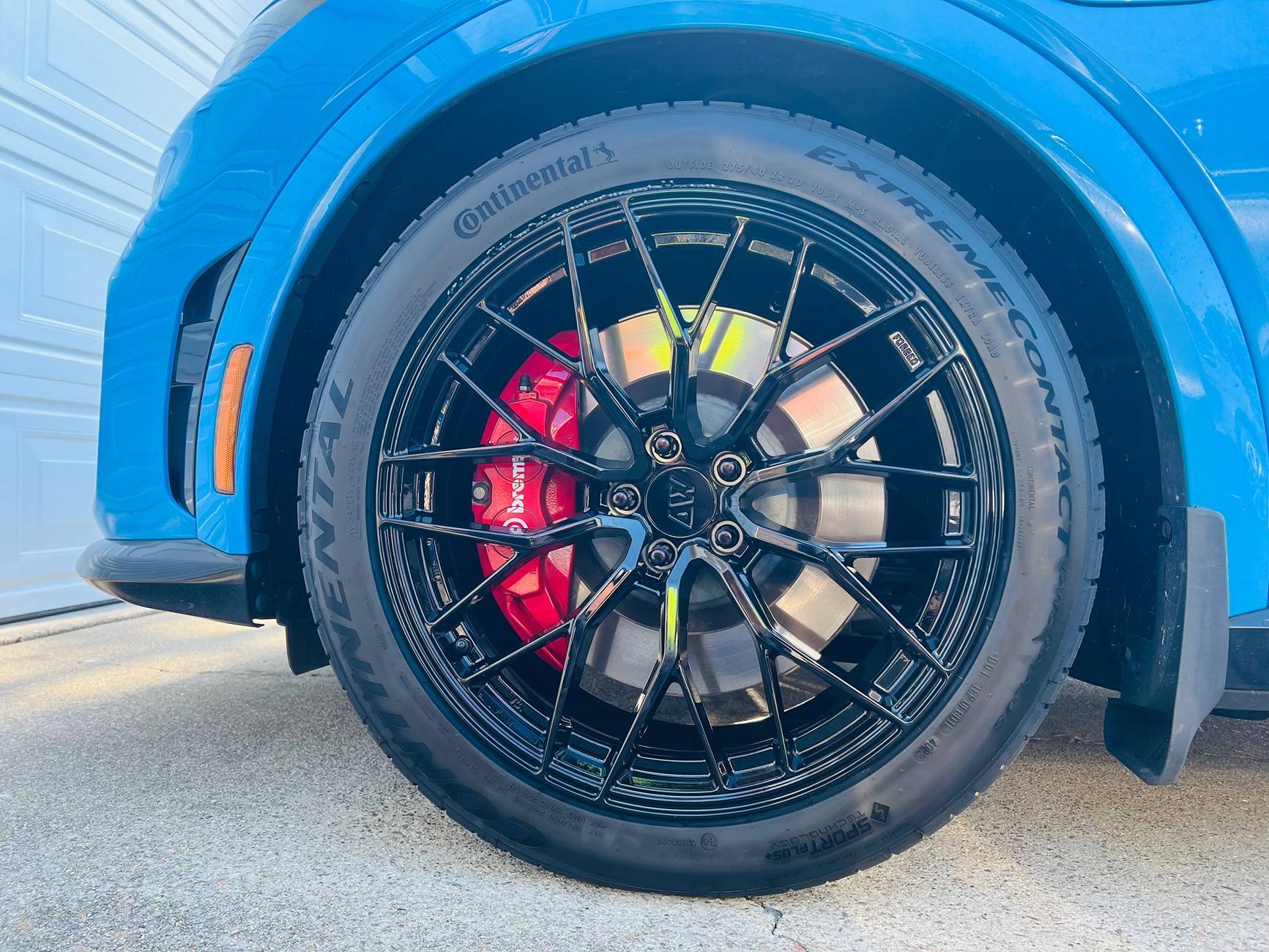

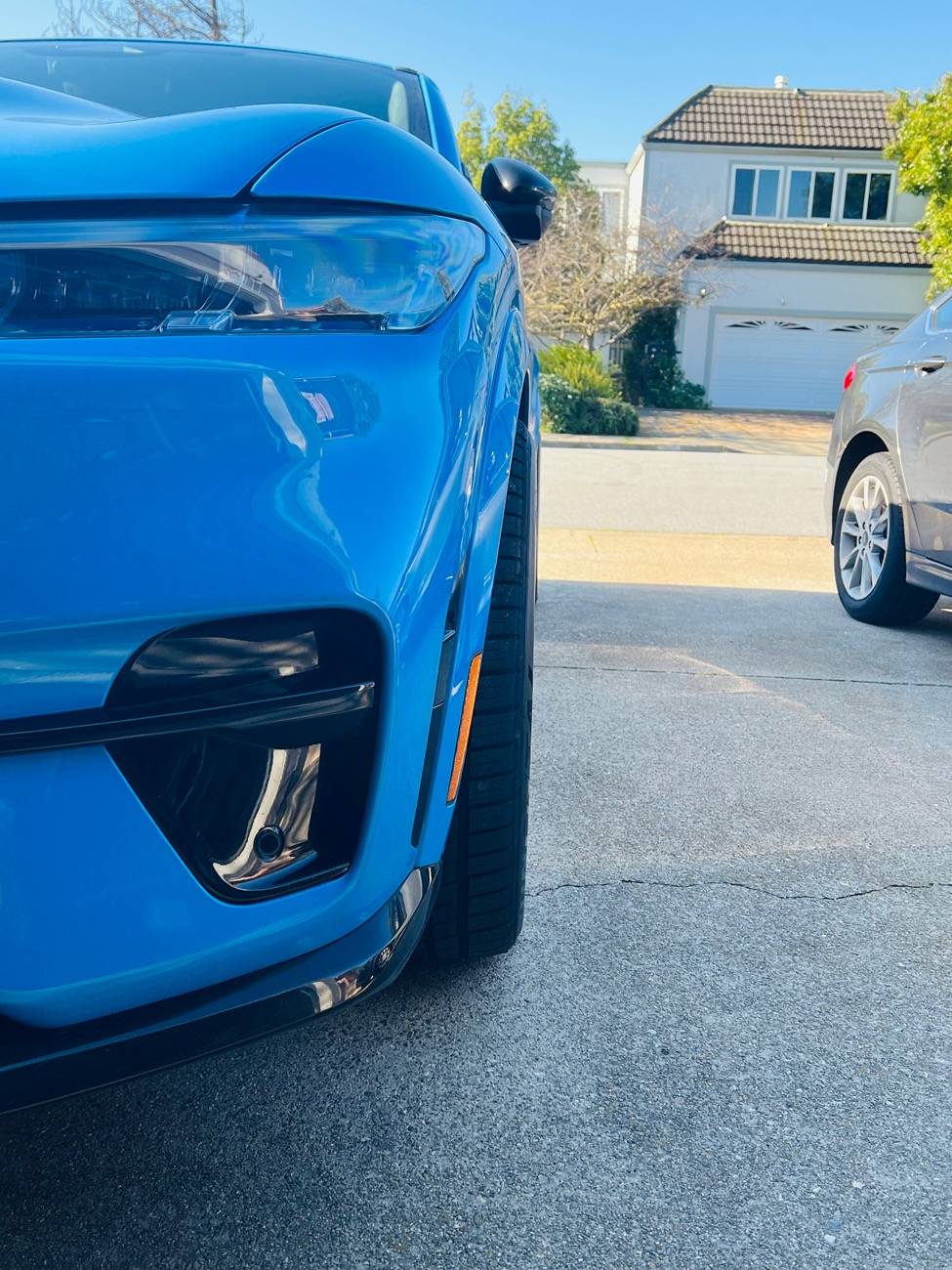

This is what they look like and how far they are proud of the fenders: ??
Ford Mustang Mach-E Stuffing 275's into a GTPE (square setup) IMG_4166
Ford Mustang Mach-E Stuffing 275's into a GTPE (square setup) IMG_4167
Ford Mustang Mach-E Stuffing 275's into a GTPE (square setup) IMG_4164
Ford Mustang Mach-E Stuffing 275's into a GTPE (square setup) IMG_4162
Ford Mustang Mach-E Stuffing 275's into a GTPE (square setup) IMG_4163
Ford Mustang Mach-E Stuffing 275's into a GTPE (square setup) IMG_4161
Much more negative aftermarket offset will not fit unless the fenders are flared. ??
I've had no issues with ET35, and my tires (General GMax RS's) have quite a square profile.
