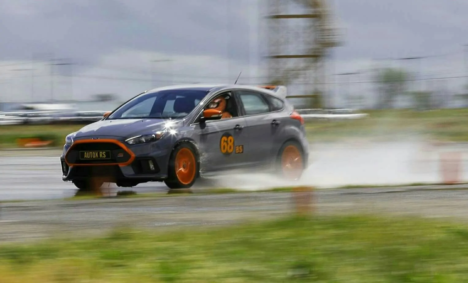

No tire rub, period. I took one corner in the mountains, going downhill at the time, that was labeled as "30 mph". I took it at 62 mph, and got just a tiny amount of tire scrub on the fronts. Gradually accelerating took the tire sob away. All noises were from tire slippage...NO tire rub on any body panels. Note to readers: DON'T try this yourself...I have many years of race experience.
