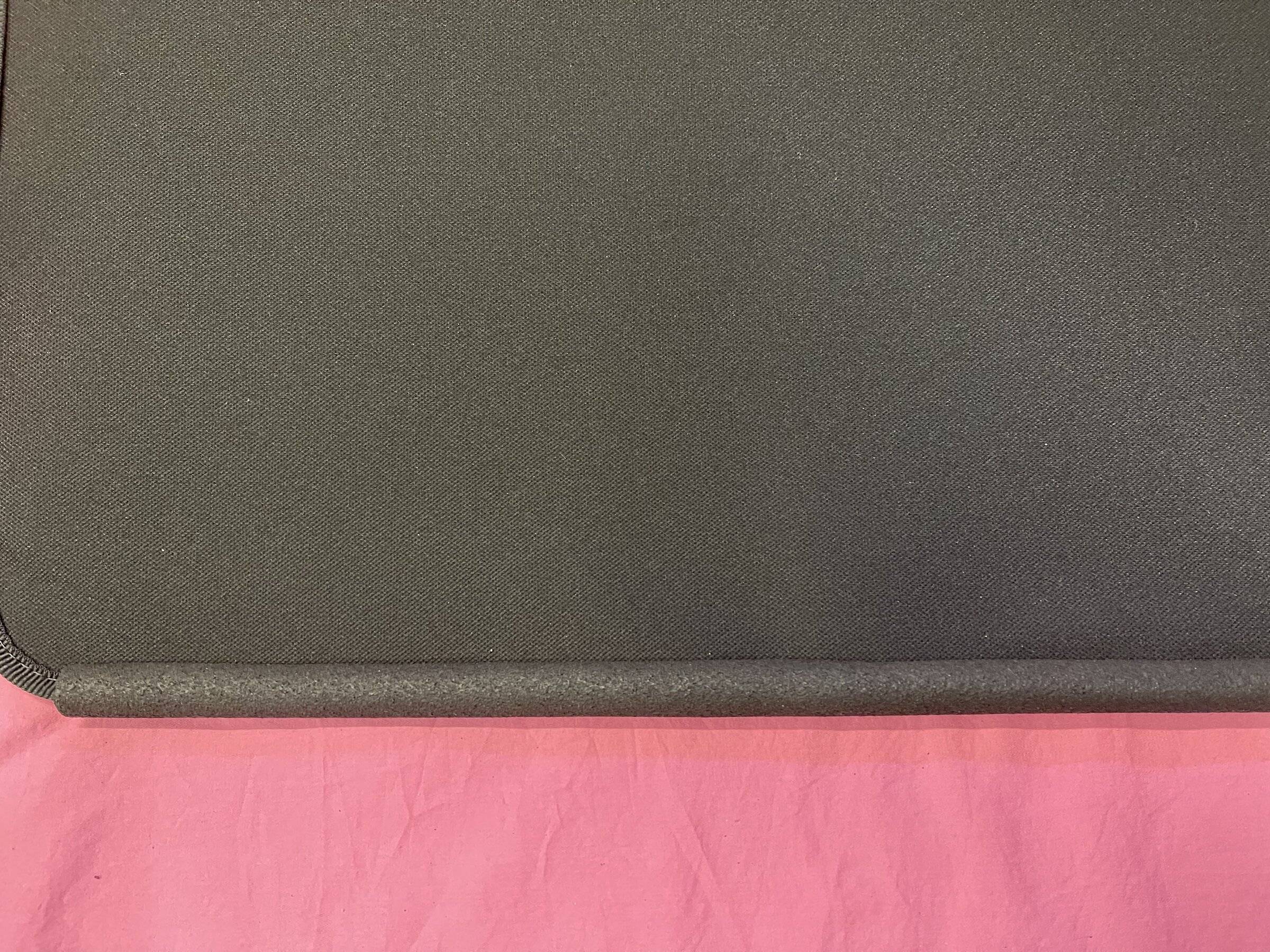

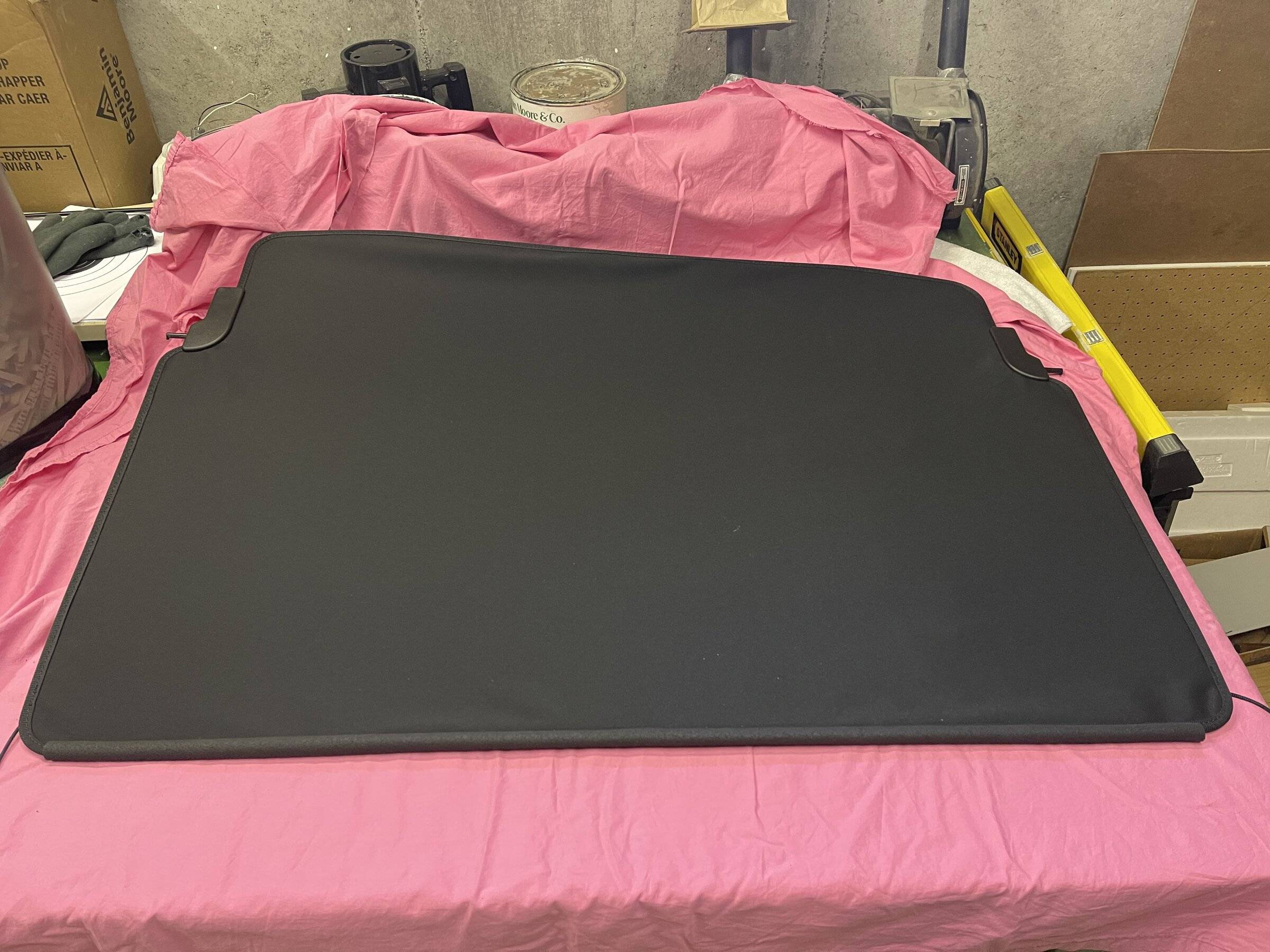

Thank you!!! This has been driving me nuts as I often have the windows rolled down. I was starting to think of elastic or something like that...but I did not like any solution. Your "life hack" did the trick!
In my case, I could not find any soaker hose (without purchase of a 50' hose) so I purchased a 3/8" fuel line and a 1/8" metal rod. It seems to have given enough heft to the cover to keep it from flopping around.

I found a pretty good solution to fix the Mach E cargo cover flapping in the wind when the windows are open:
  • I used soaker hose (regular garden soaker hose, black, outside diameter 1/2”)
  • Slice the hose down one side and slide it over the front edge of the cargo cover .
  • After it was on the cargo cover I slid a piece of 1/8” steel rod inside it to give it a little extra weight. It’s enough weight to keep the from edge down so the wind doesn’t get under it.
  • Had all the windows open at 65mph and the cover didn’t move
Awesome idea! Found this after the first day of driving my MME with the windows down and being unbelievably distracted by the flapping privacy screen. Stopped at the hardware store on the way home, got the supplies and installed this fix in less than 15 minutes. Worked perfectly and barely noticeable. Great idea!

I made a weighted edge to the front edge of the cover (a slit black fuel line and a steel rod). This stopped it from flapping all the way to highway speed, but I discovered that the cars range is dramatically lower with the window(s) open. than running the AC.
So now I use the flapping cover as my warning. When the cover is flapping, I roll up the windows.
I no longer use the weight.
