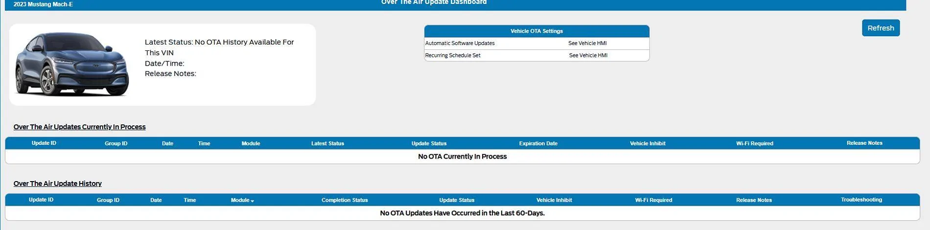

OTA history does not show any updates have been sent to the car recently. Your car is already on the latest Sync version and shows very little pending updates.
Ford Mustang Mach-E Sync Update: How do I know it happened? 1742074077178-sm
Glad to hear BC is working because I see nothing wrong with your car at all.
