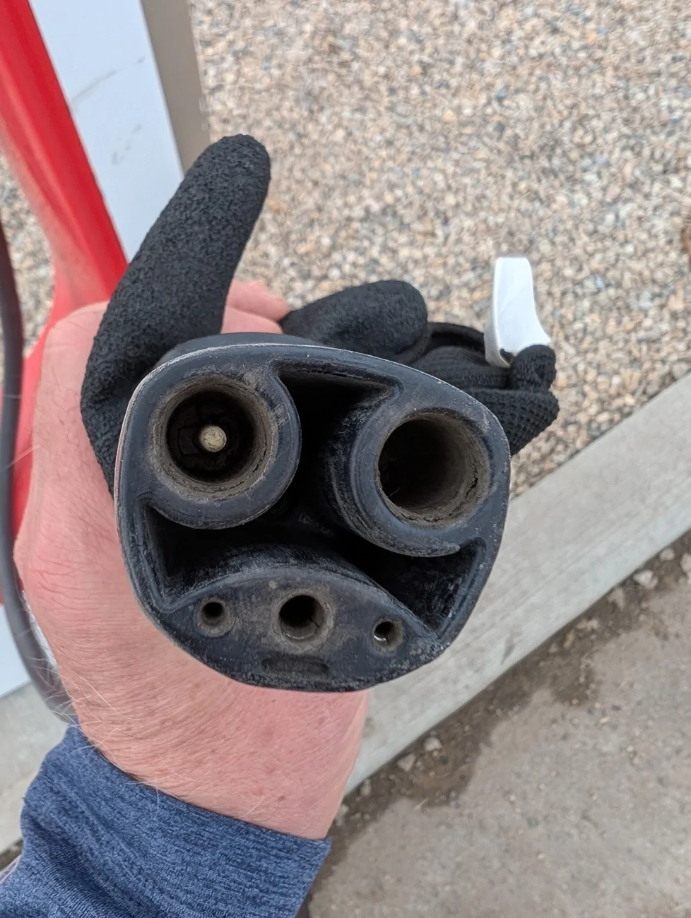

Just returned from a 5,419 mile trip in the Lightning. 99.9% of fast charging was with Tesla chargers. At one charger, I noticed the following:
Ford Mustang Mach-E Tesla Supercharger nozzles Tesla nozzl
I reported it to Tesla as a "missing pin".
Then, as I continued charging on the trip, I noticed that SOME locations had 2 pins, and SOME locations had no pins... And, these weren't V3 vs. V4. So, what's going on?

What I meant was, I used many V3 chargers, and I noticed that some had 2 pins and some had no pins.

The question is - should there be 2 pins, or no pins?
I noticed this nozzle had 1, so I didn't use it and reported it.
Then, I started looking at the next few and noticed some had 2 pins, and some had no pins...

Did the ones with no pins work?
267
17,926
27,921
Yes, every one worked.

Is it possible that those pins are AC and the three on the bottom are the DC pins? I don't know enough about the NACS pin layout, just thinking about how our DC pins are the 2 at the bottom, hence having to flip the little door down when fast charging.

The two big pins at the top carry power, either AC or DC. Without those pins, the charger can’t work.

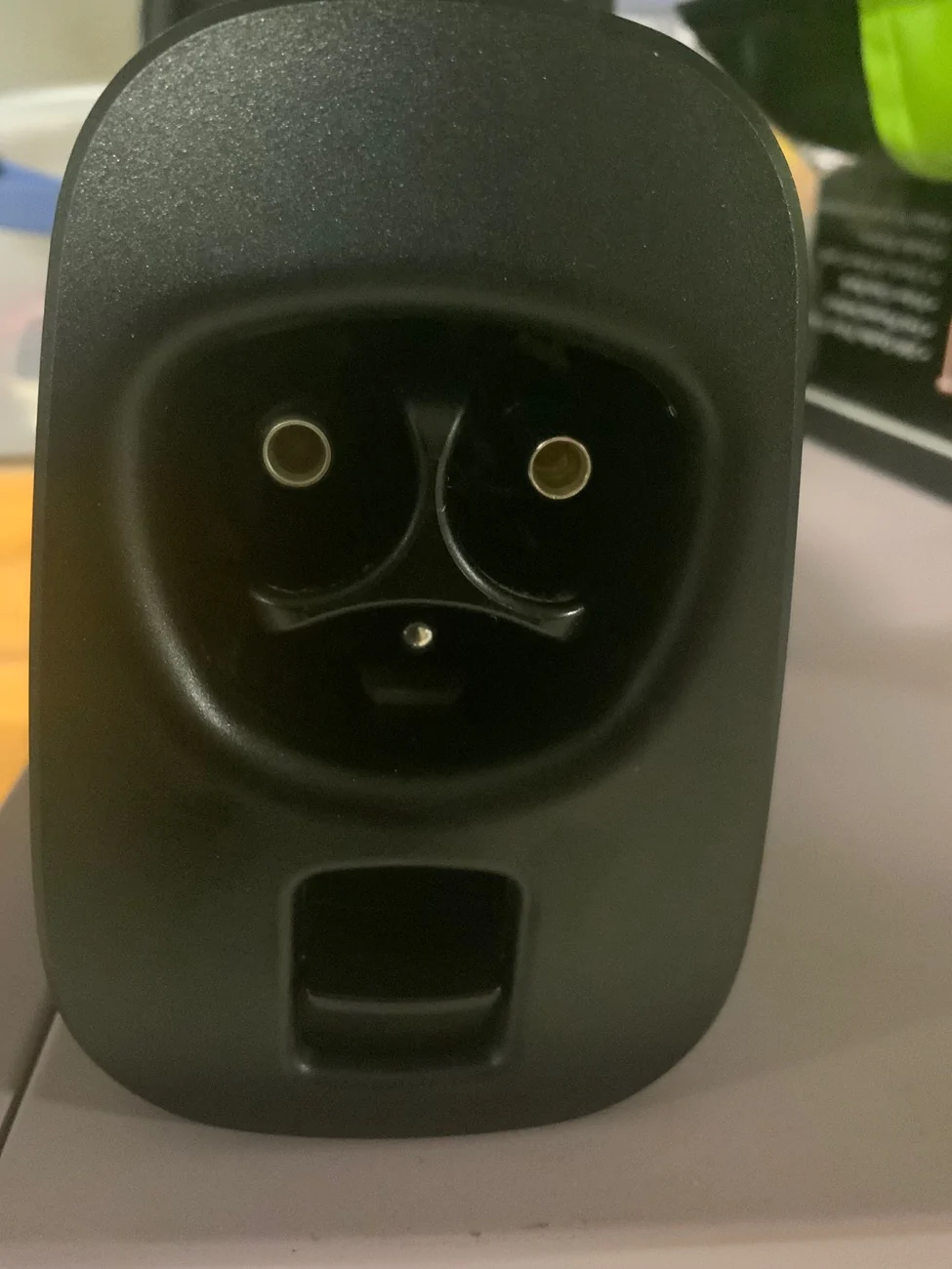

Those are just small guide pins, the receptacle has pins that mate to the outer part of that plug. Here are the pins in the adapter side:
Ford Mustang Mach-E Tesla Supercharger nozzles IMG_0035
