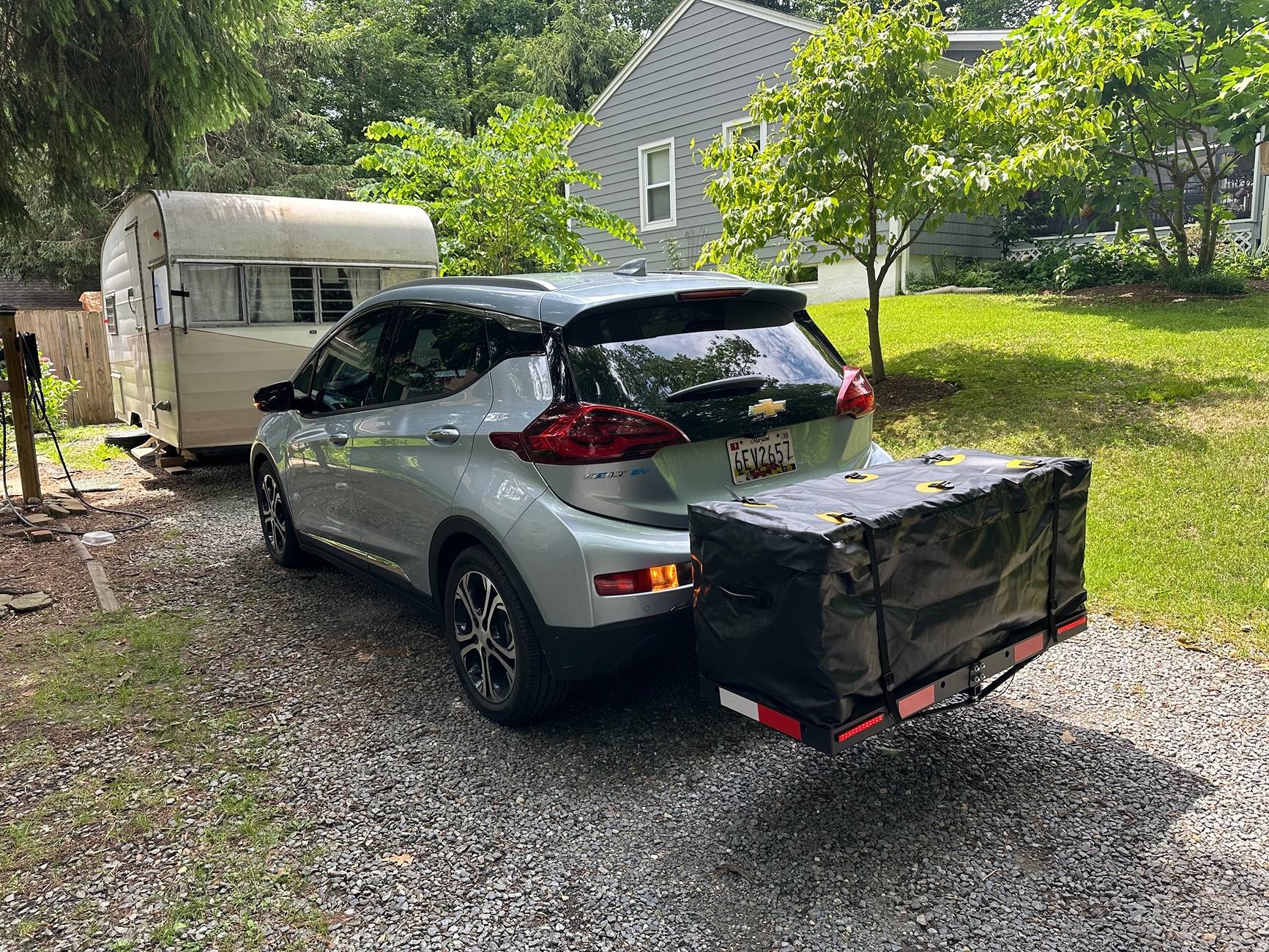

It won’t fit everyone’s needs, but whenever possible, I would recommend a hitch-mounted rack. You won’t add any noticeable wind noise and won’t have much impact on economy. You also aren’t adding any height, so you do t have to worry about ripping off your gear when you enter a garage or a drive-thru.
I have a 60”x20” rack that I use with the MME as well as my wife’s minivan. It can carry up to 500 pounds, but the real limiting factor is the hitch and the car itself. At 270 pounds, I can stand on the rack when it is on the MME. I never put that much weight on it, though. My rack came with a waterproof bag that is 60”x20” and about 28” tall. That puts it right around 20 cubic feet. I don’t have a pic of it on the MME yet, but here’s a pic of a slightly smaller rack/bag on my Bolt:
