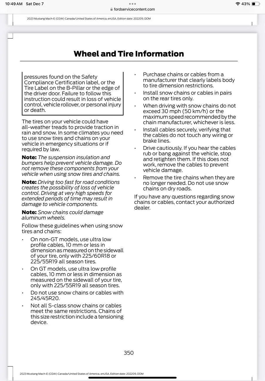

Hello
Sorry I still don't fully understand :)
So AWD, 4x4 with 19 wheels
Can I put a snow chain on it or not? (We go to Austria)
If it is possible, is it only on the back wheels? Or on all 4 wheels?

Peter, I am attaching a screen shot of one of the pages on snow tires/chains from the Ford USA on line manual for model year 2023. I would encourage you to consult the manual for your model year that is applicable to Mach E‘s sold in Hungary. It may vary from the US manual … or not.
The manual says on non-GT, i.e., Premium or Select, you may use low profile, 10mm or less measured at the sidewall, chains mounted on the OEM tire size and on the rear wheels only. (I am paraphrasing, this isn’t the exact wording, but it’s what the manual means.)
In addition to the Rud chains mentioned by Martin above, you might want to consider the König K Summit. I have a pair of those. Mine are branded Thule. König bought Thule’s chain business a few years ago. Same chain, new owner and brand name.
Of course you have to know and follow the applicable winter driving laws of Hungary, Austria and other countries you may drive in.
