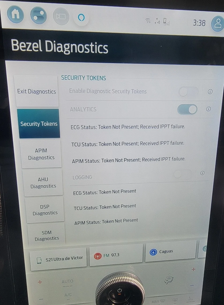

I would try to pull those fuses and reconnect them. You can keep the battery connected. On the infotainment screen, top right where you see the different signal bars. Are they showing the actual bars or is one crossed out showing no signal?

Question I forgot to ask, are you connected to WiFi at home? If so, how's the signal strength?
The "ecg status: token not present; received IPPT failure" error indicates your Mustang Mach-E's Gateway Module (ECG) has lost connectivity, causing an over-the-air update or vehicle diagnostics request to abort. It is often a temporary glitch, but it may require a quick system reset.
Let the car sleep: Go for a drive, park, turn the car off, and lock it. The modem may just need an ignition cycle to re-authenticate with the Ford servers.
Pull the modem fuse: If you are comfortable doing so, pull the fuse for the FordPass modem (typically Fuse 11 or a fuse in the passenger footwell, depending on your model year). Wait 10 to 15 minutes, plug the fuse back in, and let the vehicle reconnect.
Restart the FordPass app: Log out of the FordPass app, force-close it on your phone, restart your device, and log back in.
At the end of the day, your car is having issues connecting to the cell network in PR that is affricated with AT&T. Either the signal is too poor or slow that your cars modem drops it or it takes too long and it times out or the modem in the car is bad. I would recommend going somewhere that the signal is really good and test. If there is still issues, I would say the modems bad. Based on the google machine, Ford doesn't honor US warranty in PR so you would be out of pocket for the modem and labor.

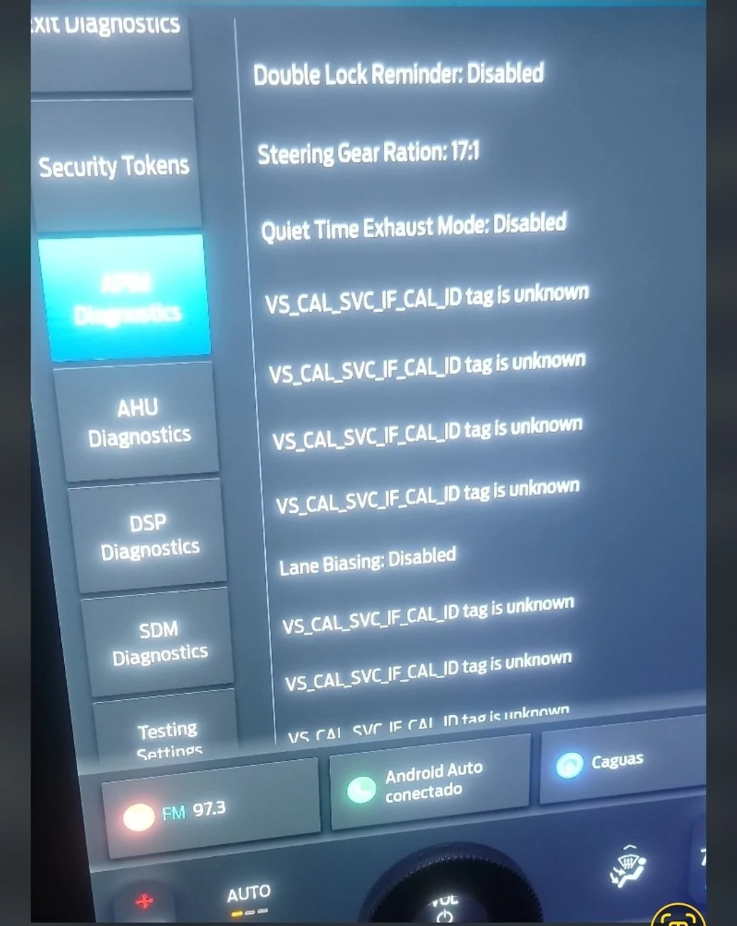

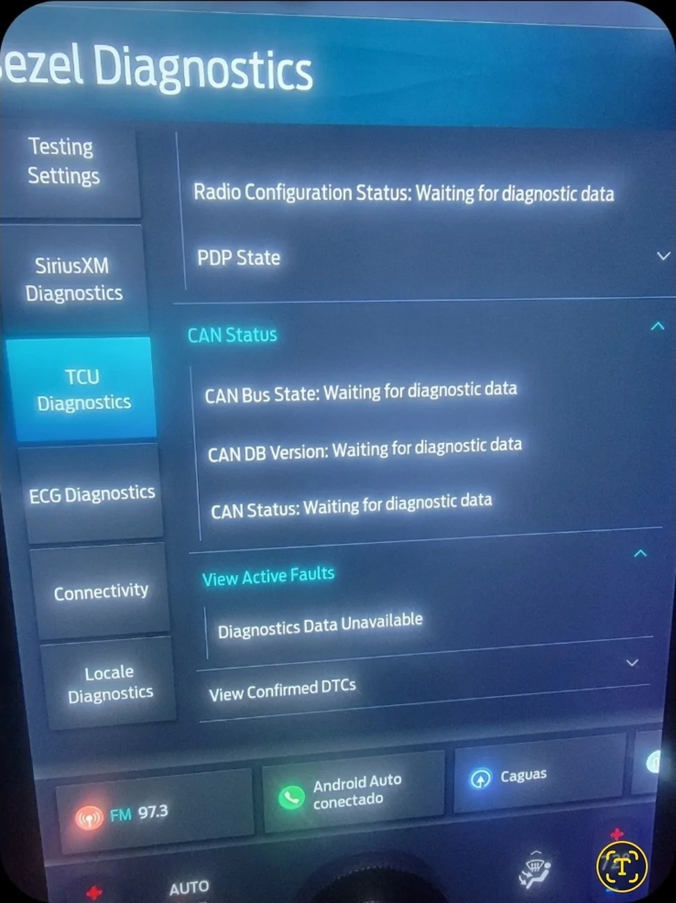

The car is connected to the house Wi-Fi; I have a speed of 300 Mbps and it's very close to the router, so it shouldn't be a connection problem. I removed the fuses, disconnected the battery for over an hour, replaced the fuses, reconnected the battery, and the problem persists. apim is also wrong.
