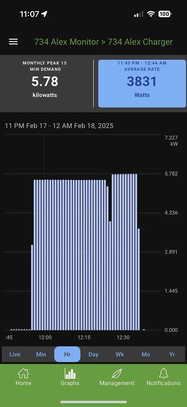

Check this out. It was -20C all week while I was of in Japan skiing. The MachE was plugged in to an Emporia charger inside an unheated garage. Departure times were all turned off, and the emporia schedule just had its “turn on 45 minutes after sunrise” schedule (so was always offering power).
It seems everyday just before midnight the MachE decided to top itself up. Is this a known schedule?
Ford Mustang Mach-E Topping itself up at midnight? IMG_3818

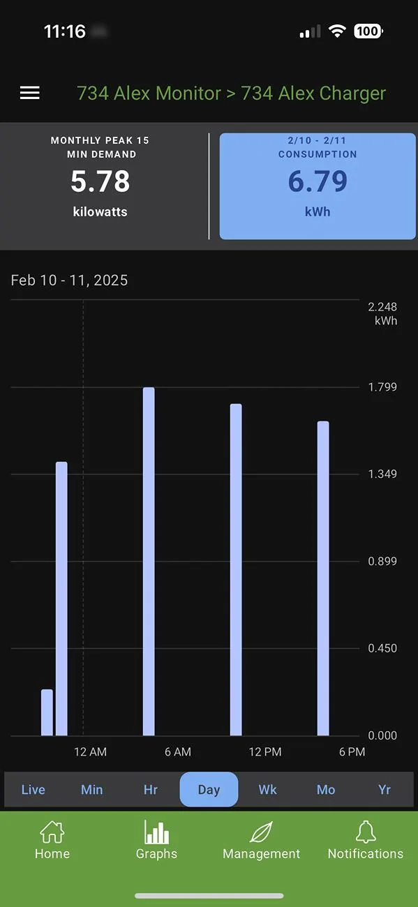

actually when it was even colder it looks like it was grabbing some energy every six hours.
Ford Mustang Mach-E Topping itself up at midnight? IMG_3819
Added up to 29kw/week. That’s $5/week! Not a lot of money, but I wouldn’t leave my ice car plugged into a block heater while away on vacation. Maybe next time I vacation in winter I’ll unplug the car before getting on the plane.
