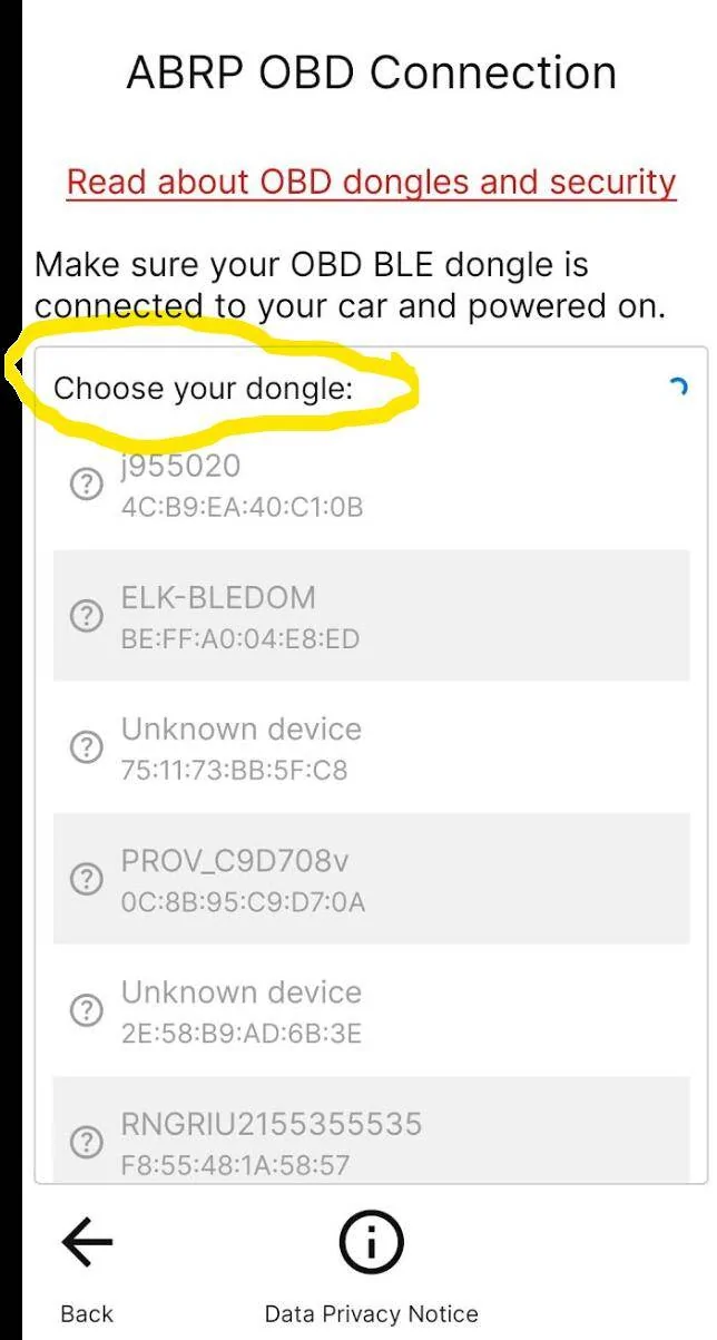

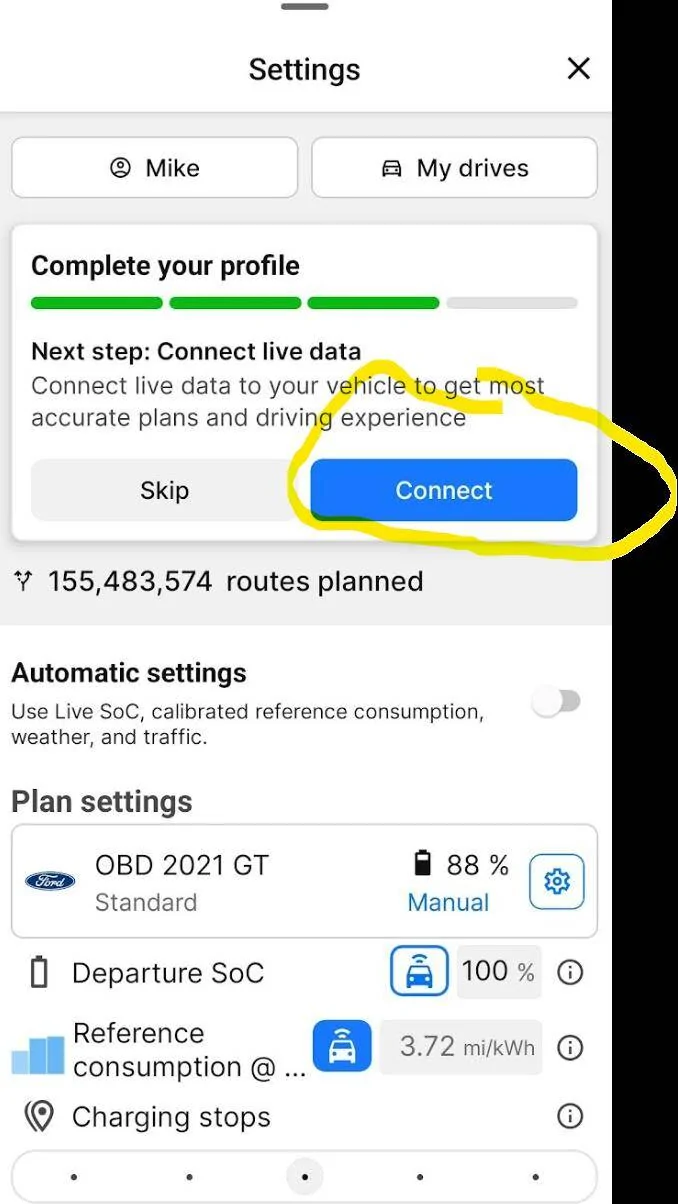

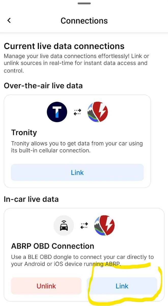

When you do would you also please provide a tutorial on getting your OBD reader to communicate with ABRP? Thanks.
It is not a tutorial, but I posted the results of using Tronity with ABRP here:
https://www.macheforum.com/site/threads/using-abrp-with-tronity-and-a-obdii-scanner.38458/
To get it to work, you need a BLE+ OBDII Scanner. The one I have is Veepeak, purchased here:
https://www.walmart.com/ip/Veepack-...ner/5343022151?classType=REGULAR&from=/search
It looks like it is out of stock, but all you need is a BLE+ scanner and I think ABRP will find it when you open the app and add a new connection.
