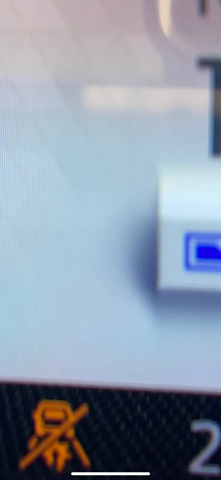

Unknown warning symbol appearing on dash

Glare could certainly do it. Bugs covering the radar might; bugs covering the camera would. Several possibilities.
I find condensation inside windscreen also does this and also knocks out other ADAS systems out until cleared.

I am pretty sure that means lane keeping assist is off because it can't properly detect the lane markings.
Its you collision assist and camera, are you getting the error going over bumps

It means for you to look in your rear-view mirror because you just ran over something :p
Nope it was on a dual carriageway, surface smooth ad baby's bottom
