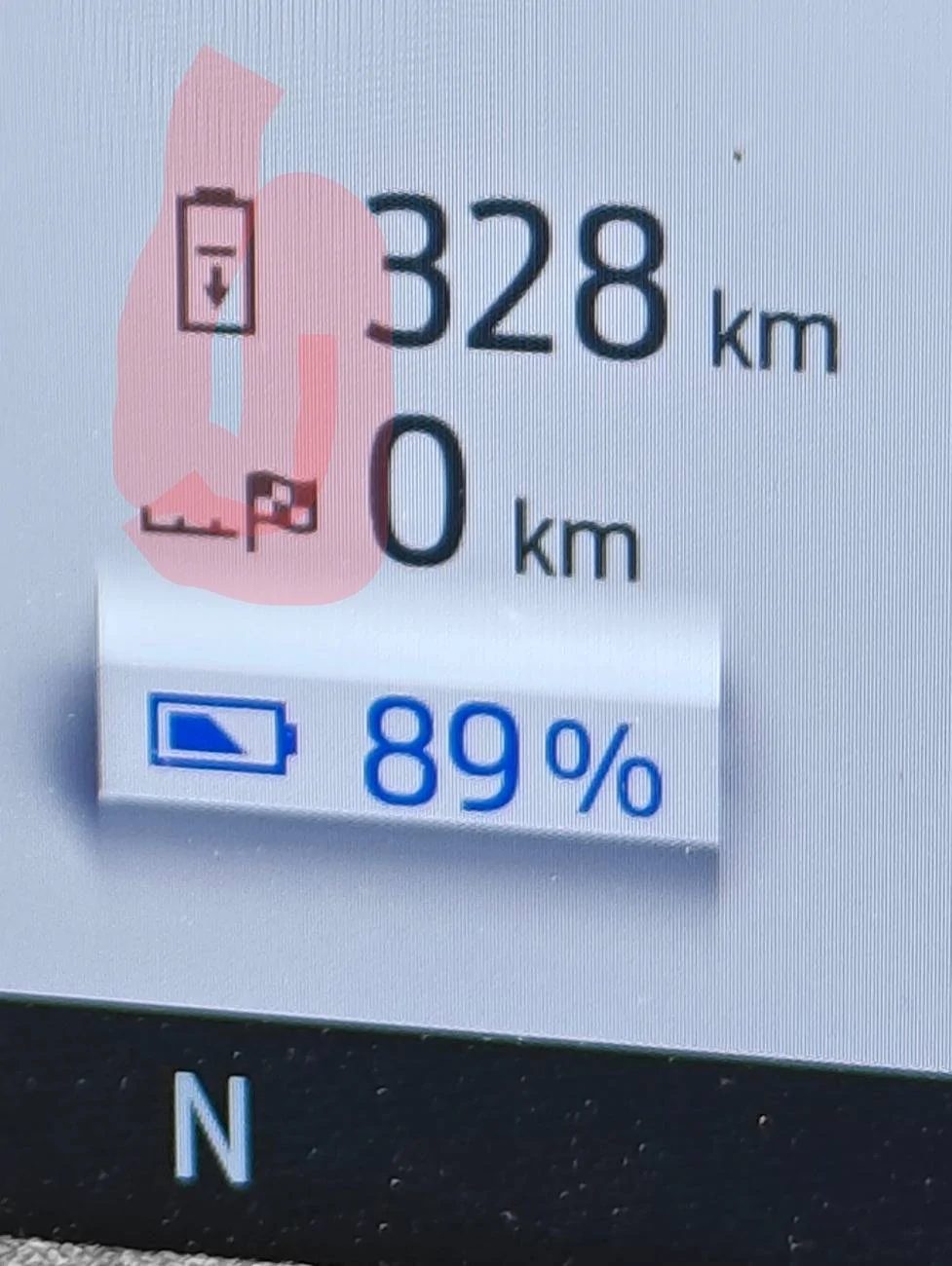

My mach-e was updated two nights ago, and I now have this emblem showing at the dashboard,, and I have no idea what it is. As well, for some reason I have a finish line flag also showing on the dashboard. Please see the picture for what I'm talking about.

Your Ford navigation is active and you're already at the programmed destination, so "finish line flag, 0 km" means "zero km to destination."
Just go into navigation, program a new route, then cancel that route. It'll go away.

I noticed in my car after it updated to 6.14, I would get the estimated range at destination and miles to destination display even when I was navigating with Google maps. I double-checked the Ford nav and nothing was routing there, I even set and removed a destination to be sure. Stopping navigation in Google maps and that display went away, adding a destination in Google maps and it came back, and the miles to destination followed the setting in Google maps.
I wonder if there is some slightly tighter integration between Google maps and the IPC in 6.14

What about the symbol that looks like a battery with a down arrow?

Yes
Don't have to go thru creating a new route and canceling.
Click the talk button on the steering wheel and ask to
"Cancel the route"
That should take care of it
