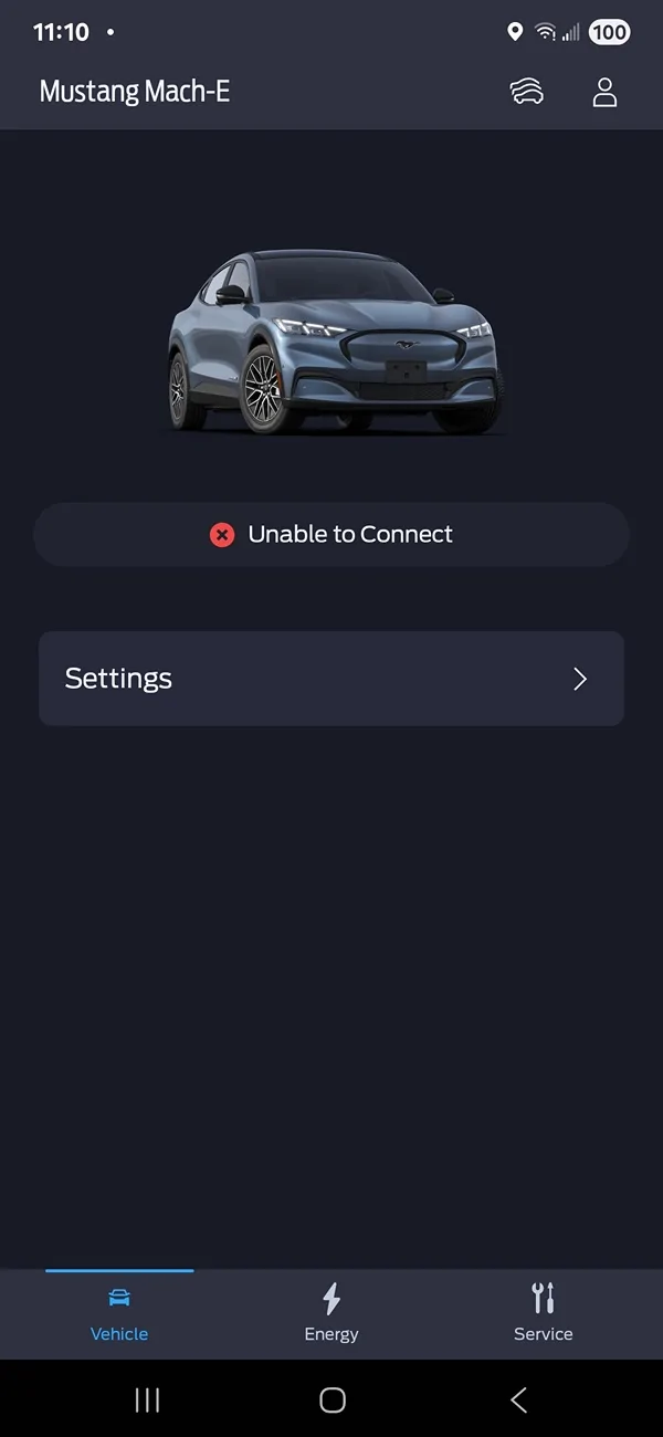

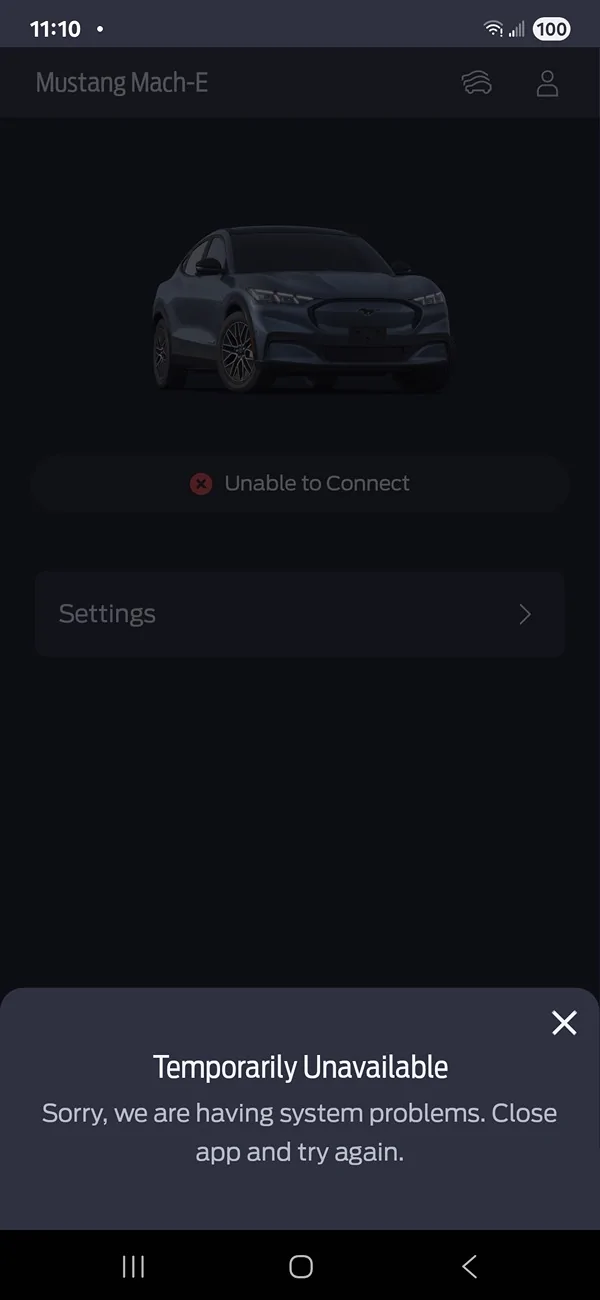

I use PaaK and have for months now. For the last 3 days, when I drive somewhere - anywhere - and try to lock my car using Ford Pass after exiting, I get a message that says 'Unable to connect' and the vehicle controls have disappeared. Instead it displays 'Settings' which, when selected, instead of going of Settings, displays the message 'Temporarily Unavailable - Sorry, we are having system problems. Close app and try again.'
Closing the app and trying again, even after multiple attempts, doesn't fix anything, I keep getting the same message. Ford Pass is basically useless at that point. However, when I walk away, the mirrors fold and I get the short horn honk and get a text from Ford Pass that the walk-away lock feature has been executed. At that point Ford Pass is back to normal and everything works fine.

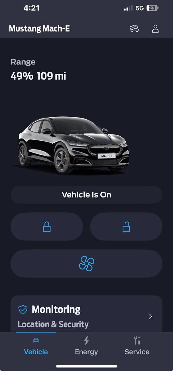

Mine does the same, mines iPhone 15 and it shows it on screen but just says it’s on all the time doesn’t update charge status or things it’s hit and miss if it works, as per picture car is locked and on charge but won’t update ?????
