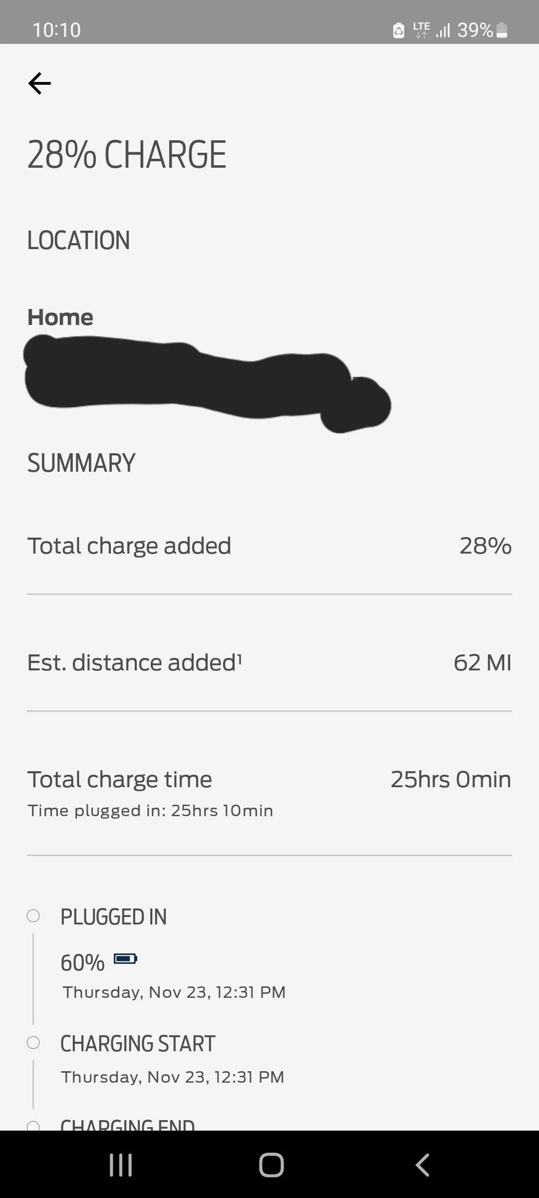

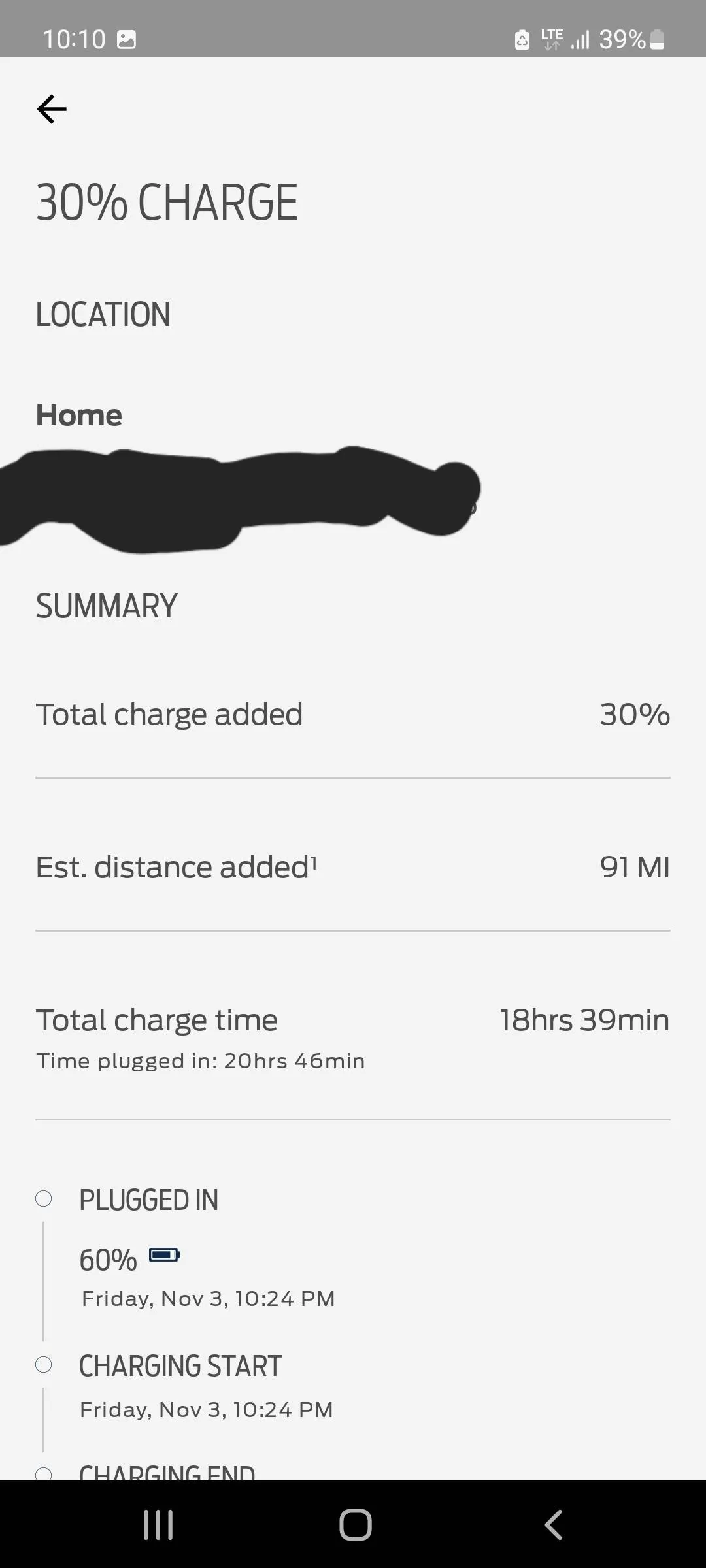

So early last week I got a few updates and since then I noticed significantly slower level 1 charging.
Also my estimated finish times are now always way off. The app is always showing a finish time of 2-4 hours from plug in time no matter how low the charge is.
Has anyone else experienced this? I've attached 2 before and after pics from the charge logs.
22 SR RWD. Oct 22 build. About 9k miles.

Thanks for the reply. The first photo is how fast it normally
charged since I bought it last November.
I've always used the Ford mobile charger.

Level 1 charging will only add about 1% per hour to the battery. The first photo doesn’t seem possible/accurate. The second photo does seem realistic to me.
Level 1 is limited to 12A or about 1 kW into the battery.
With an SR battery, it should add more like 1.5% per hour.
The 1st pic seems close to that.
2nd pic is about 1/2 that speed.

Oh whoops, I did calcs for extended range. Yes 1.5% per hour is expected for SR.
So OP, looks like your charge rate dropped from 12A to 8A. This could because the mobile charger is failing, or because the on-board charger detects an excessive voltage drop in your circuit.
Good to know, thanks!
