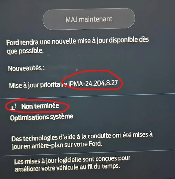

Hi guys,
while driving my MME informed me of a new update available. It didn't seems this update required to stop the vehicle, so I accepted it while driving.
The update process started and few minutes later I had to stop and park the MME. I didn't mind too much about the update in progress, but when I came back to the car, a message said the update was incomplete. It's been a week now and no change. I think the update failed and the update process is stuck.
Should I worry about his situation ?

Hi Kevin, I tried the reboot trick but this doesn't change anything. Thank you for the advise anyway.

Typically if it doesn't try again the next day in your schedule, it is because Ford pulled the update. Nothing you can do but wait for them to push it again.
Lots of updates are on hold right now.

"Update on hold always fix by themselves after a few days" the dealer told me, and he was right !
