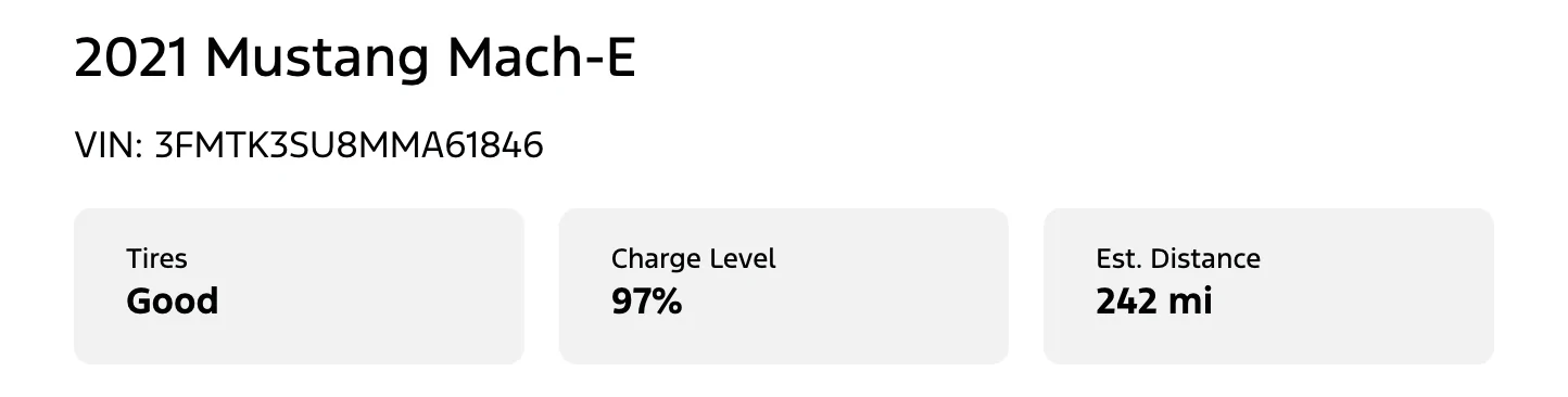

Ive gone through the failed OTA steps many times over past 7 months, and worked with fords OTA escalation team. The 12v isn't the issue. Its consistently charged up, but ive done all the long drive/long charge strategies just out of frustration.
Ford Mustang Mach-E Updates stuck and dealer wont help Screenshot 2024-03-14 at 9.31.40 AM
