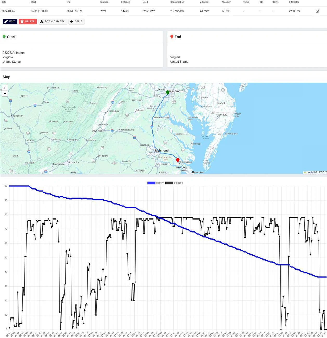

I did a couple trips to compare the results of using ABRP with live data from both Tronity and when connected to the OBDII scanner. As you would expect, the direction connection to the car via the OBDII scanner worked best. But if you don’t have that available, the Tronity connection works.
ABRP does a good job predicting the charge at destination. Here is how it did with Tronity:
Ford Mustang Mach-E Using ABRP with Tronity and a OBDII Scanner 4U1oCBP78xphjL8uetcfO4Q?key=2-RpfmxFB1dhtu3AXJ4Rz

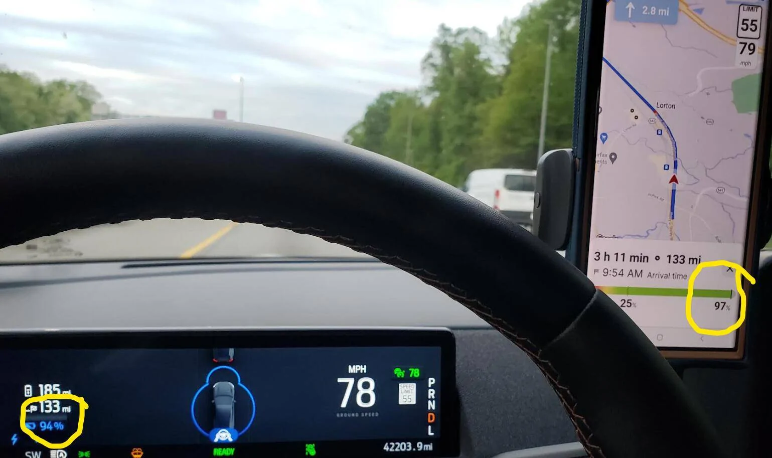

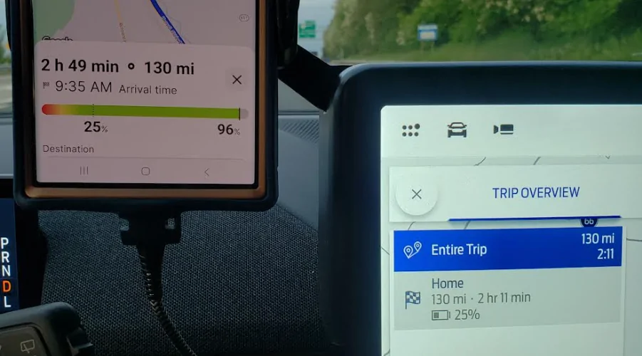

You can see when I started the trip, ABRP was predicting I would arrive with 35% charge remaining. The Ford navigation was predicting 26%. But after driving a little farther, ABRP adjusted the prediction down. Maybe because I was driving faster than expected? Maybe because it was routing me off the highway to avoid traffic:
Ford Mustang Mach-E Using ABRP with Tronity and a OBDII Scanner y5lenE3jnVRLcC069QGgi-U?key=2-RpfmxFB1dhtu3AXJ4Rz

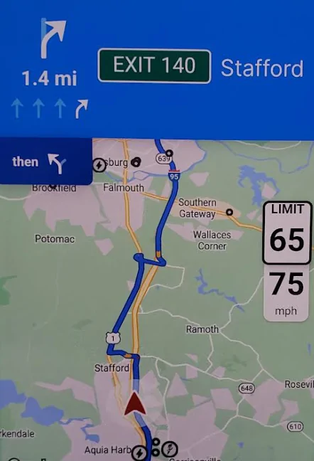

Google Maps didn’t recommend I do that. The Ford nav didn’t recommend I do that. Why did ABRP? I think because of delayed traffic information that was more up to date with the other navigation tools. I didn’t get off the highway and it was fine. Some traffic, but not horrible and not worth getting off the Interstate.
Ford Mustang Mach-E Using ABRP with Tronity and a OBDII Scanner A7WG3Yoho4zD6SvGNzCJZrH?key=2-RpfmxFB1dhtu3AXJ4Rz
In reality, the original ABRP prediction was the most accurate, and more accurate than the Ford prediction. I arrived at home with 36.5% charge remaining. From Tronity:

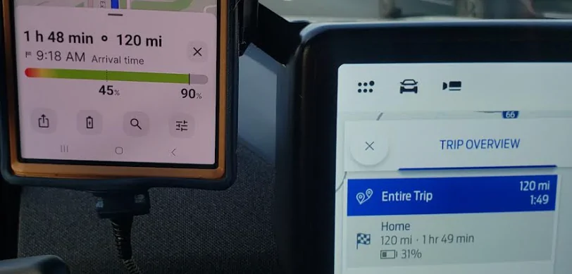

With the OBDII scanner, there is no delay. ABRP behaved the same way, making the best prediction at the very start of the trip, and adjusting as I drove. With the OBDII test, ABRP predicted 40% SoC at arrival. As I drove, the prediction actually went up. I guess because of heavier traffic? IDK. But it was much higher than the Ford prediction:
Ford Mustang Mach-E Using ABRP with Tronity and a OBDII Scanner KbBZdK38aTNLywBFzB-XM-y?key=2-RpfmxFB1dhtu3AXJ4Rz
I don’t think this has anything to do with the live data connection. This is just ABRP behavior.
45% SoC predicted by ABRP was too high. 31% SoC predicted by Ford was too low. I arrived with 42.5% SoC remaining.

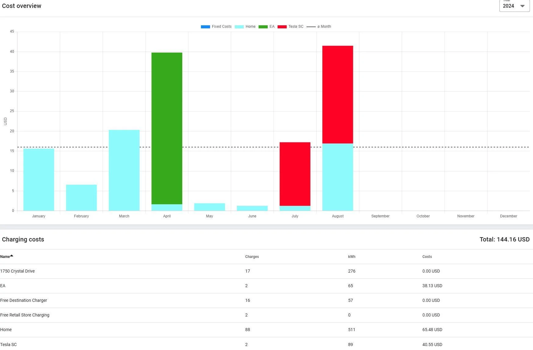

Tronity is a great tool, BTW. I finally have all the data coming in accurately and I have good data going back to January when they turned their Ford interface back on. This isn’t really the point of this thread, but here is my cost history so far this year:
Ford Mustang Mach-E Using ABRP with Tronity and a OBDII Scanner 1725283869840-lx
