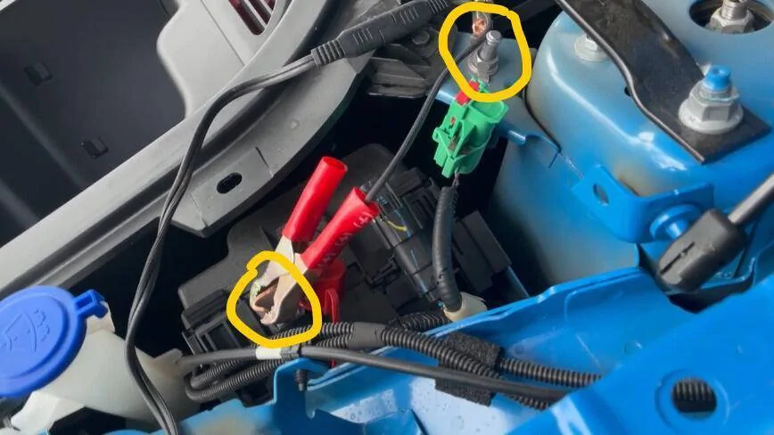

1. The battery maintainer should be attached to the POSITIVE end and the NEGATIVE grounding post (not to the battery (-) terminal itself) (attached below is a photo I found on this forum, not my car)
2. I can use the clamp of the CTEK battery maintainer - no need to use the loop version --> has anyone had experience with this? Are the clamps pretty secure that they will stay on? If the loop thing is recommended, how do I attach them (I've not seen photos for these on the forum).

Hello~ I'm going on an extended trip (> 30 days), and after reading through various posts, I got myself a CTEK Battery Maintainer to hook it up to my 12V battery. Just want to clarify some things, and if anyone has experience with this, please let me know your experience.

If you use loops, you can simply attach them to the same place where the standard clips are attached, using a screw if possible, or through plastic connection clips.
