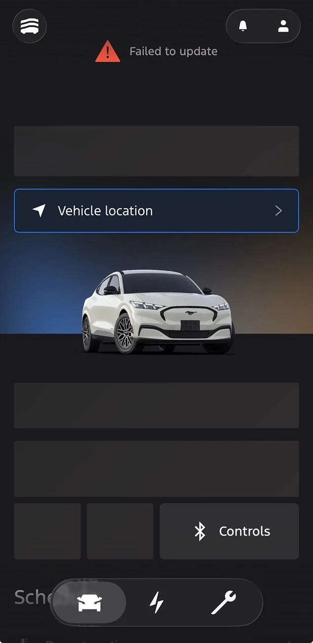

This morning the car was sitting in my driveway and I got two notifications from FordPass as well as two emails at the same time. One says that a master reset had been performed on the vehicle and the other says that my PAAK access (and door cord and backup start password) was removed.
I checked my App and the vehicle wasn't there, nor was it in my ford.com account. I changed my Ford.com password, just to be safe. When I called Ford they have no clue why this happened. In fact, they said a master reset can't happen without initiating it from within the car. It's bean two weeks since my last software update, so I doubt it's related to that. Super weird.
Luckily, I was just at home, but I use PAAK all the time. This definitely would've stranded me if I was out and about.

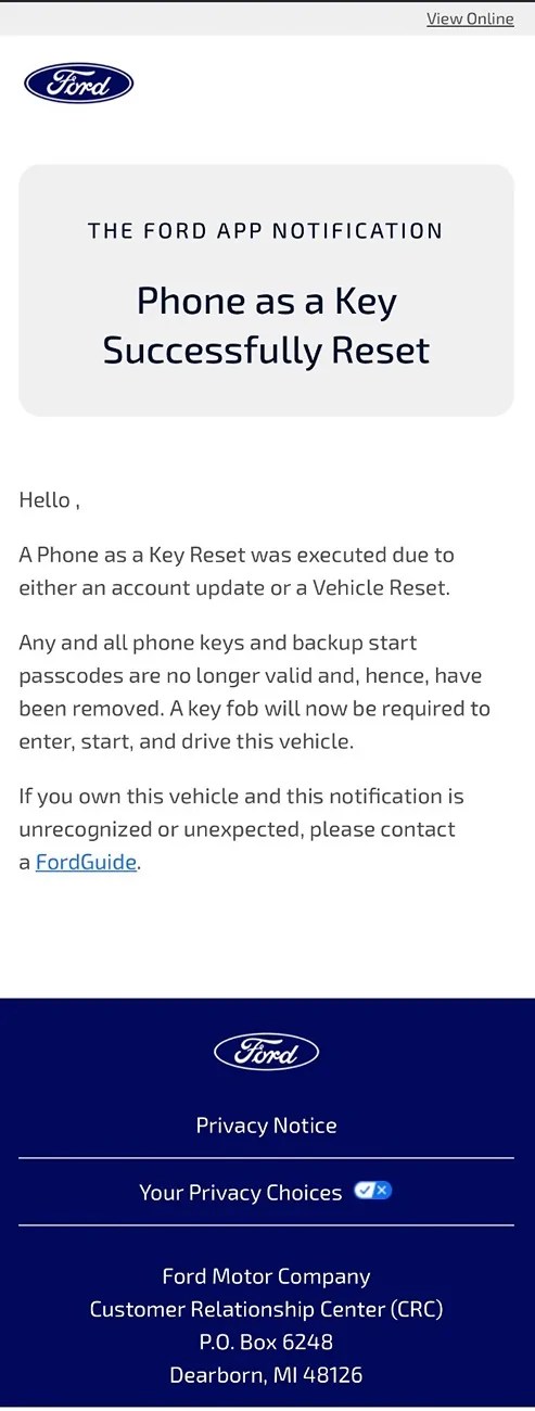

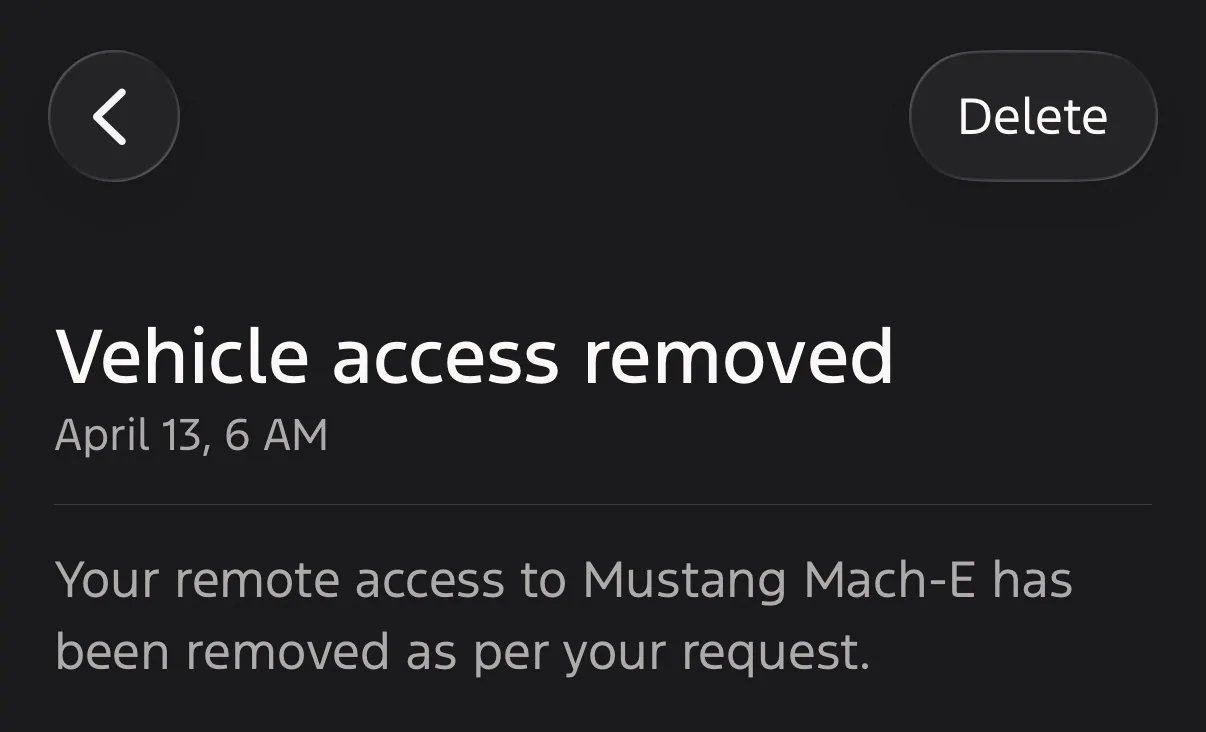

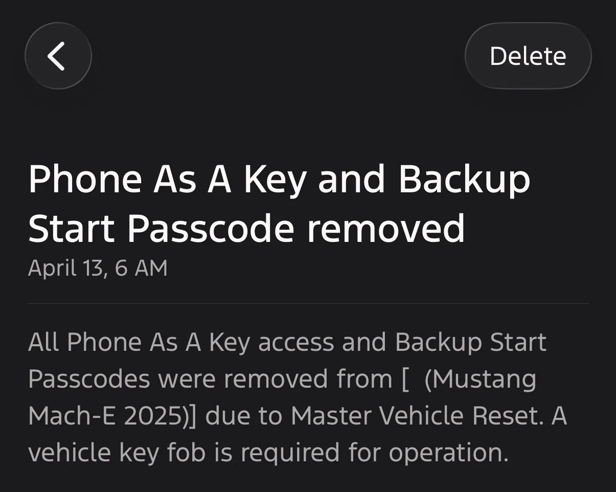

At 6:00am today it happened again. I received two emails and two FordPass notifications that my vehicle had a master reset and PAAK and all backup passcodes associated with my PAAK stopped working.
Last week when this happened I sent Brian from Ford my VIN in less than an hour from him asking for it. I also called and talked to Ford BEV team who was supposed to call me back that day. Neither one reached back out to me. Super frustrating.

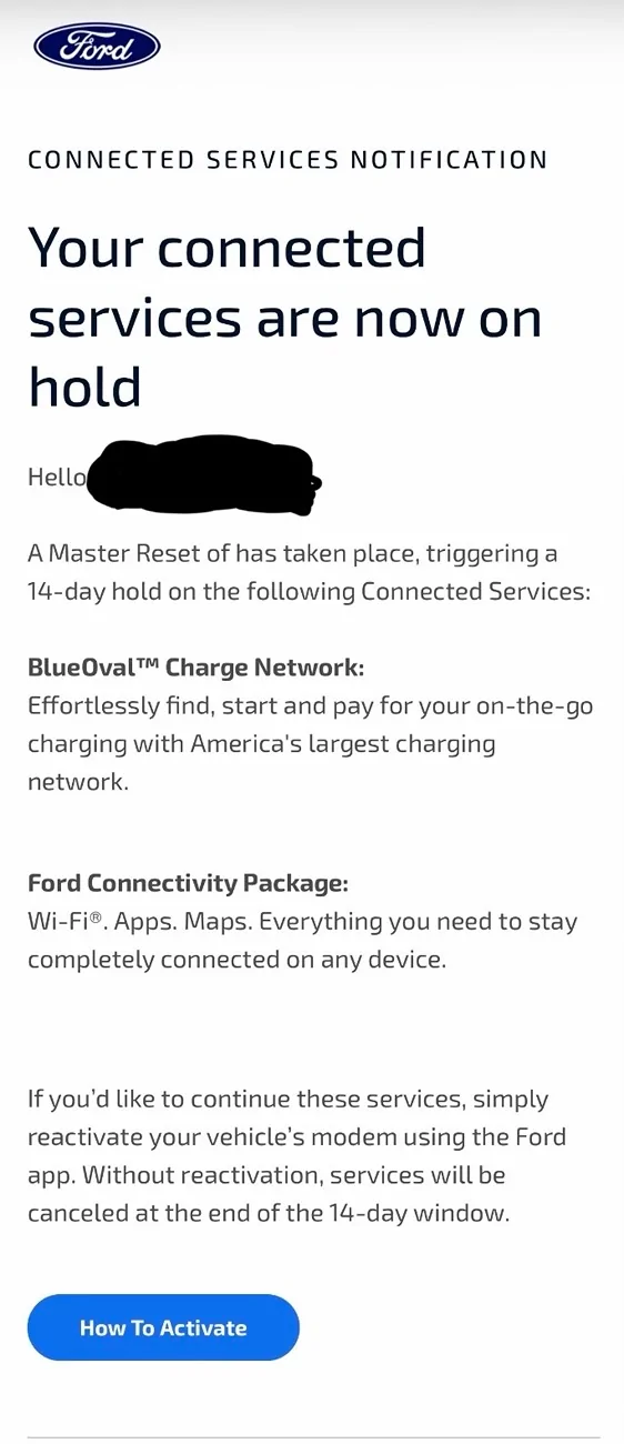

Oddly they only know my name in one of the emails.

Subject - A Master Reset has deactivated your vehicle's modem
