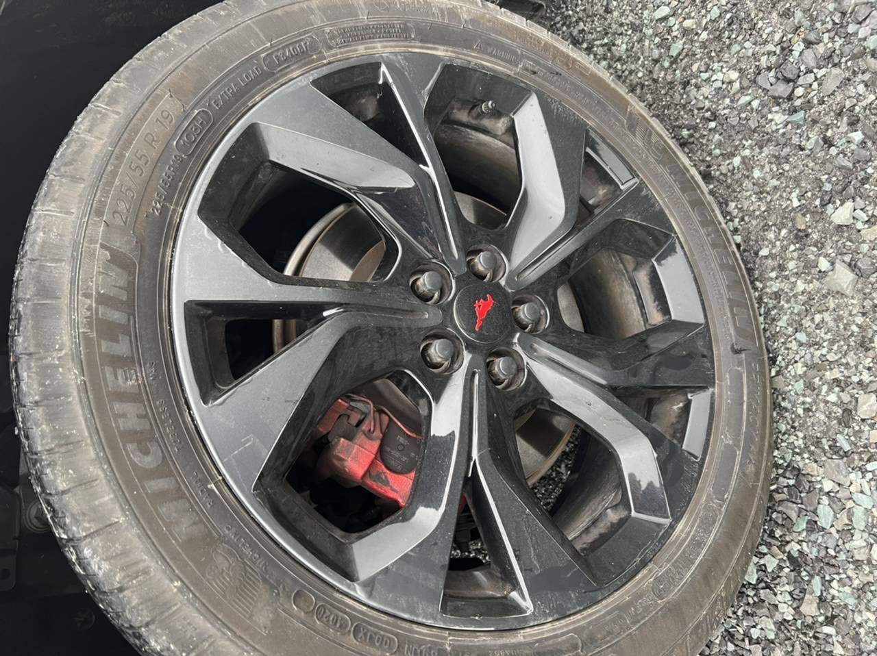

Thanks for checking in @mkhuffman. I ran out here at work to snap a couple photos for you.
Overall, for the $30, I’m pretty happy with how it’s holding up. The wheels still look really good if you don’t look too closely. Pardon the dirty as it was a rainy drive in to work this morning.
Ford Mustang Mach-E Vinyl blackout for OEM wheels. 4205EF9A-A0C6-4B4D-9055-30D5DAB3299A

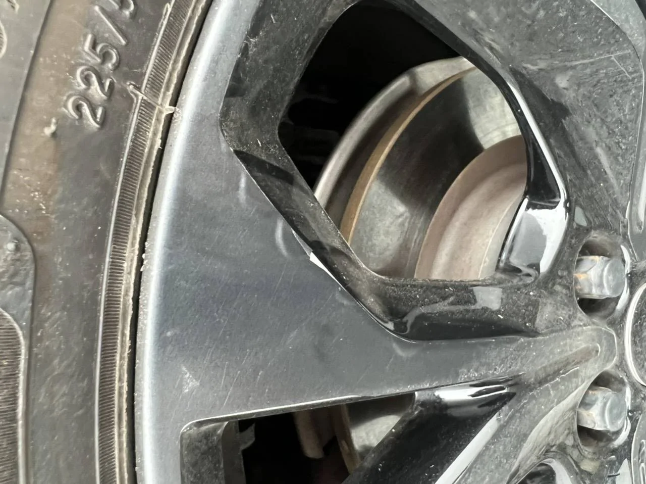

That being said, the vinyl is starting to peel in a couple of spots. Some of this is undoubtedly my fault as this was the first time I had laid vinyl on wheels. I probably didn’t have the wheels clean enough. I know I didn’t heat and stretch the vinyl enough when I laid it (I’ve since learned a little more about working with Vinyl). AND most importantly, due to time constraints and general laziness, I’ve taken it to a no touch high pressure care wash a couple times that really blasted the hell out of the wheels and forced some water under the edge where I didn’t have the best adherence.
Ford Mustang Mach-E Vinyl blackout for OEM wheels. 9B7760A4-A96F-44B2-A01C-702663E6F2C5
These little bubbles here I can now feel sand under. So it will start to peel worse before too long.
However, I’ve gotten 6 months out of it so far. For $30 in vinyl…. Im thrilled with the results. I’ll redo these again when it gets a little worse. I’ll do a better job as I’m now more experienced. I won’t be going back to that ridiculously high pressure no touch and I’m sure my redo will last even longer and look even better. If I have to redo the $30 job annually, I consider that being way ahead versus $600 to powder coat. (Though I’m also considering trying a plastidip coating on them).
