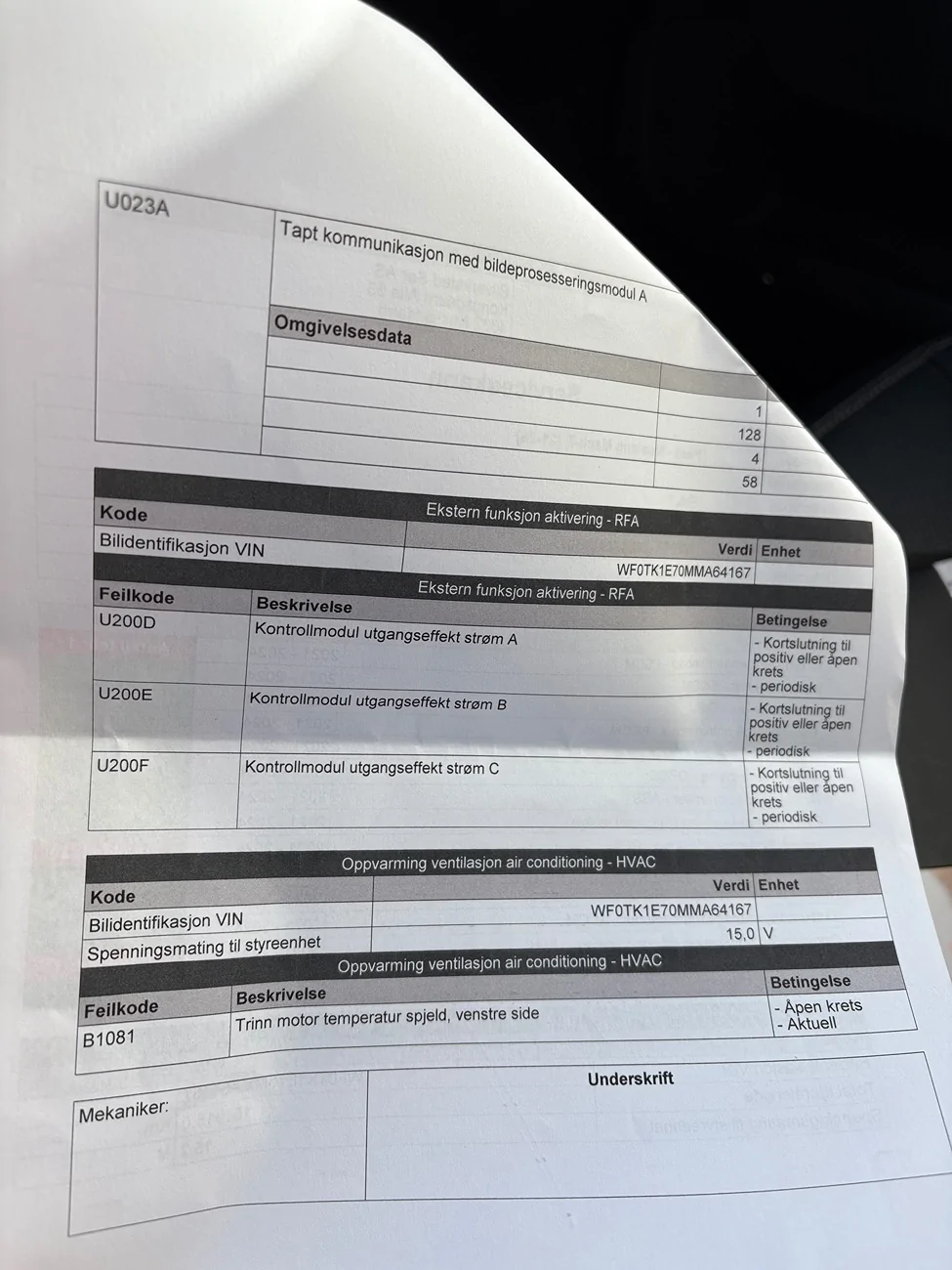

Did a service of my car in a non-ford place and changing 12V battery (a lot of money saved while still valid in terms of warranty), and got these fault codes back. While it is Norwegian, maybe some of you know what they mean? And can they somehow be related to my heating issues? Bonus: are these costly?

While I don’t know if these codes are active or not, I did find what they are with a simple web search. U200* codes are related to the Remote Function Actuator (RFA) module. Someone with more knowledge may pop in with helpful info, but these may have been triggered by the 12v replacement.
